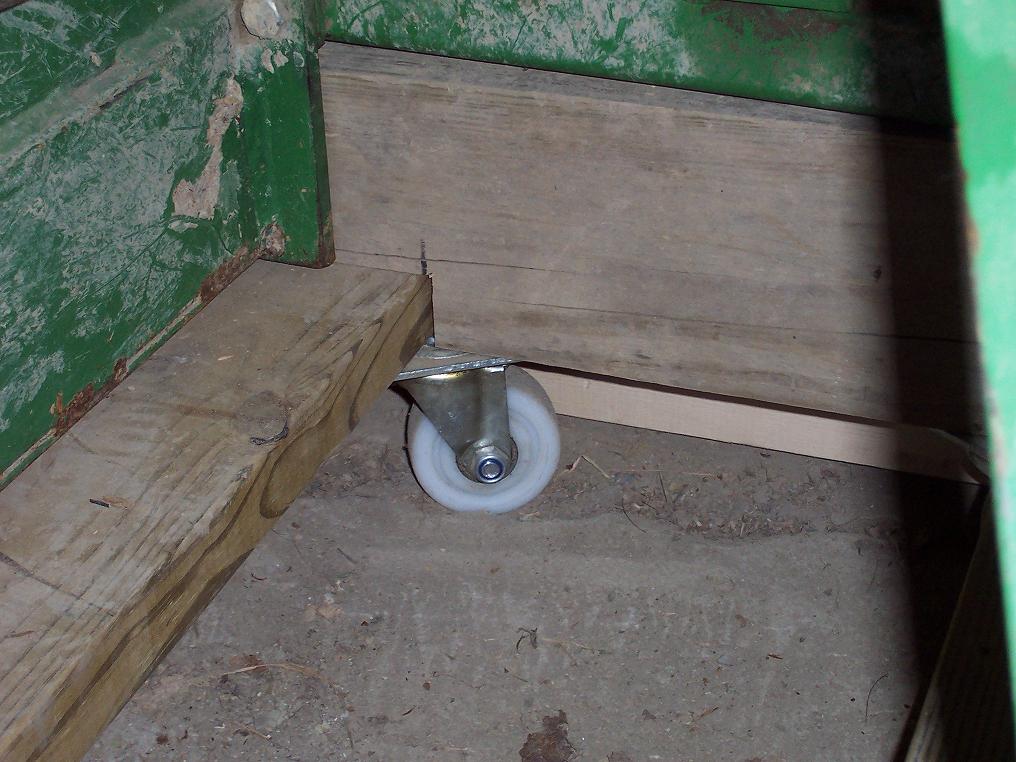

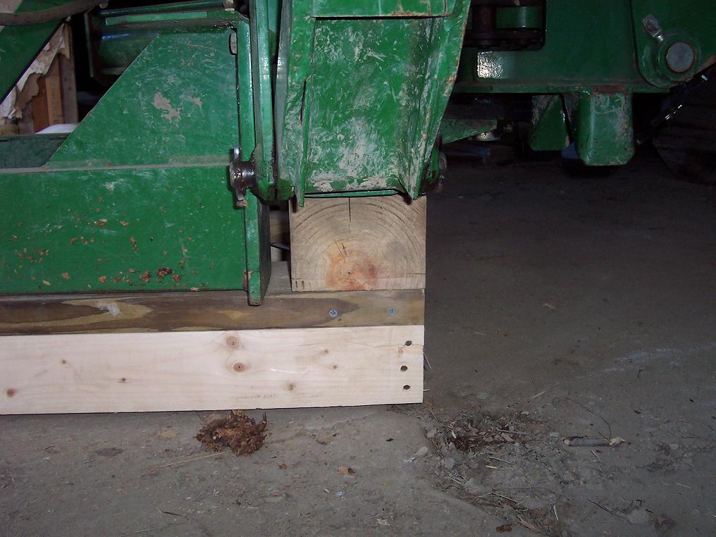

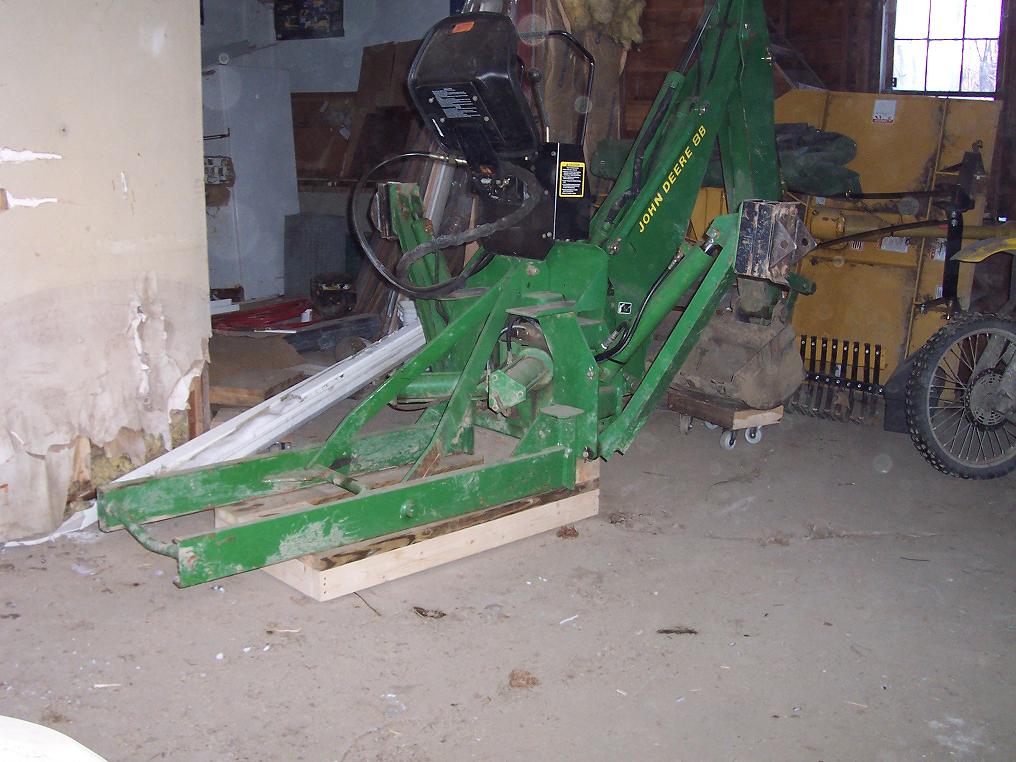

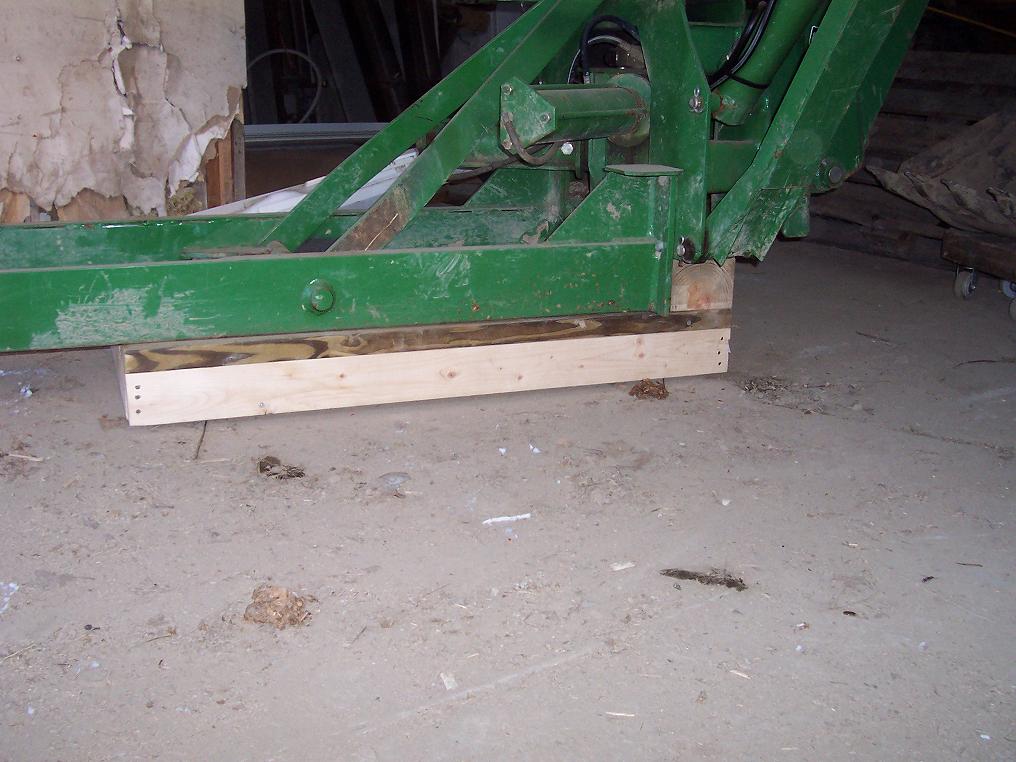

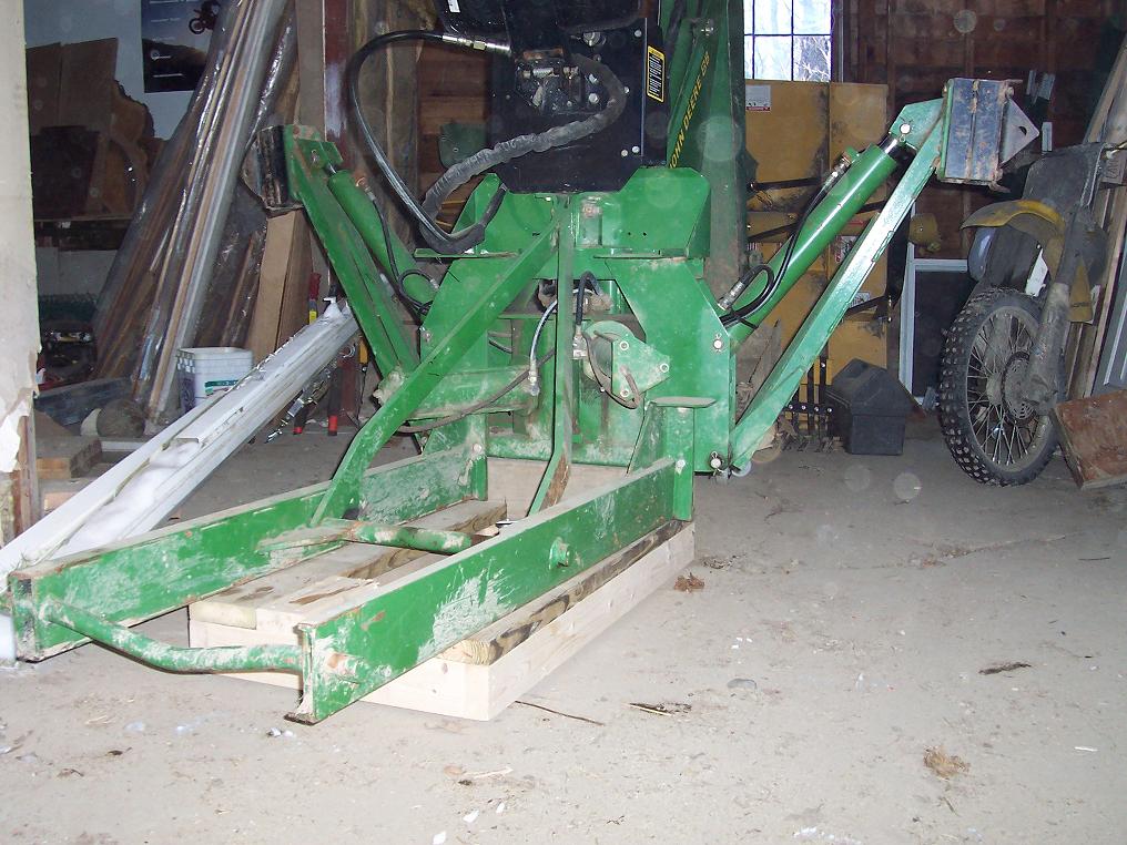

The first time I removed mine, I went play by play from the manual. It came off nice. Take your time, read over the instructions, and then follow them. I am as new to this as can get. I built a small stand for my backhoe, which I am going to try out tonight.

Dont want to take over your thread, but my stand worked out perfect. I will post some pics, but I was busy back blading 8" of snow. Only 2 more feet to go today.

Hey guys here are those pics as promised. It came off so easy. It should go on the same, but been too busy with snow removal w/ back blade. It moves around better than I thought, even with the small casters, and brken concrete floor.
