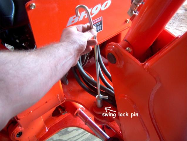

When I first started looking for a tractor last year I found out from TBN that the manufactures make backhoes for their tractors. However, most dealers did not have one in stock and only one dealer offered me a "try before you buy" hands on demonstration. One of the questions I had was how easy is it to get on and off? So when I started taking the backhoe off today I grabbed my camera and owners manual and . . . .
The engine should be at speed idle and on a flat level hard surface preferably concrete or on boards if the ground is soft.

1. Set the swing lock pin to prevent the pivoting of the boom before removing the backhoe.

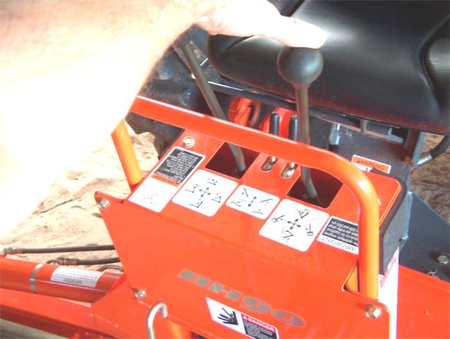

10. Slowly release all hydraulic pressure by moving the backhoe hydraulic control levers in all directions.

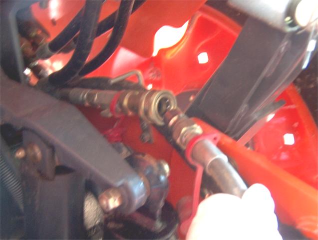

11. Disconnect hydraulic hoses on the following manner: (1.) Disconnect the inlet and outlet from the tractor. (2.) Connect tractor's outlet hose to the coupler of return hose.

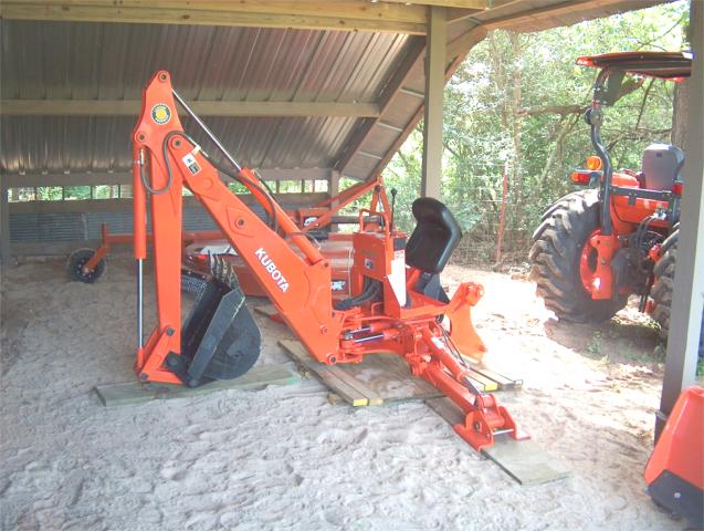

12. Restart the engine. Then drive the tractor/loader slowly away from the backhoe.
13. Shut off the engine and remove the key from the tractor. Set the parking brake.
Apply a coat of grease to all exposed cylinder rods to prevent rusting. When storing backhoe, install the dust caps onto the backhoe's hydraulic nipples to prevent contamination.
