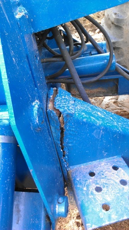

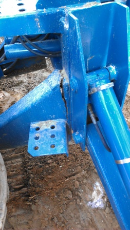

I just bought a 2000 Ford 2120 with backhoe.
When I used it Saturday some welds broke on the mounts. These appear to be the only connecting parts between the tractor and backhoe. Is there something missing, or if not, is this a common failure, and what is the suggested repair?

The failed area looks as if it had been repaired previously, maybe more than once. I'd try to find a frame mounting system that places less stress on these welds. I doubt a reweld will last.
How do you like the 2120 otherwise? Love mine, but have no backhoe to sour things.

Also take a real close look where the top link attaches to the tractor. That area might have taken added stress when the welds you show failed. Here's hoping no cracks appear.
There are many threads on TBN about frame-mounted vs. 3-point mount hoes.

That installation does not use a top link, and you should not install one. That is not a common failure and must have been completely overstressed when it happened the first time. The initial repair was of poor design and execution. A quality welding job including well-thought-out gusseting and plating is all that is needed.

Did you connect the outer top link? All subframe mounts (as far as I know) have three points of connection to the tractor, the two lower frame connections you've photographed as failed, and the outer top link (the upper connection on a three point hitch).

Just a follow-up, I had it welded this past weekend, and it was pointed out to me that it is missing a 3rd link, which may have prevented the failure. The welder is going to source a 3rd link for me as well. (Jedjoe was right!)

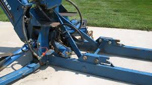

May be going out on a limb , but in looking at images of a 2120 , w/o looking up specs , seems to be at least as big as my TC 30 . With a 757C B.H. sub-frame mount on my TC 30 , It does require a 3'rd link , a.k.a. Top link to be used . A model number though like Rick suggested would be nice .

Wish op would provide some sort of B.H. model or maybe even a picture from farther back , thus a better view . That big a tractor , would think that it is either sub-frame mount or 3 point , both likely needing a top link or at least a 3rd anchor point ?????
Fred H.
In this picture , Assuming it is a 758b model ( says it is ?? ) , although not the " top Link " connection , there are still the " 3rd " arms coming from sub-frame up under seat area thus tying the B.H. more together .
Couple of other pictures , second is were you would ' Find " info on type of B.H. , if it is still attached .
