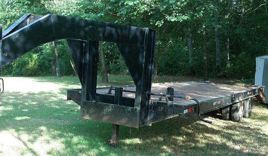

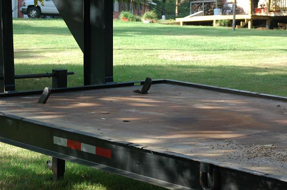

One of my trailers is a gooseneck 20+4 dual axle w/ single wheels. The gooseneck puts several hundred pounds in the truck bed just hooking up. My rule of thumb is when loading I park it on the trailer when I get about a 2" drop of the trucks bumper. I see from your pics the previous owner installed stops through the deck. That probably works great for a tractor w/ loader. Based on the pic thats about the same spot I load my tractor up to. A dozer will be a lot heavier than a tractor and may require a further setback so more weight is over the trailer wheels.
/ Backhoe loading advice #22
George's advice is pretty much what I would say. Before loading lower the jack till it is 3 inches off the ground then load and mark the spot on trailer where the front bucket is when the jack just clears the ground. All things being equal it will pull the same every time you load it if you load it in the same spot everytime. HTH,later, Nat

Here is a picture of my trailer. When I bought it the guy said he had installed the up-right 'stops' through the deck. He said he hauled a dozer and used the 'stops' to mark his 'balanced' position.
Could I get a couple of comments on load balancing? How much weight should be on a truck?
Thanks,
Trey
Well, the first thing you need to tell us is what truck you have, what its' GCWR is, what the hitch capacity on your truck is and what the tongue weight or PIN weight is.
Your trailer is a 5th wheel or gooseneck, right? Let's say it's a 10 ton trailer or 20,000lbs. If your backhoe weighs 14,000lbs and your trailer is less than 6,000 lbs empty, then you're OK since your trailer total weight is under 20,000 lbs.
Next, check your truck. What truck is it? What is the GCWR? Let's say it's 30,000lbs. If your trailer is 20,000 lbs loaded, then the truck would have to weigh 10,000lbs or less to be legal.
The way a 5th wheel works is just like weight in the bed of the truck. If your maximum weight in the bed is 4,000lbs, then that's your maximum 5th wheel weight. If it's a rear mounted pintle hitch, then you're limited by the capacity of the truck or the hitch, whichever is lower.
USUALLY, the rule of thumb is that the tongue weight, or Pin weight is 15-20% of the total loaded trailer weight. So if you have a 20,000lb trailer, max tongue weight would be ~4,000lbs. If you have your machine too far forward, it will be overloaded for tongue weight. If it's too far backward, it will cause a loss of control to the rear tires since they'll be pulled up off the ground by an *** loaded trailer.
Best thing to do is to get all the facts then bring them here. You'll need a class A CDL to pull that trailer & backhoe for sure.
