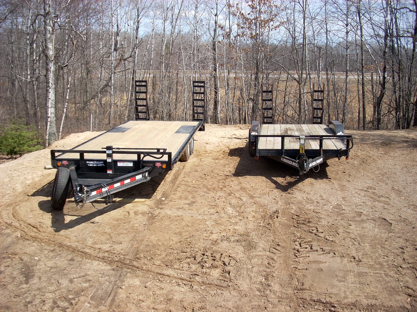

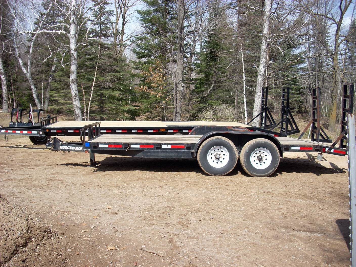

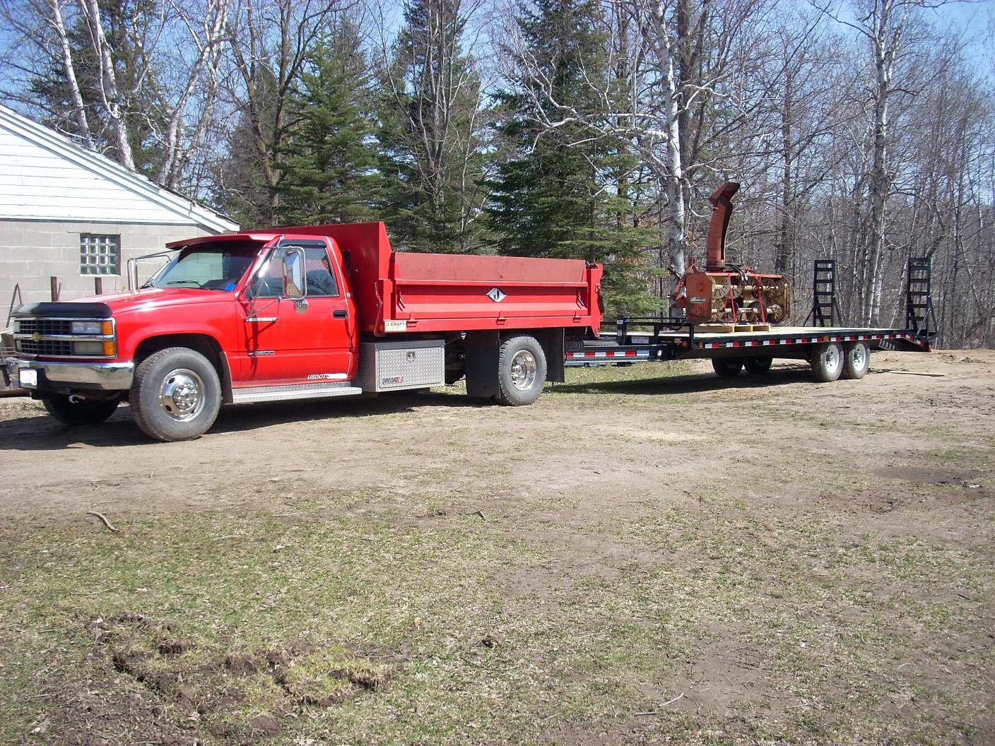

I had a 7x18, backed the bh on put the bucket teeth on the 2x8 across the A frame. Kept it from hitting the tailgate on a turn. In order to fit it the front bucket was outside the rear standup ramps. This took tongue weight off & cause mild fish tailing over say 60 mph. not a problem as I usually tow at 50-55 mph and my tow vehicle is a 1 ton diesel dually dump with 9K empty weight. 12K trailer, tractor is 7K so no where near weight limits just didn't fit well.
New trailer is 8x24 deckover: positioning forward, backward is no big deal.
