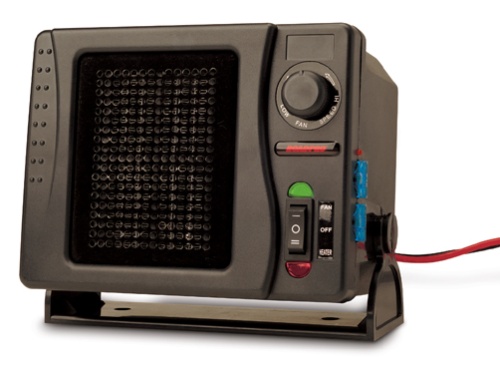

Hi George, I have a Mahindra 2516, bought new in 08, I`m also looking to buy a BH with a sub frame. This past Fall I bought a soft cab like yours, but no Heater. Where did you get yours? Hope to chat again....
/ backhoe for mahindra 2615 #9
Paul , if any luck on your BH Let me know , I`m also looking for my Mahindra 2516
/ backhoe for mahindra 2615 #10
I bought the heater from a seller on Ebay but a lot of RV stores sell it too. It's a 12V 300W ceramic heater model RPSL-681. and sells for about $40 plus shipping. (I paid around $52 shipped to my door).
I wired it direct to the battery but installed a heavy duty toggle switch shut off in the hot lead. Do a net search for a RoadPro RPSL-681 and you should get a bunch of places that sell it.
Without the cab and heater my fingers would get cold even with gloves on. Now with the cab / heater I don't even need the gloves and the heater keeps the windshield clear.
The cab I bought from RJPartsco.com
Its for a 2816 but the 2816,2615, and 3015 all have the same body style.
