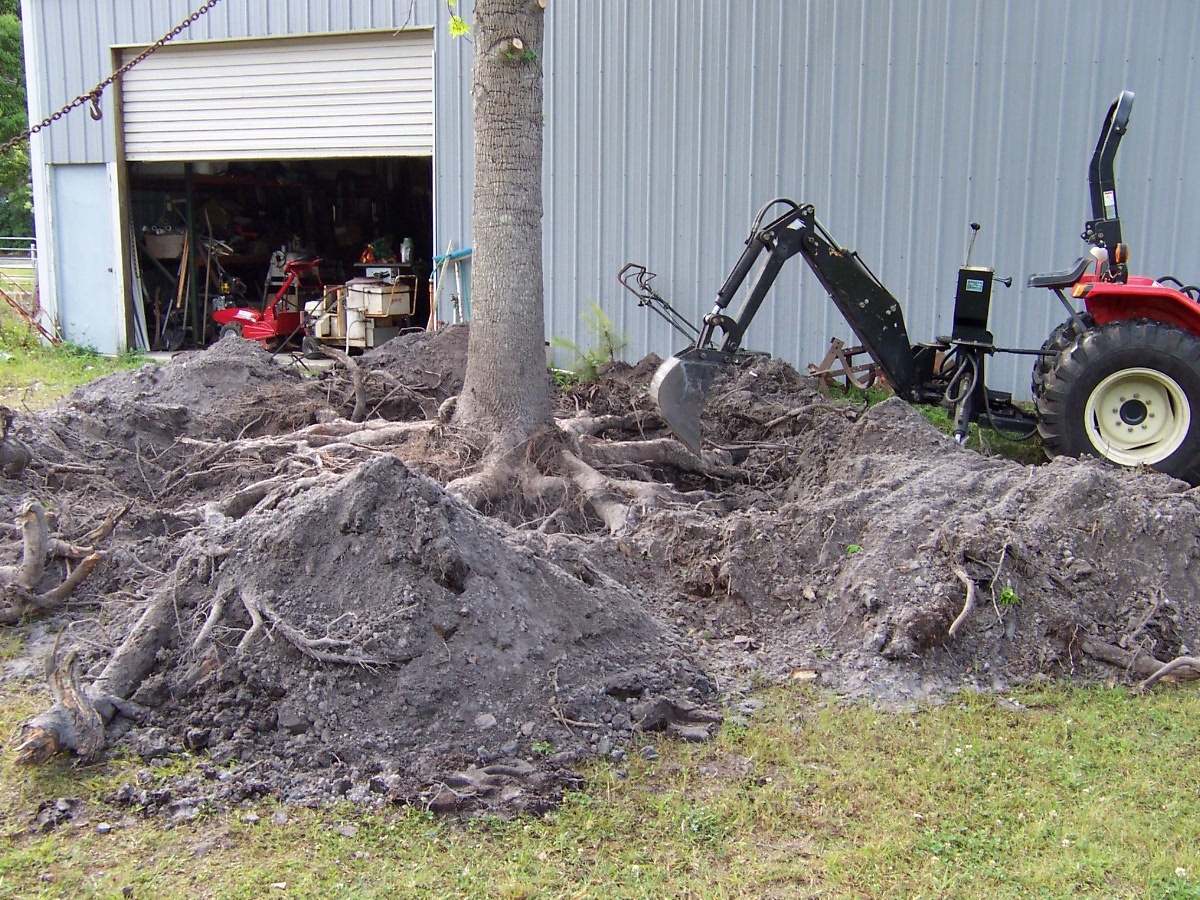

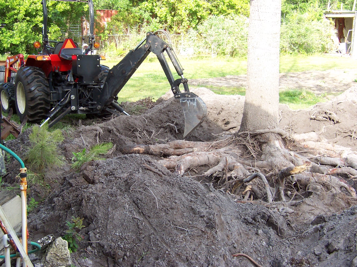

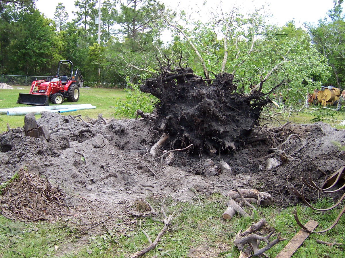

I bought a new/old stock Jinma Hoe on on ebay and modified the sub-frame to fit my 05 3510.
I paid less than $2800. including shipping and it has paid for itself on the first job, replacing a drain field.
The Jinma is not the best but it gets the job done.
I made a 6" wide bucket for it and it is very handy for stump removal and water/electric lines.
This one is a pain to hook up sometimes trying to get the sub frame lined up using the hydraulics.
Pics are taking down a tree that was dying digging up the roots and pulling it over.
