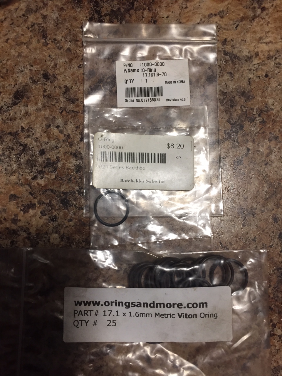

Thanks to the info from JoelD I think my valve is back in service, at least no apparent leak on top side. May be a drip on bottom, not sure.
I used these
Apparently the white orings don’t last even if ‘new’ the ones i put in last week were mush already.
Wish I had replacements for the nylon washers.
BTW, I was able to replace these orings without dismounting the complete valve. Just loosened the 4 mounting bolts and worked it right on n the hoe.

The bottom uses the same size o-rings and white nylon backup washers. It looks like a copy of the top other than the centering spring it attached to the end of the spool. The caps on the bottom don't seal the fluid. They just house the centering spring. You may want to take off the entire valve assembly for these because it would be much easier than trying to do it all upside down.
/ Backhoe Control Valve #28
....................You may want to take off the entire valve assembly for these because it would be much easier than trying to do it all upside down.
X2.........do it once, do it right;)

Thank you for posting which o-rings you used. I was hunting for some because I think I'm on borrowed time. The bottom o-rings won't be to bad other than taking the valve assembly off the frame and all the hoses. I marked mine because they can easily get mixed up. Be careful when removing and installing the screw that holds the centering springs on. If I remember right, they are little 5mm screws. Mine came out pretty easy but don't torque them down to tight. They're similar to the ones holding the centering spring caps on.
/ Backhoe Control Valve #32
Yes for me bottom was same white o-rings and white sweeper washers. I’ve reused the nylon washers without issue. Agee the stock white o-rings are junk. Not sure why. Glad it looks like you’ve found an alternative source for o-rings. I guaranty the stock o-rings on bottoms are all mucked up. Good luck. Ps I used a piece wood as a lever under the valve body to pry it up as I installed it so I could line up the holes to bolt it back into the frame. Valve body is very heavy. I’d say around 50# give or take.

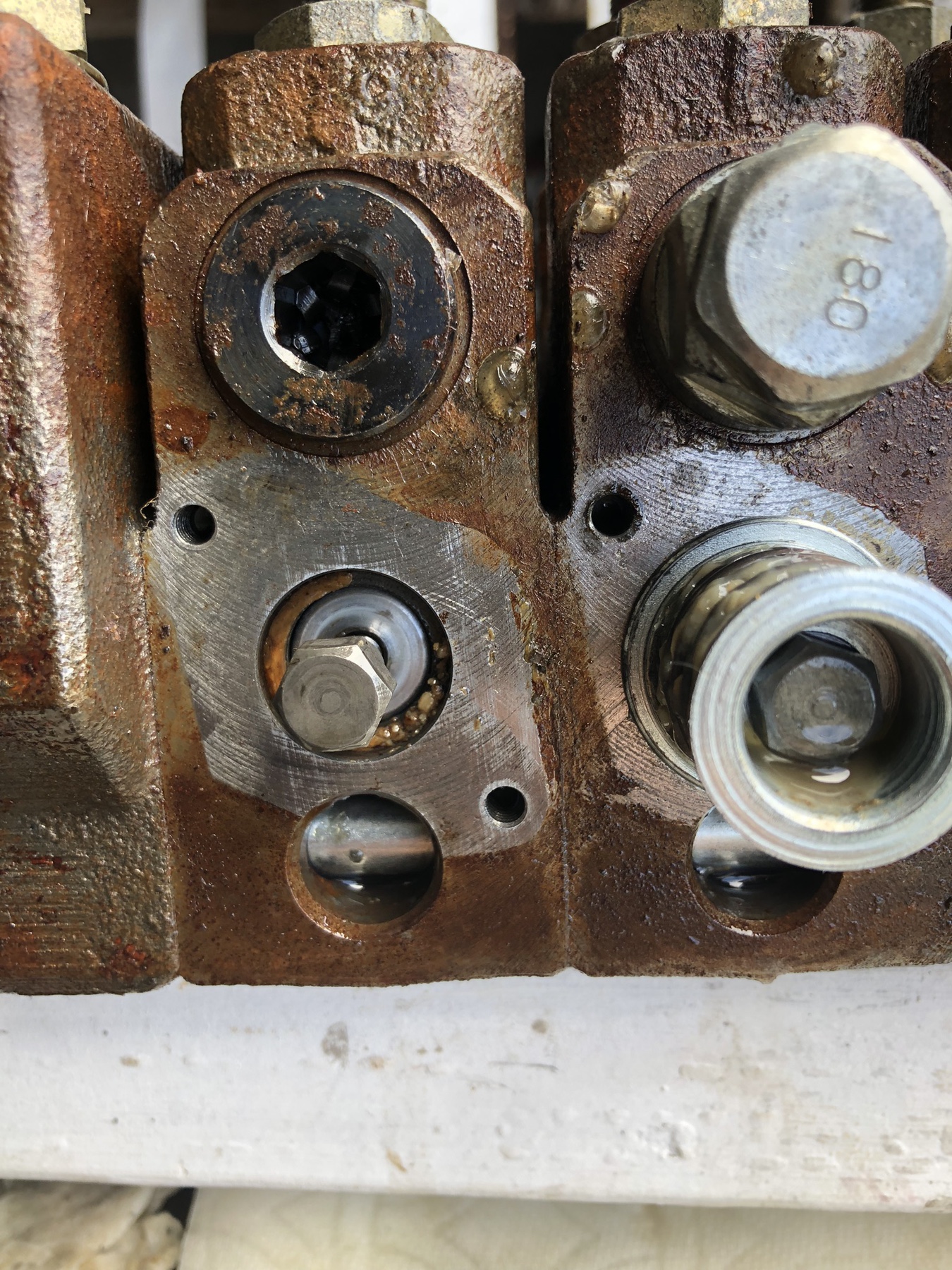

Finally got opportunity to work on valve. Changed out the lower O rings.
They all looked like this or worse. These are the urethane rings.
I was careful and was able to reuse the nylon washers.
Anyone who has done this, is this it or do I need to replace something else?
Didn’t get chance to remount and test, maybe tomorrow.
/ Backhoe Control Valve #40
The o-ring is the only seal with the nylon washer to back up the o-ring and possibly work as a debris wiper for the spool shaft. When I had to work on mine, I had top and bottom both apart and was able to remove the spool and check for any scaring that may tear up the o-ring. I would've polished with 1000 or higher sandpaper but wasn't needed. Your valve blocks have some rust on the outside. I sprayed mine down with fluid film which has worked well. Not sure why they used the urethane washers when they're not made for this type of application. You should be good to go with the black rubber o-rings. I'm still looking for the nylon washers. I found everything but the right ones.
