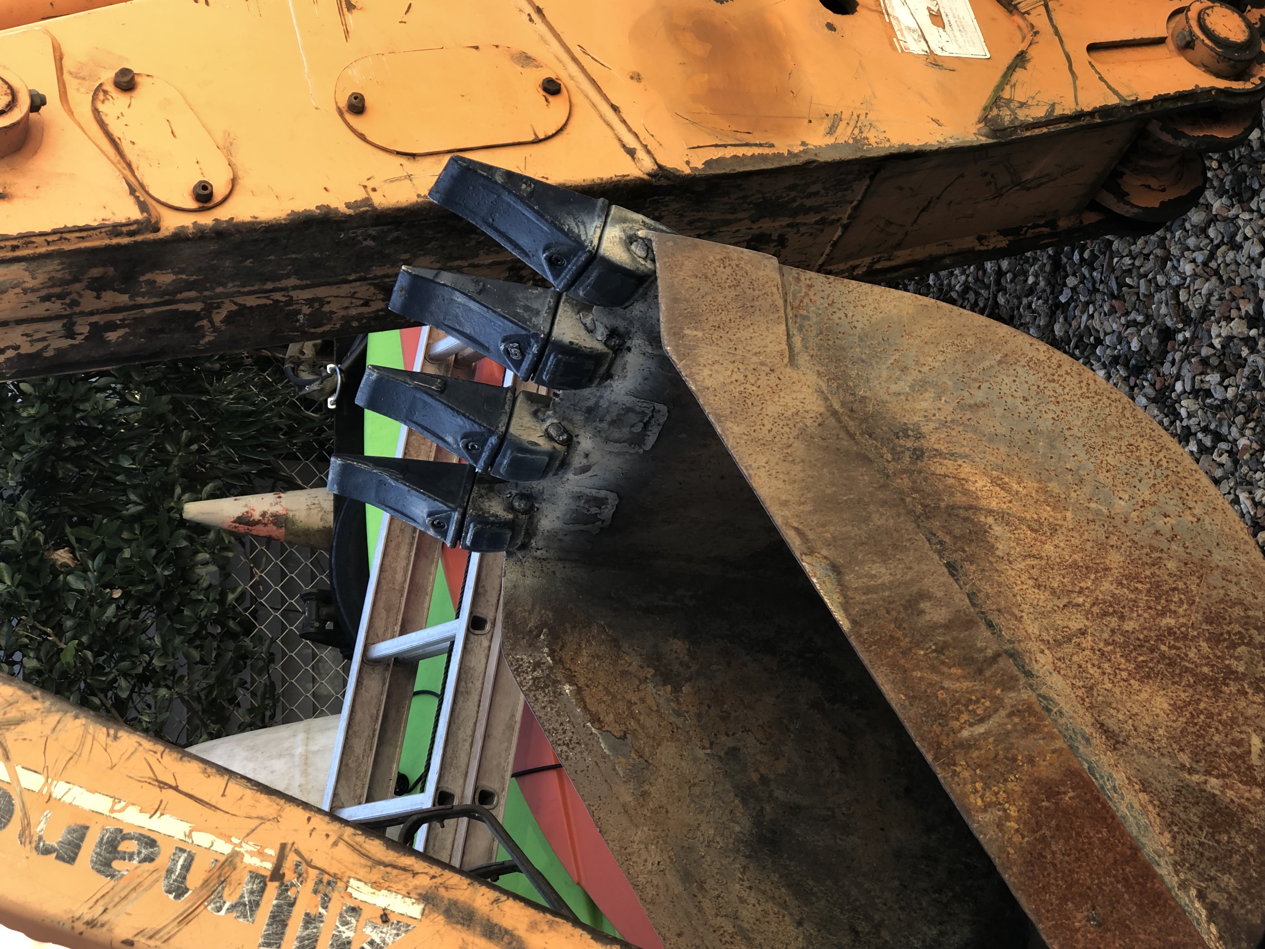

I bought the machine used and instead of replacing worn teeth the other owner added newer ones, so, on an 18" bucket there were 7 mangled teeth almost like having a solid edge. I torched everything off and installed the x156 teeth. IMG_1828.jpgIMG_1828.jpg
