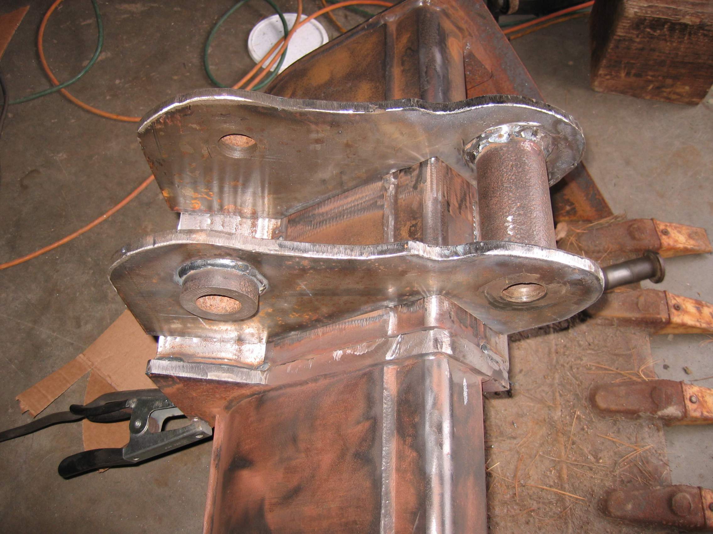

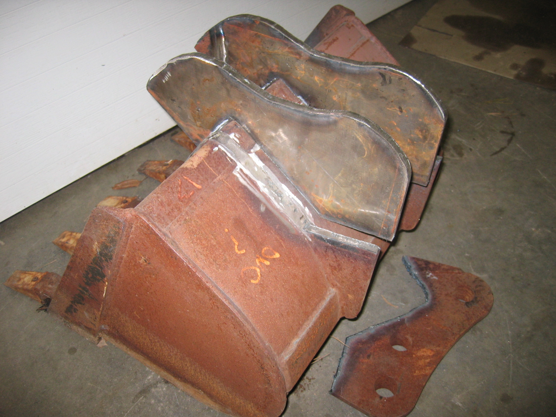

Bought a new left over 24" bucket for the 611 Bradco. I know I said I was going to build one but I stumbled over this example at the steel yard for one fifty out the door. Per my luck it doesn't fit my boom width so off with the attachment ears and on with some new ones. For a small bucket is built extremely heavy out of 1/4" material and has the replaceable teeth with knock out pins. With shipping a replacement is over a grand.... but it would fit out of the box ! IMG_3758.JPG

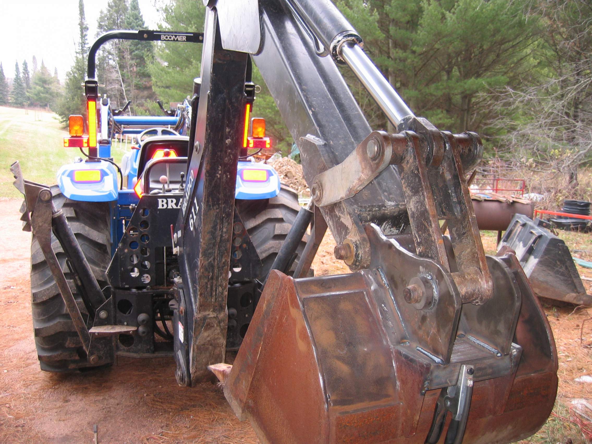

Nine hours total and twenty dollars in material. Works like it was made to fit.

Nice work looks good. Nice score too! I dunno 9 hours and a 20 spot for material the "over a grand" would have been so much easier!!! Heh I don't have that kind of cash for sure. Those ears look thicker than 1/4 in those pics.. Unless you meant the rest of it was 1/4 inch.

The sheet metal on the bucket ( sides and curved back portion ) is 1/4" steel plus the reinforcements. It is way overkill for a compact hoe but it will never get damaged or rust out. The attaching flanges are 1/2" mild steel with dom tubing for bushings. I had a piece of 1 5/8" dom tubing I was going to use and line the interior with a 1/8" thick bronze bushing but finding the correct size material and fitting it on the lathe would have added more time to the finished product. For the average user it will remain a tight fit for many, many hours of service.
As for the nine hours it took to complete .... when you have a Miller 252, Ellis bandsaw, oxy / acet torch, grinders, solid welding table, large vice, and good music it is like a day of vacation that ends too quickly. I just finished a 25' steel wind mill tower out of salvage pieces that will be spinning an eight foot fan in spring. I don't have to look too far for ideas / projects.
