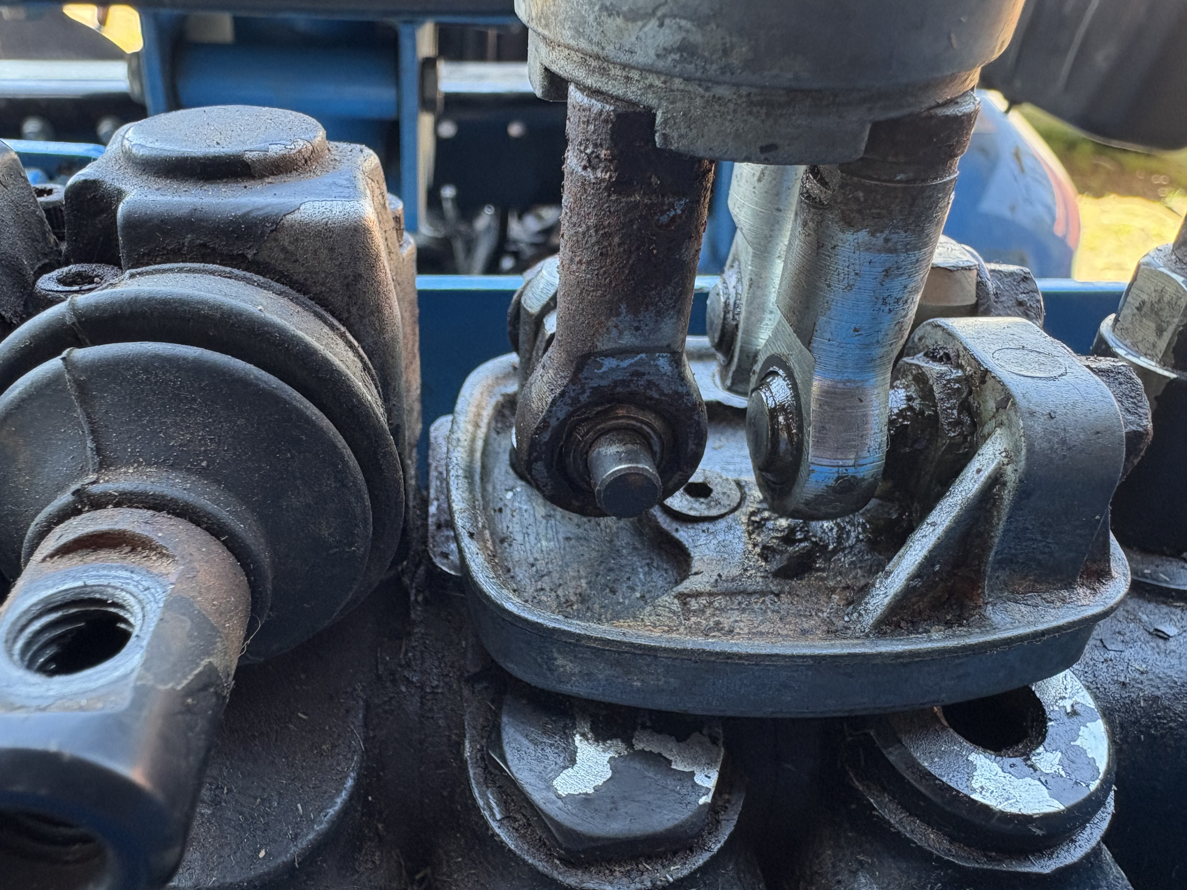

This is the boom control. Things seem to feel fine, control springs back, parts all seem there, corrosion at a minimum. I did notice when I pushed forward as if to lower the boom, there was a decent sharp reaction from the piston. But when the control is pulled back, that’s a very soft, slow reaction. Still not enough power to let the boom down so take that for what it’s worth.
Thanks for the valuable insights.
/ Backhoe boom power loss #11
Looks clean and tidy in there. Mine (bought used) was a mess and sloppy. Had to hold your mouth right for some of the functions to work.
New joints now she is good and tight.
If the two valves a controlled nicely by each joy stick you into the harder stuff of lines and seals.

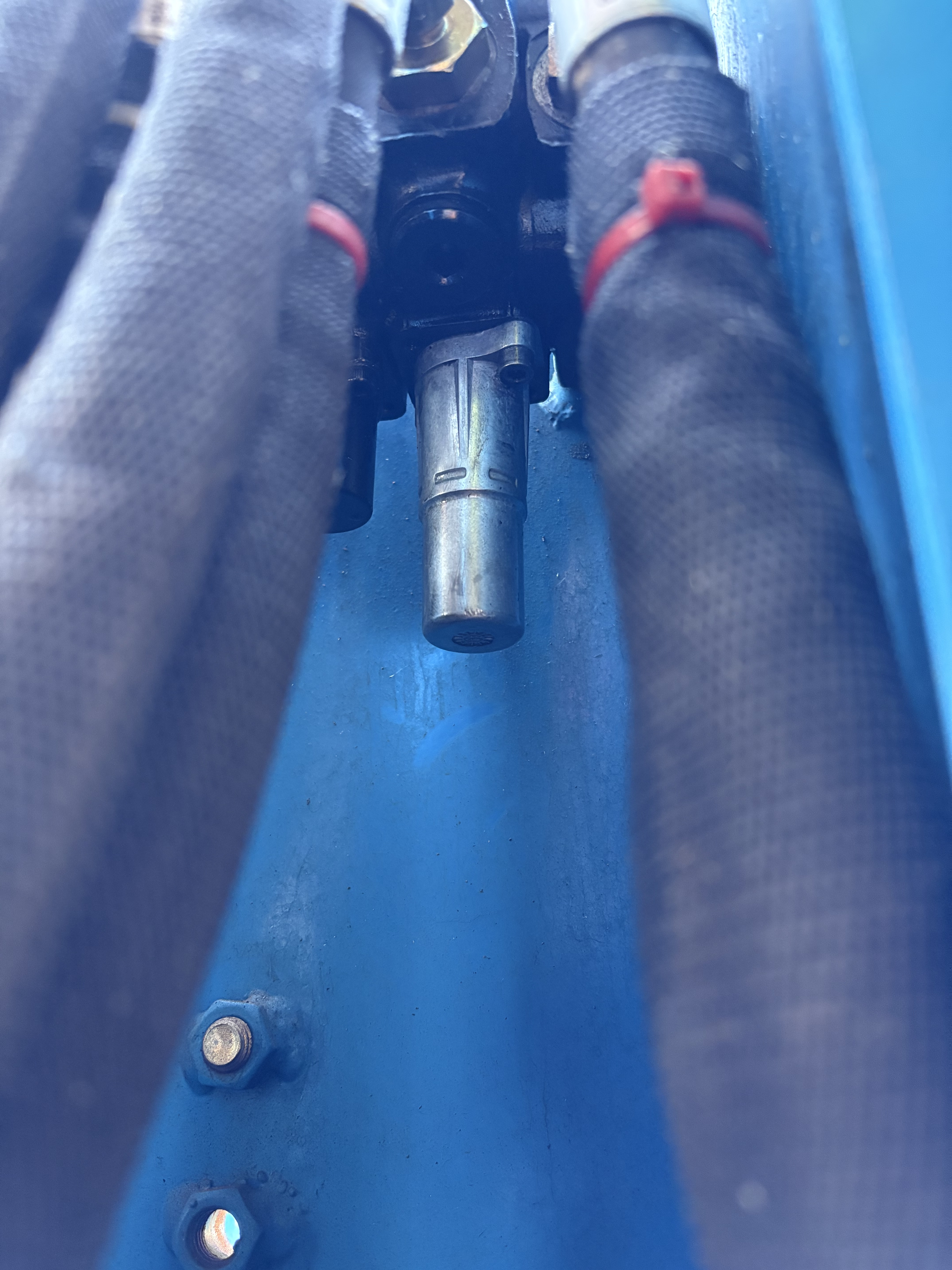

This detention cap (silver thing) seems to be solid, though if I put my fingers on it I come away with hydraulic fluid. No mess, just wet. Is that normal or a possible problem?
/ Backhoe boom power loss #14
After time it seems that all hydro system weep a bit, should not but reality says they do. That cap on the boom valve contains your detente for the boom float position. Sometimes things get crusty in there but you would notice it sticking or not going into float.
If you do pull be careful there are springs and little bearing balls for the detente that will try to escape, slowly or mighty quick sometimes. :oops:

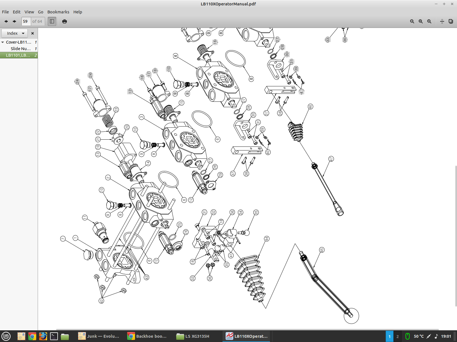

Control valve assemblies for backhoes are a lot more complicated than loader controls. BHs have check valves - which some loaders lack. And instead of just a single relief valve, it isn't unusual for BH controls to have a separate relief valve for each motion. These are common BH problem areas.
Any of these check or relief valves could have a piece of crud caught in the valve face holding it open. Holding a relief or check valve open would cause exactly the same symptoms as a bad seal on a cylinder piston.
The illustration in message #6 shows a BH control assembly with three check valves and four relief valves. I don't know about yours, but for Kubota it is typical for these valves to be dissassembled for cleaning. You can search for articles on it here on TBN.
