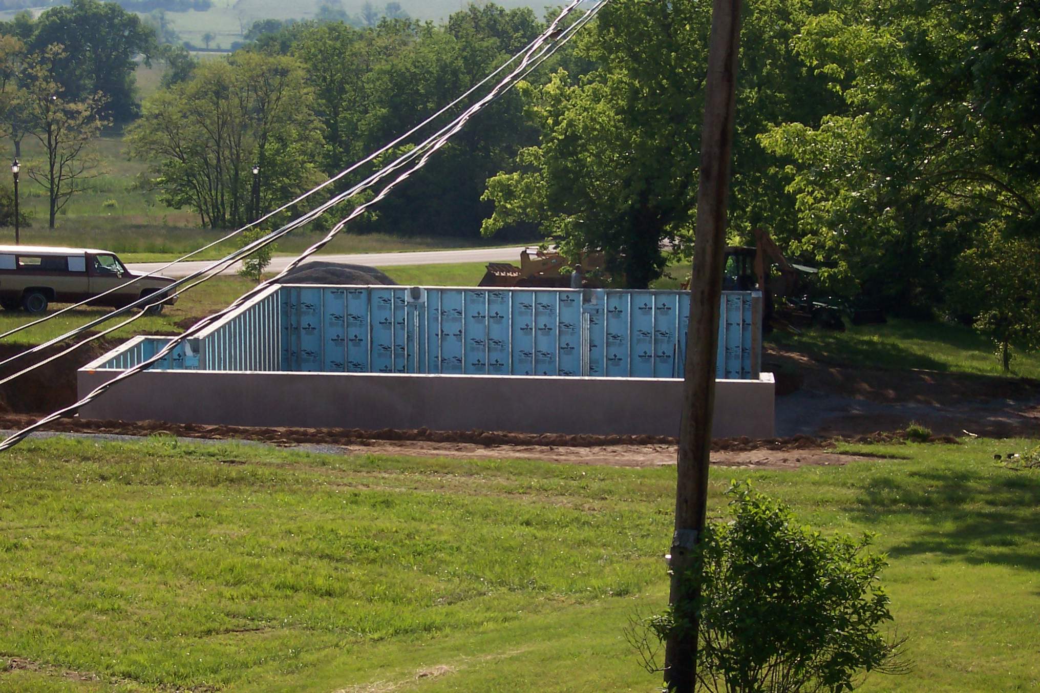

The wall without a return will have a 2x8 wall and a 8.25" SIP wall perpendicular to it before it is backfilled. The one with the return will have floor trusses every 16".
We will be drilling and using lead anchors to bolt down all of the wood or SIP walls.

I would also recommend having more than 1" between your framing and the ground. I believe the code book our county uses requires at least 6". Rainwater may splash off the ground onto your sills if they are close enough to the ground. Yes, you are planning to waterproof around the floor trusses. However, no waterproofing is perfect. You might want to consider that the ground will hold moisture and you may not want that moisture too close to your wood. I think I would try to take off another 6" of dirt around the front of your house if at all possible. I understand you have some challenges with the slope.

I think I will leave 6" of the concrete exposed with gravel starting below that. I do not plan to have material that can hold moisture near the house.

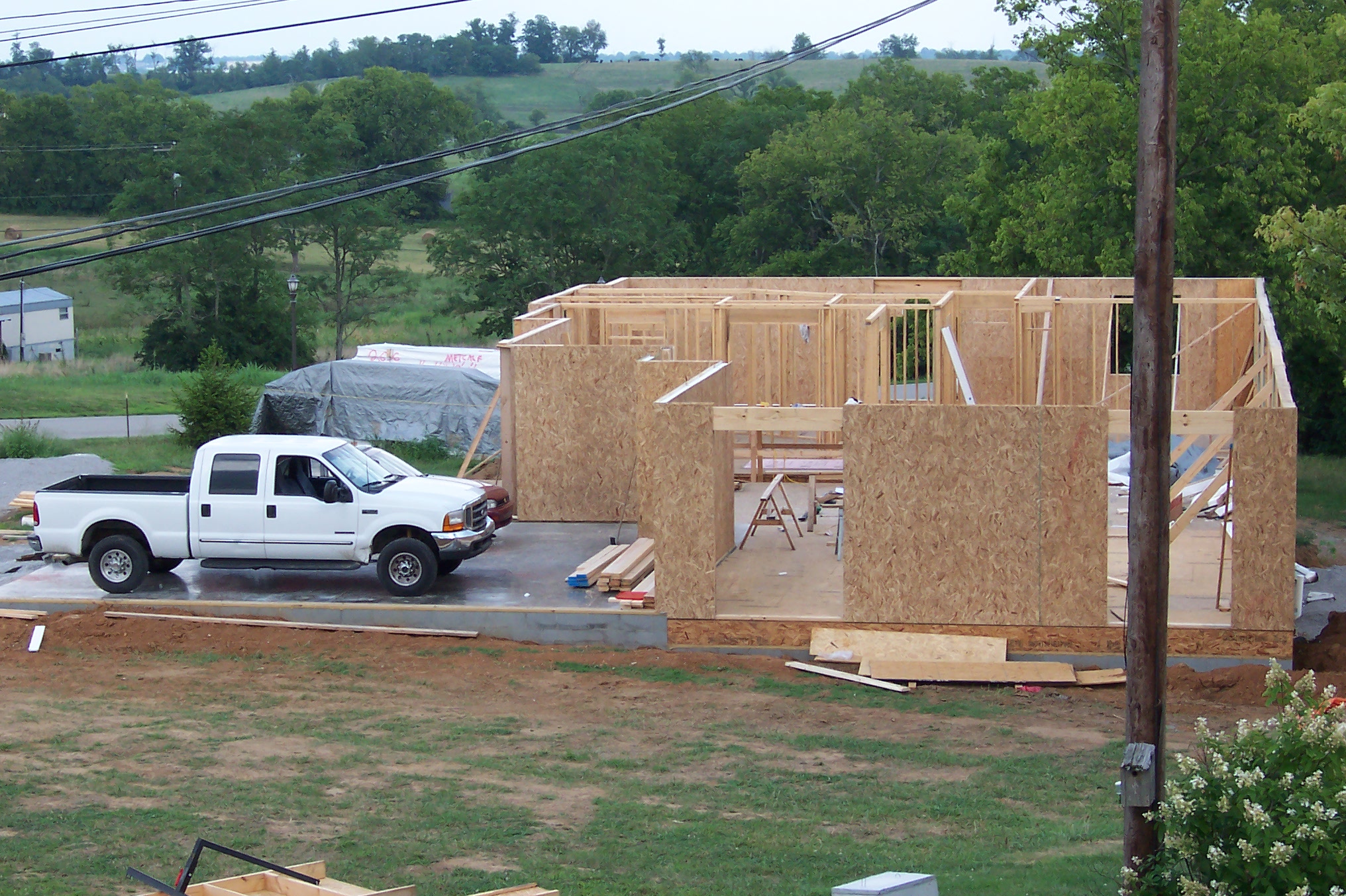

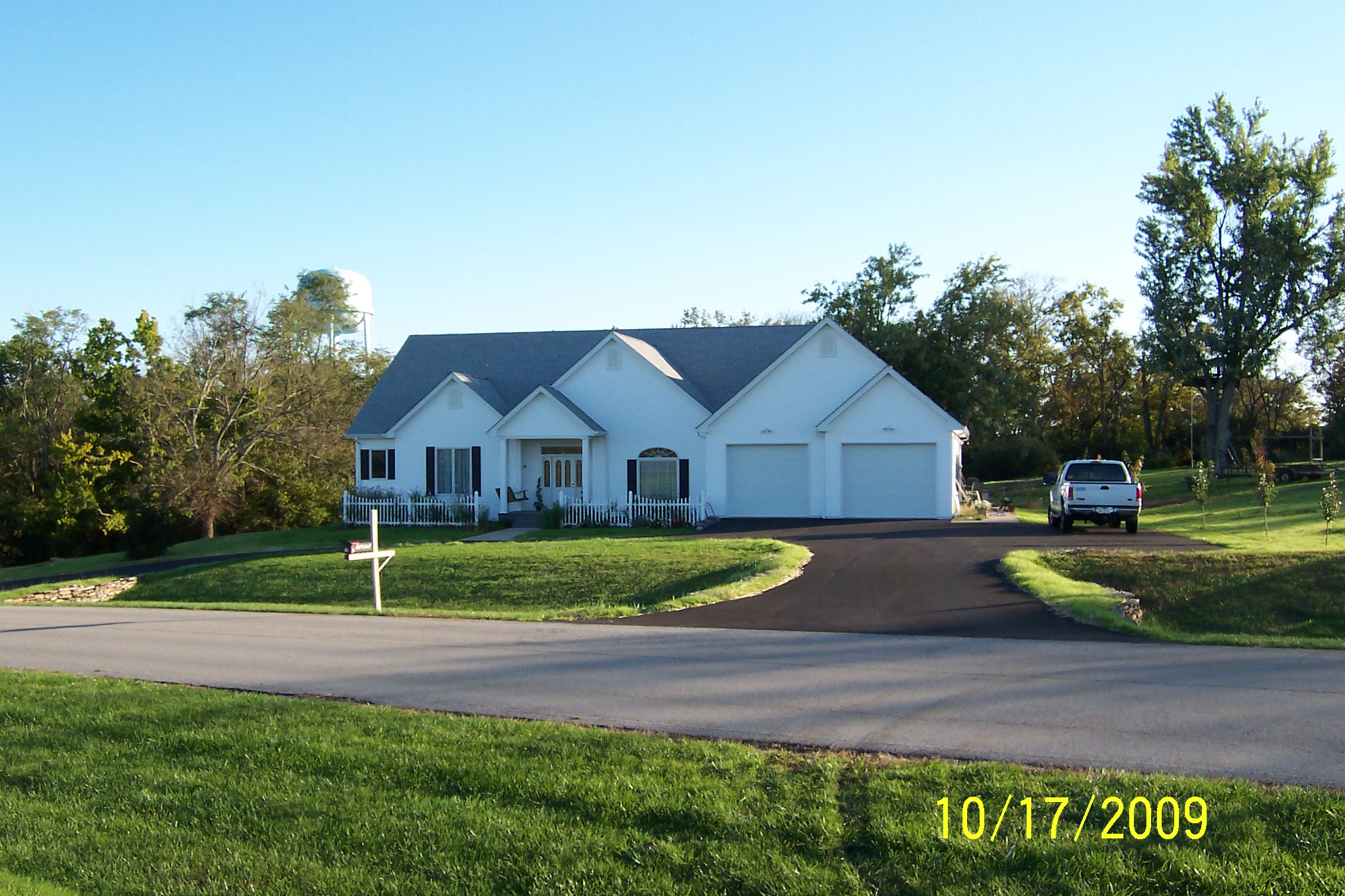

:)It looks like you are going to have a great house especially with your attention to detail. We built a sips house about two and a half years ago and love it. It came in at 1.45 air changes per hour on the blower door test and we are heating and cooling it (3,000 plus sq ft) for about 83 cents a day as near as we can tell. We have a lot of glass and keep the temp at 76 in the summer and 72 in the winter. It was the attention to detail that made the difference.
