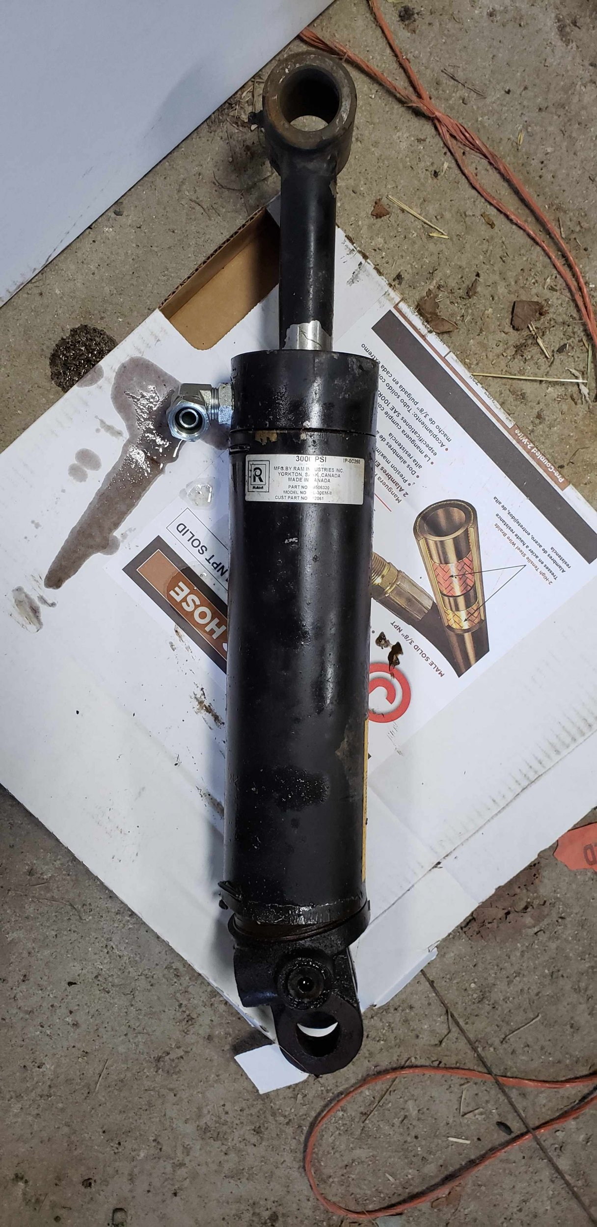

This is the 3.5" cylinder from my skid steer snow blade. This was a very heavily built blade but had only a single cylinder. Since this happened I found most snow blades I've looked at have 2 single acting cylinders. This blade was designed so when plowing toward the right (most frequent) the cylinder was extended, and most of my snow plowing is fully angled. Last January I was finished my last pass, was waiting for garage door to open and looked at the blade area and saw the spray of oil. Tracing back, I saw where I hit a frozen chunk along the edge and it ripped the cylinder end apart. It was at the end of its stroke so hoses were protected but mechanically, it was toast. The chunk I hit was not enough for me to even notice or to sway my CTL which does not have very good tractive effort on ice - but it does have 4 ton of momentum.

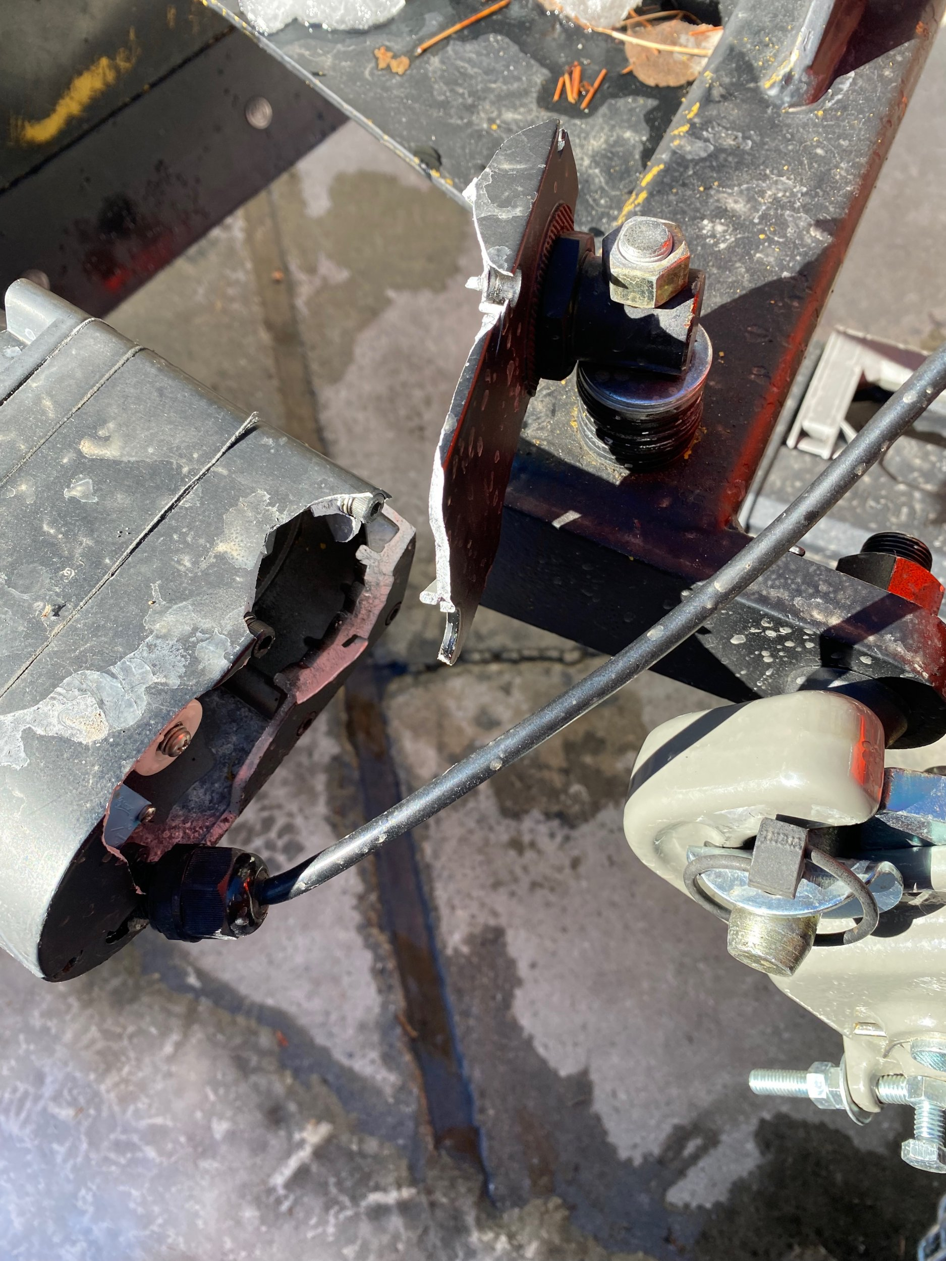

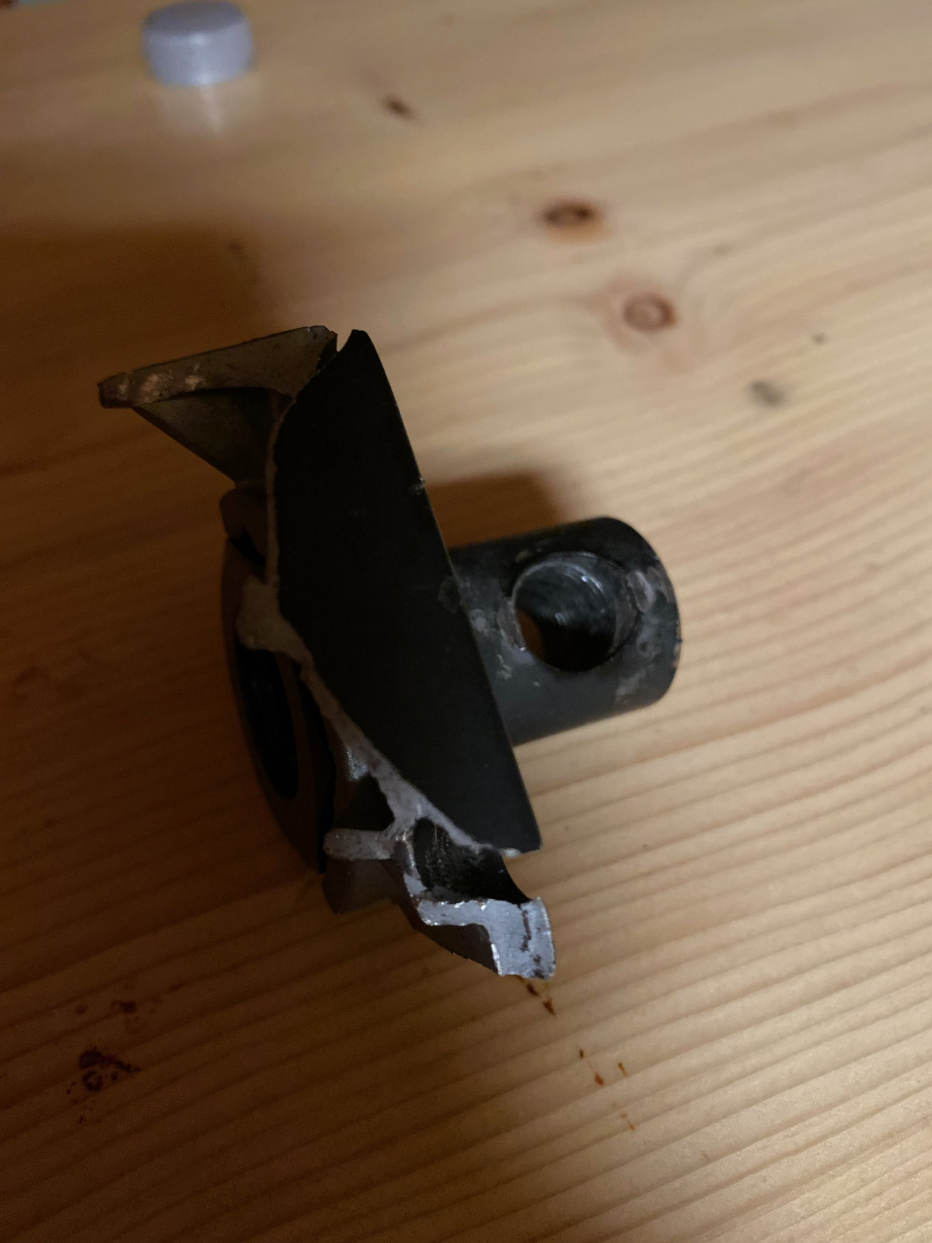

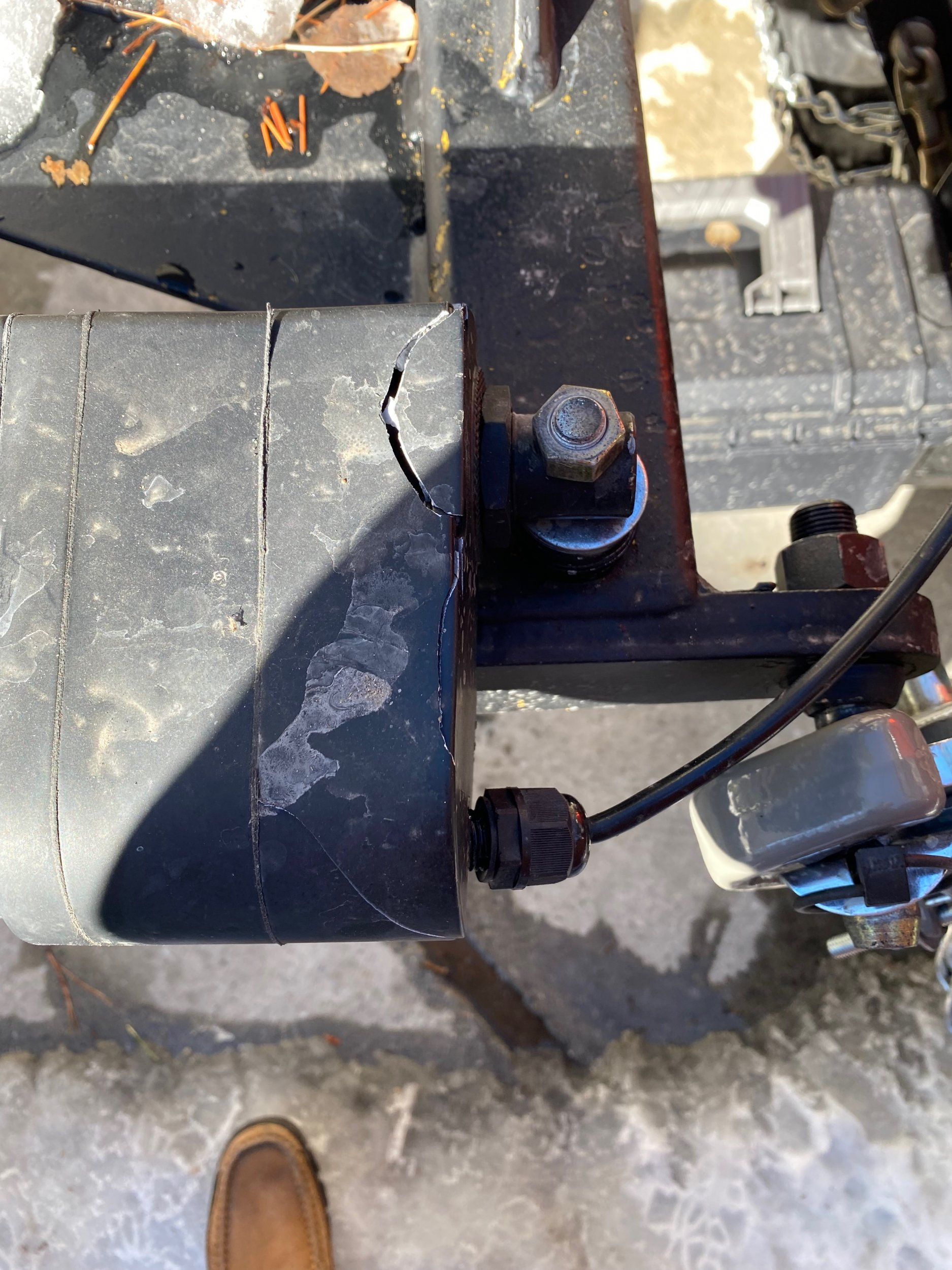

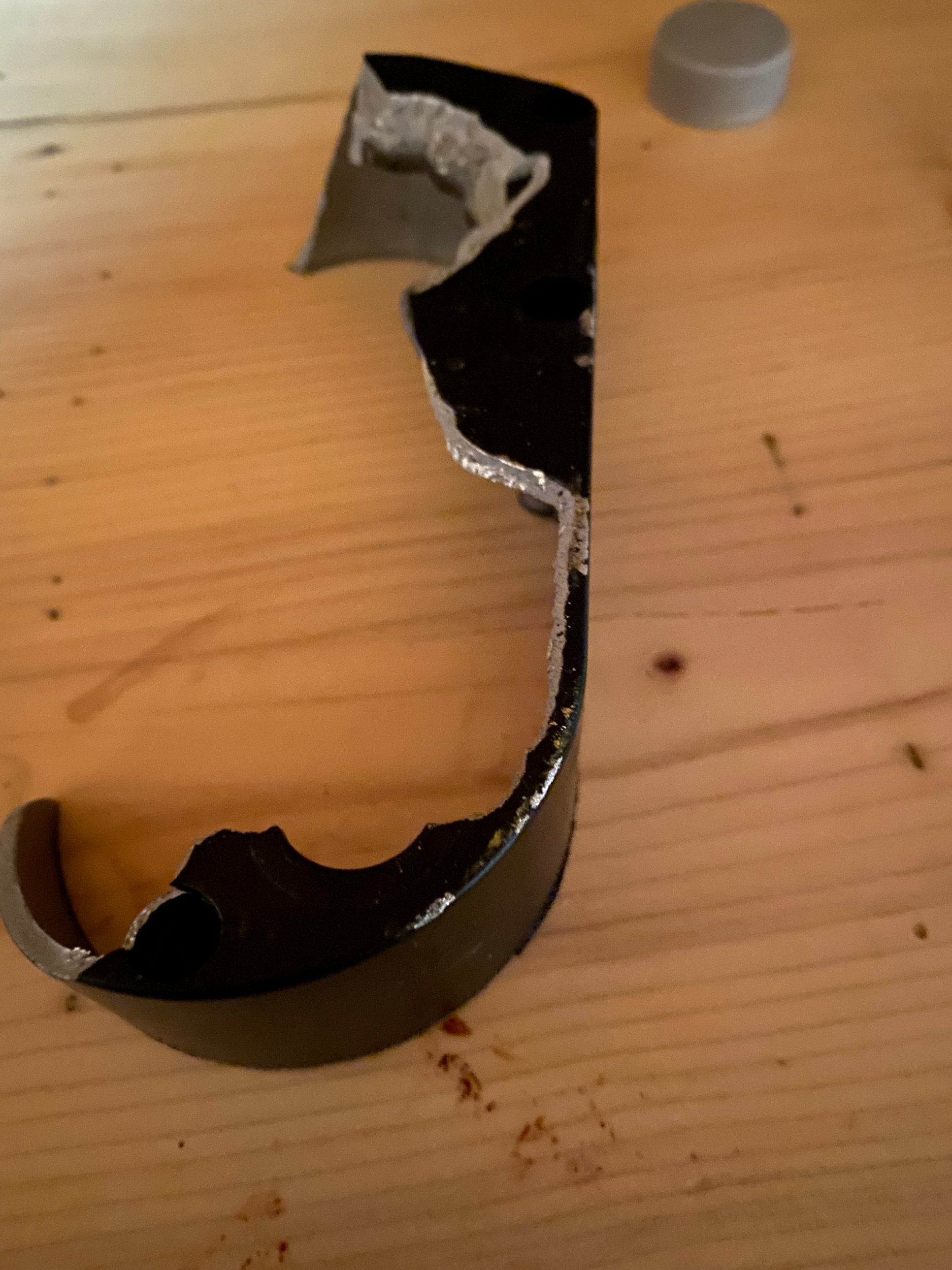

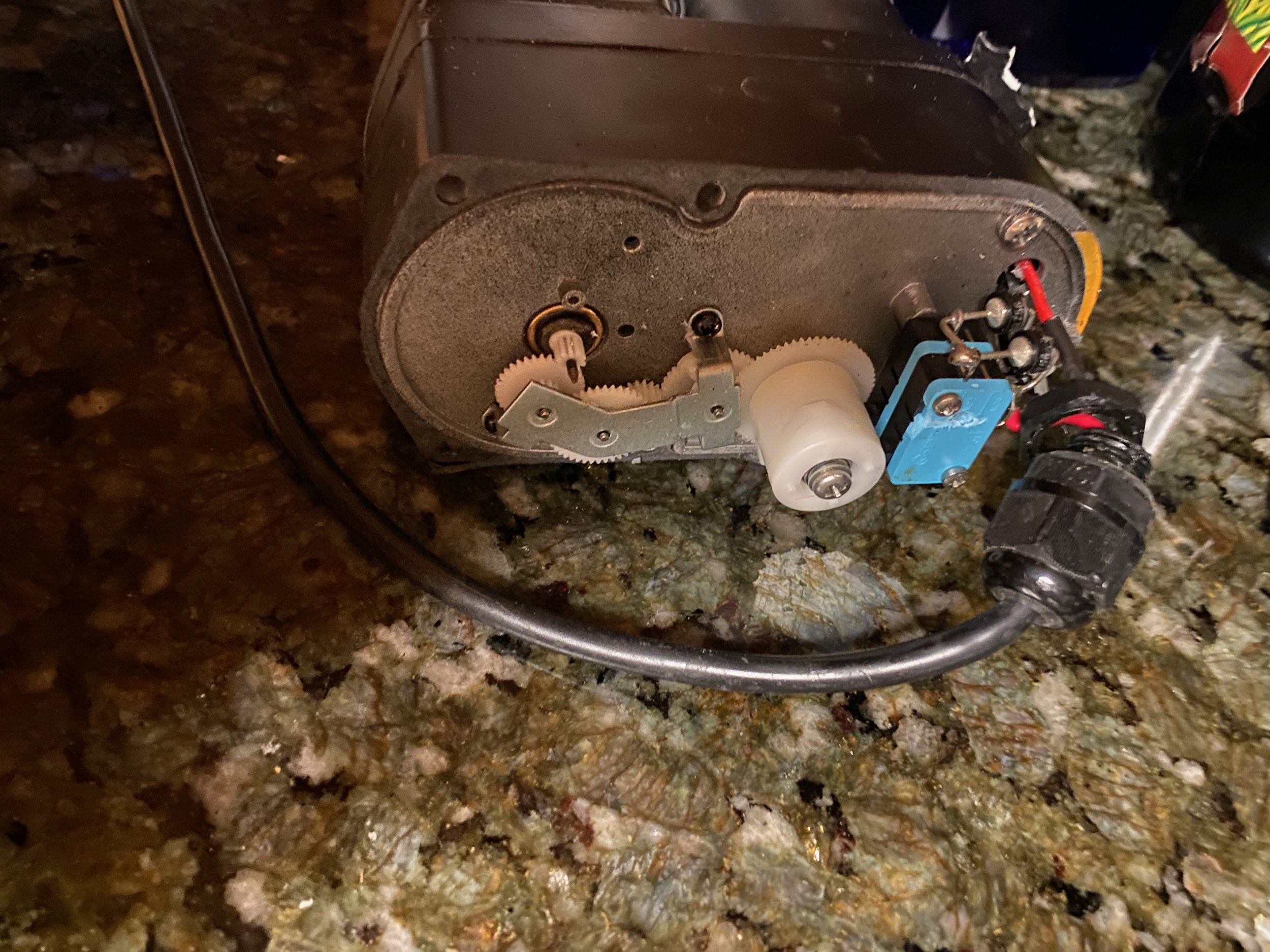

i used a similar setup with a Progressive Automations electric actuator, 2000# load with a 3000# static load. It worked fine till the end piece, which is made of cast aluminum splattered. They are sending me a new end piece, which I have to pay for, and I am going to reinforce with steel backing plates. I am also going to use soft 1/2" bolts for the mounting so one will shear vs breaking the actuator. I wsas using grade 8 which bent.
I do not understand how an aluminum casting can withstand a 3000# load and as the photos show it cant.
