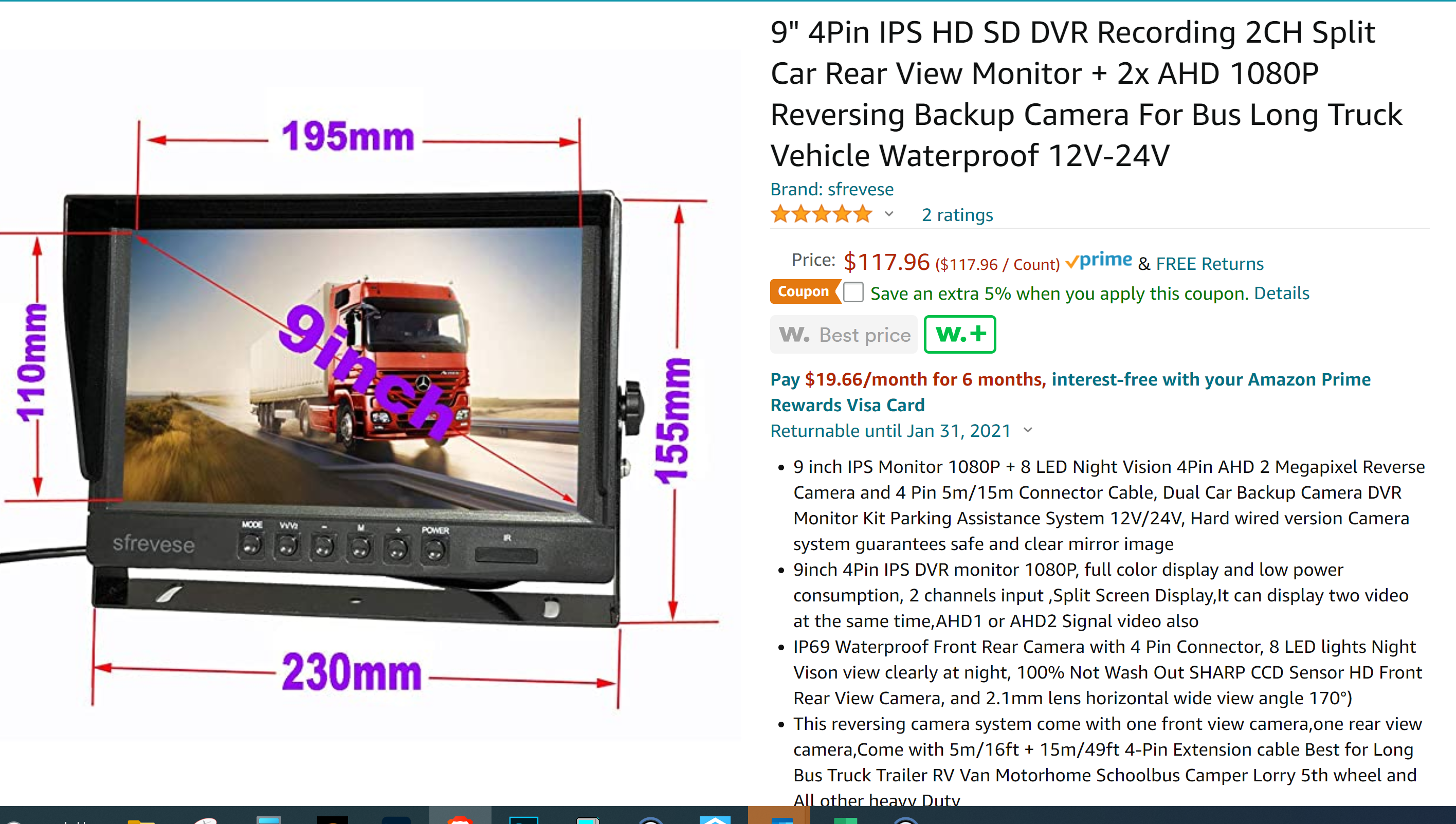

I just received this from Amazon yesterday:
I don't operate my tractor in the rain so having a waterproof monitor isn't important. For snow removal I'll probably just put a plastic bag over it. This one comes with 2 cameras and can operate split screen or you can select one camera. It's 9" diagonal and 1080p. I hooked it up in my basement to check it out and I think its going to be perfect for me. Both cameras will be rear mounted. One will face down at the rear implement and the other straight back. For my current project of regrading my driveway with the box blade it's going to be a neck saver.
