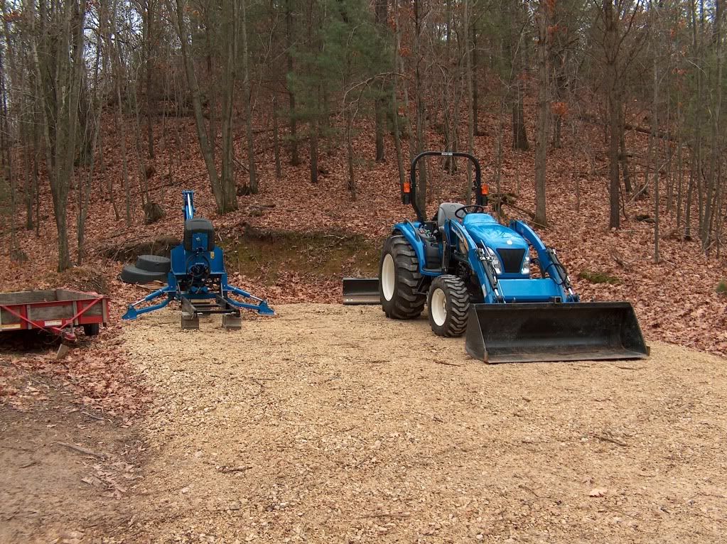

The ones on my blade are 6" in dia and the vertical post is 2" solid steel. I am glade that I have mine. If they don't do any good, then the ground is to soft. No you don't have to have them, but they make things easier IMO. Oh, and mine were $200 a pair. :mad:

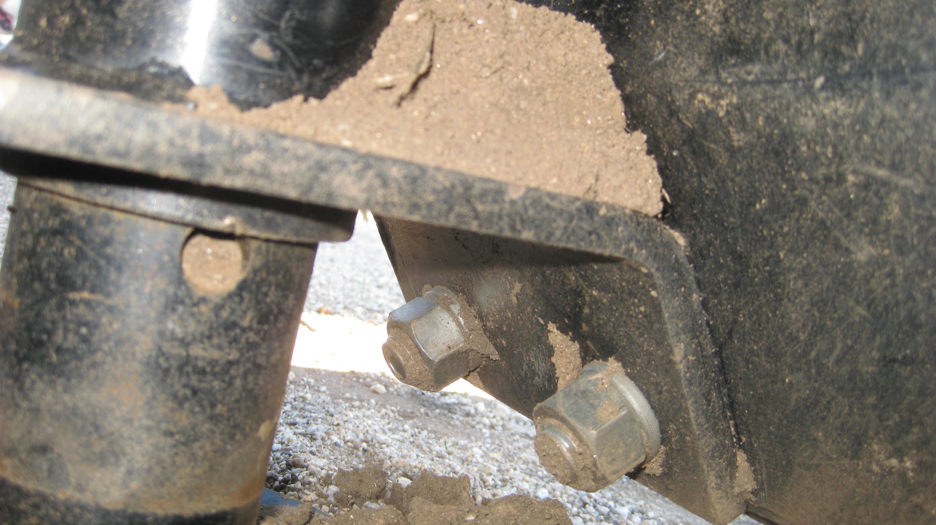

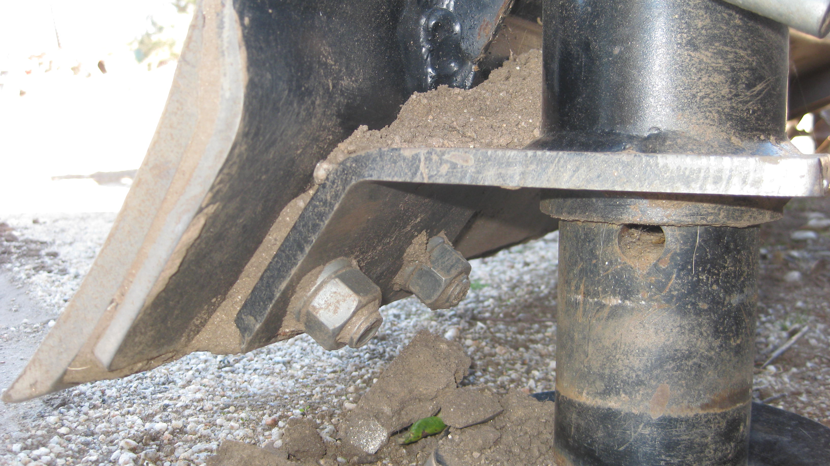

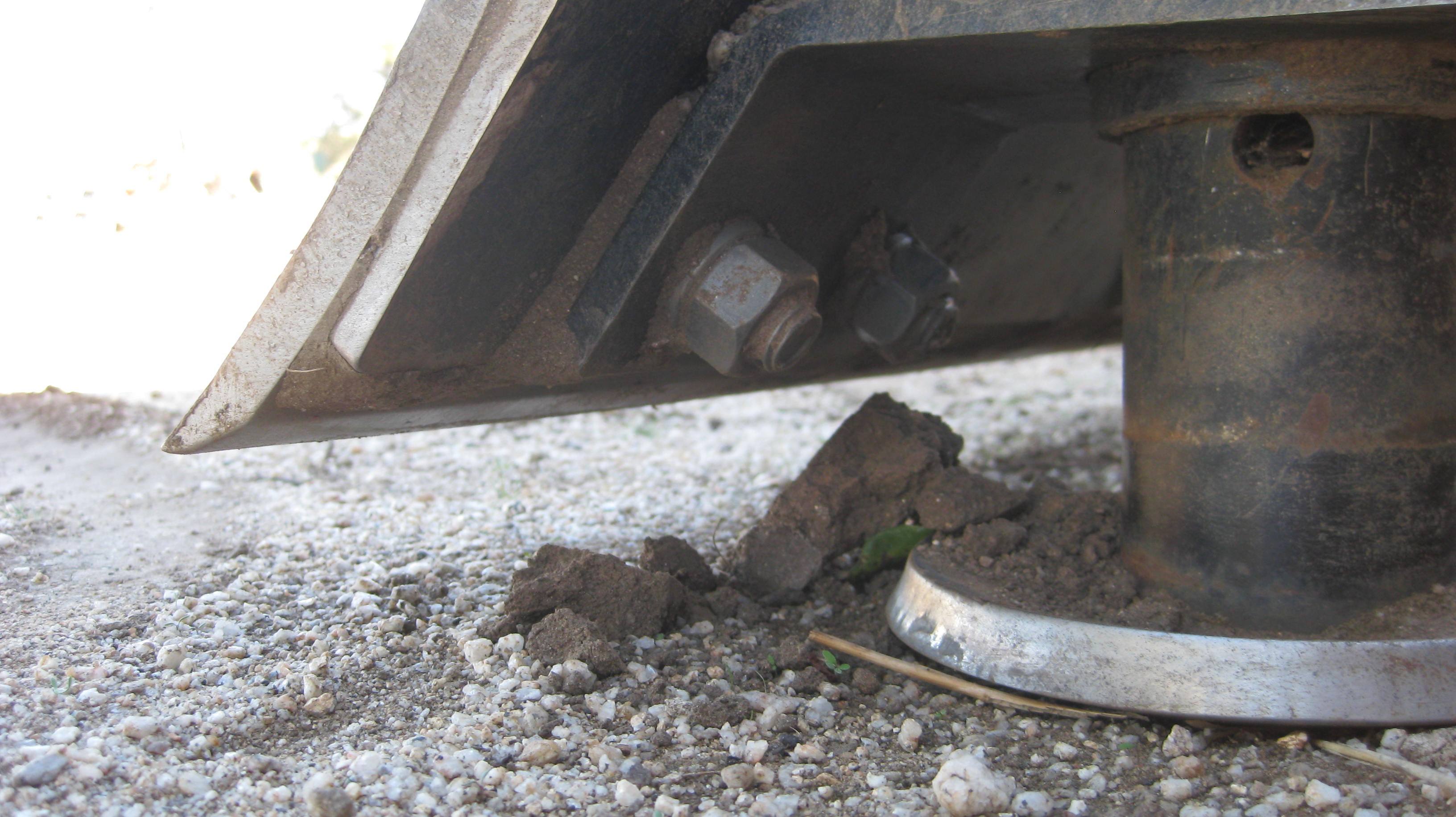

jobguy, here are some close ups of my skid shoes. I was wrong about the 2" solid stock, they are 2 1/2" solid stock with the outside of the sleeve being 3" dia and the shoe is 1/2" stock 6" dia.
