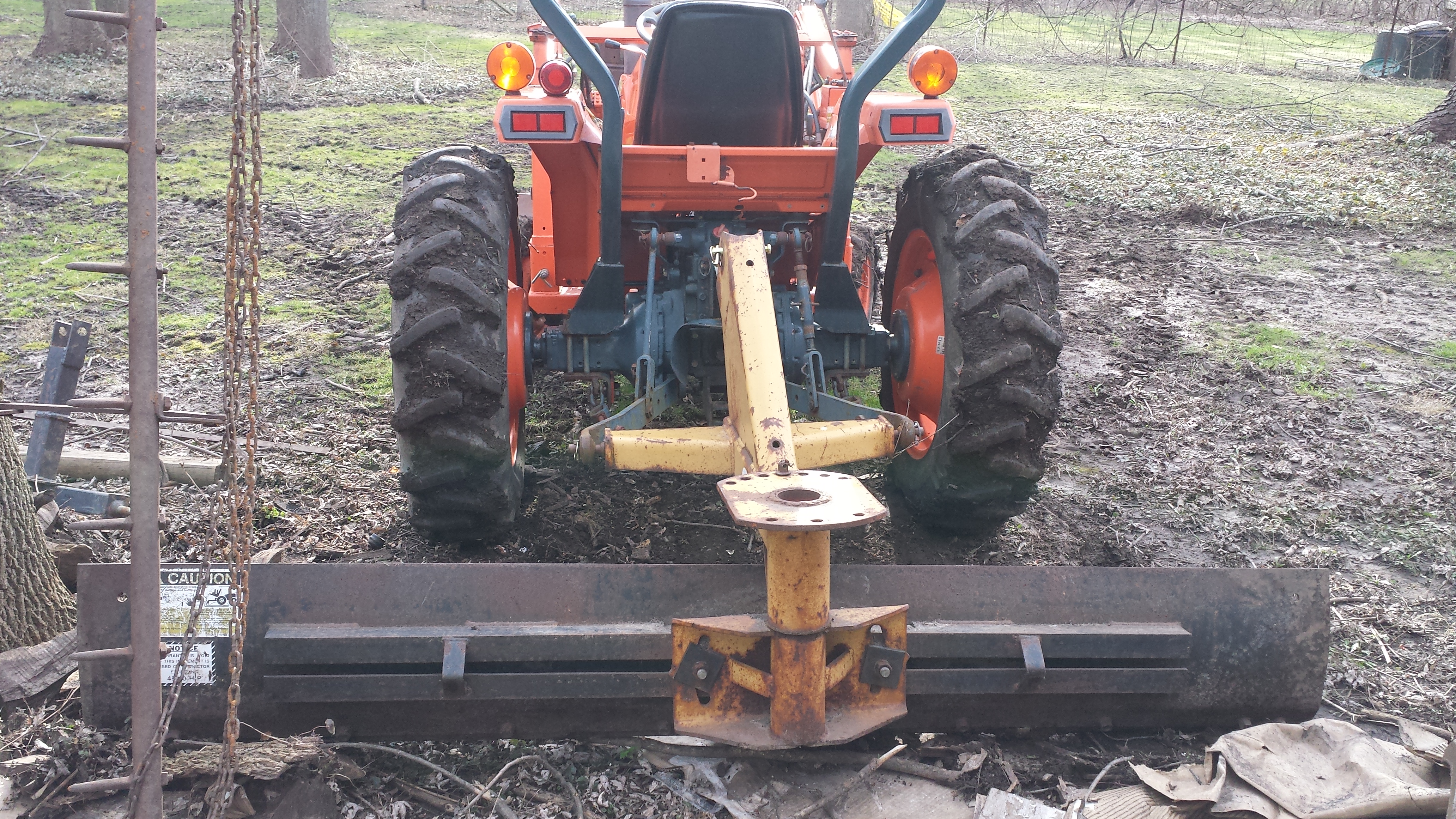

I got a deal on a back blade today but it was bigger than I thought when I arrived. I mainly want to use it for snow removal. Its an 8 footer, it was advertised as a 6. I'm contemplating cutting it down. Any disadvantage to this vs selling it and buying a 6. I think the extra weight might be advantageous on my driveway, like down pressure. But 8 is too big. 20160318_165352.jpg

If it's just for snow, it might be fine. I would angle thr blade and see how it covers your tracks before you unload it. As for your driveway, it's way to light of a blade for anything more than light smoothing.
/ Back blade question #4
The hp/foot rule doesn't mean much for a rear blade. The intended uses is more important. Looks like the moldboard is homemade or shop built and then added to the blade. Previous owner probably wanted more coverage. Would be very easy to cut off some on each end. But, you might look at the sell and buy what you need method too. You'll decrease the value of the blade with each inch you cut off.

27 hp and the wheels are 65" wide... it's about 1.47x the width of my rear wheels.
Original intent was for snow removal, maybe some light grading.
/ Back blade question #7
I'd sure be using it for a while before cutting it any shorter . That blade has a good feature being able to slide it more to one side or the other.

I thought that might be handy... it's a pretty stout blade. I'll hold off on modifications til I use it.

I would not cut it...on an angle you will be glad it is as long as it is ...IMO...!

More of a tractor weight factor. An 8' blade may push the rear of a lighter tractor around too much. Larger snows would still push the rear of my L3410 with loaded rears using a 7' blade.

It might work fine as is. I have a 6' blade on my little Ford 1210 and I thought a 5 footer would be max. It wouldn't get far scraping dirt or crushed stone. For snow it's great.

With that blade, it would allow you to angle it more so there is less force trying to push the front end around OR slide the rear. You can angle it till the tip is just behind your rear wheels. The more angle the less side force is generated to move the load.
I wouldn't cut anything off till I determined from use that it wont function for the tractor.

Nice looking blade, but I think you'll find it's way too long for the weight of your tractor. My B2150HST w/ loader and filled rear tires is well-matched with a 6' blade. But the rear end will still want to scoot sideways in 6 to 8 in. of wet snow. My guess is you'll be plowing every 2 in. during a snowstorm. :)
Since it was priced as a 6 footer, I'd see if I could sell it for more than you paid before you try to cut it down.

That sure looks like a Countyline from TSC with homemade swap on the adjustment bolts. You can certainly offset your leading edge so its closer to a tire... when its set most aggressively to one side or another the "footprint" is not so huge--probably near to six feet. Try it and see how it works--its not too heavy as is, and you can always cut it later.

I used it for some light grading today. What I learned is that 8' just barely fits thru the gate to my back yard. I had it pivoted all the way to one side and still had to "hook" the tractor in. I don't anticipate using it back there often though.
