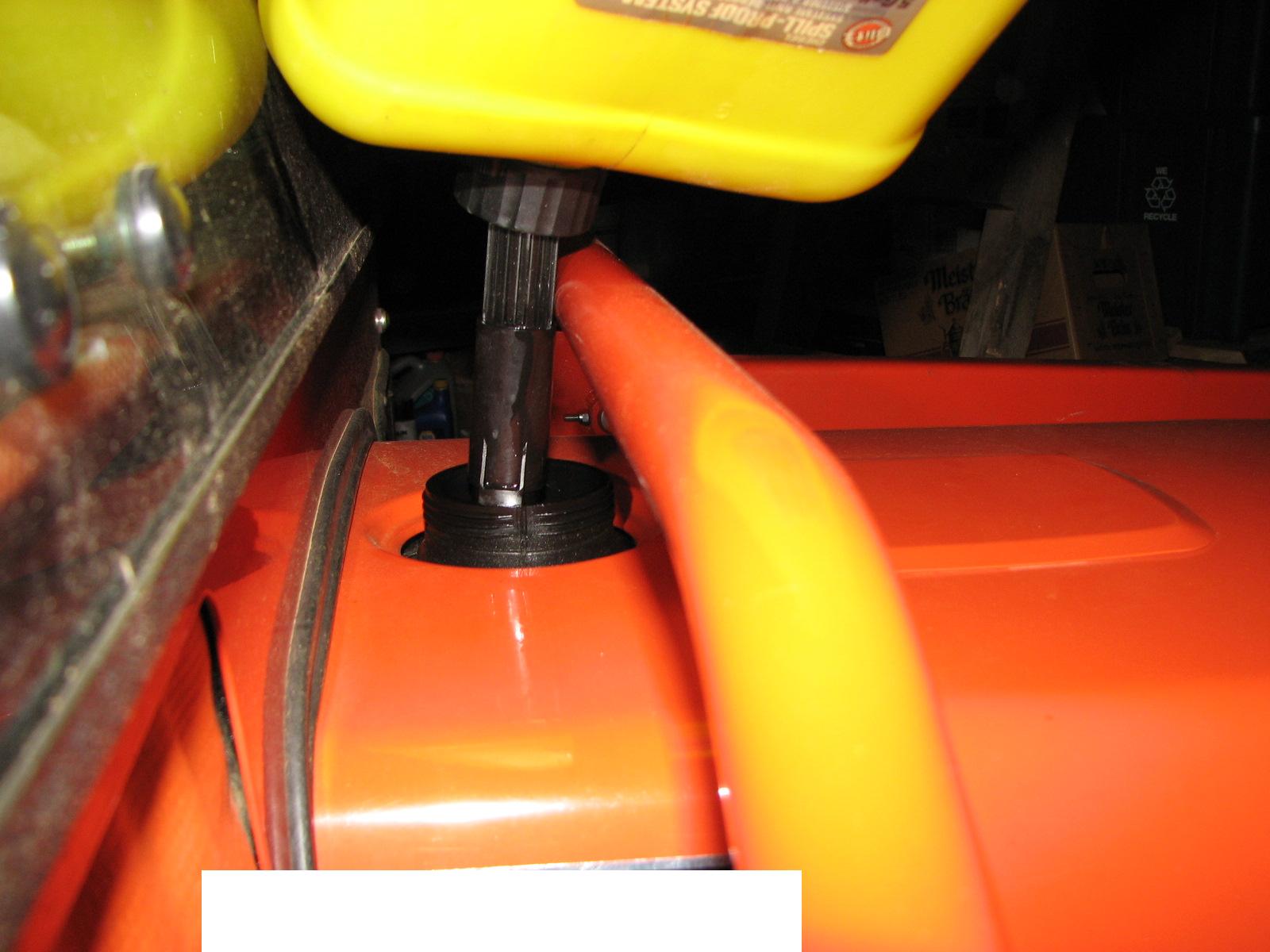

I have a B7800 with a Curtis Cab.
After owning the B7800 for 5 years I finally got a LA402 loader installed.
I see a potential problem when it comes to fueling now that I have the loader,
with the cross bar passing over the top of the fuel cap, and the Curtis Cab installed.
Without the loader cross bar,
I use to be able the use my blitz nozzle stye
plastic 5 gallon fuel container to fuel with.
Now with the Cab and the loader cross arm in the way,
I can get the blitz nozzle lip on the lip the fuel tank,
but I can barely get the nozzle to open,
because my downward movement to open the nozzle
is limited by the can against the tapering glass of the cab
and the nozzle against the loader cross arm.
B2910 and B7610 owners with cabs and loaders I think would have a similar issue.
I was wonder how you folks might be fueling your tractors.
Thanks in advance

Add a length of rubber hose to the end of the nozzle.

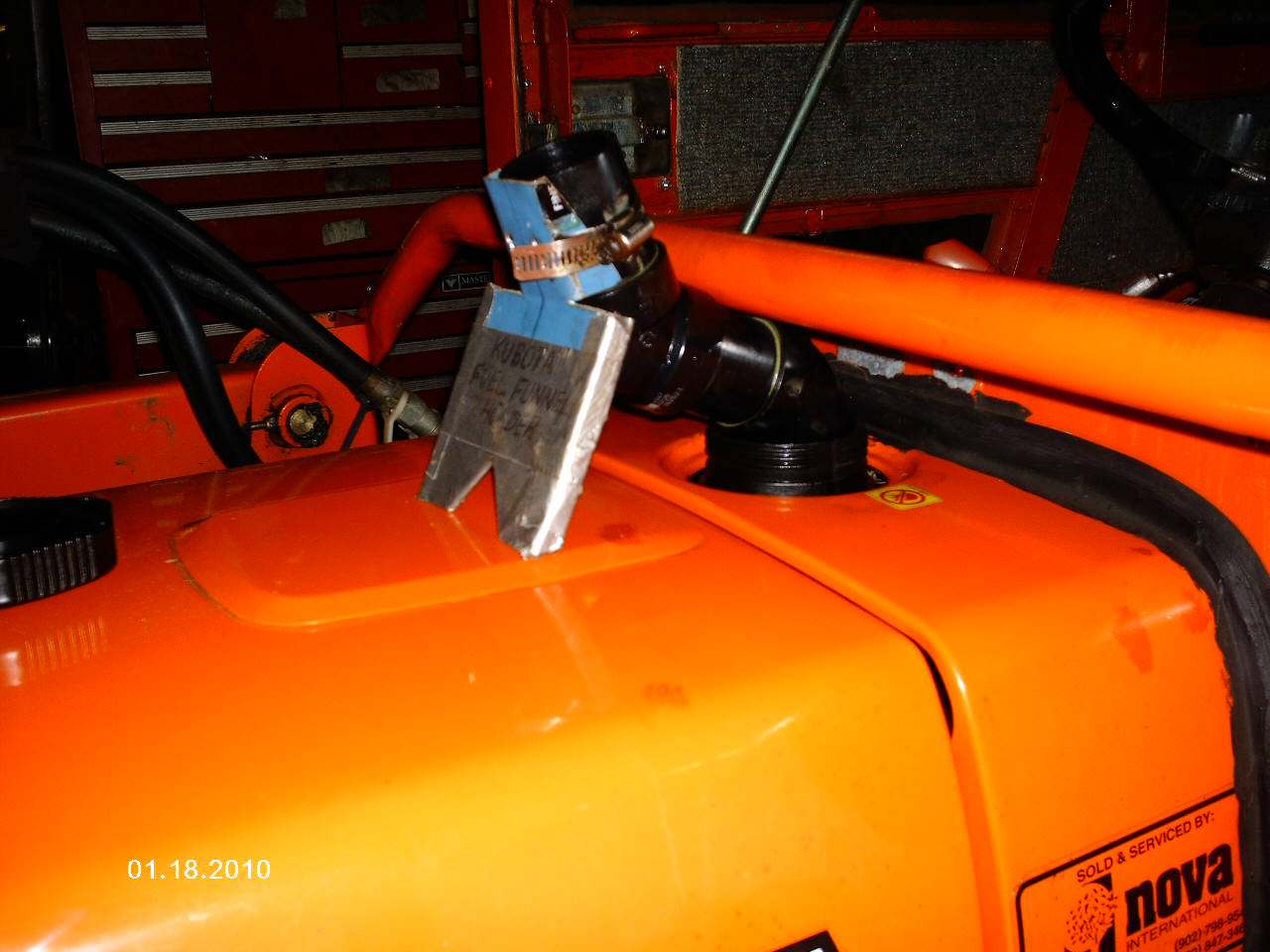

Yep, it's an annoying little problem, especially with a cab. Like John Thomas, I also have used the little squeeze siphon pump and it works well, but I like to use a screened funnel in case there's any dirt in my fuel containers. So I rigged up a homemade funnel holder from plastic plumbing pipe fixtures (2 elbows and a short length of pipe). It fits under the crossbar and essentially offsets the tank filler pipe. It works quite well. I'll try to get a picture and post later.

Here's a couple of pics of my funnel holder. The pipe is 1.25" ABS, the legs are scrap sheet metal covered with duct tape to prevent scratching. I think Red Green would approve.:rolleyes:

I like the idea of using a screened funnel, I've been noticing sediment in the bottom of my fuel cans.
I'll be building me a homemade funnel holder like what your pictures show.
I appreciate you showing me.
