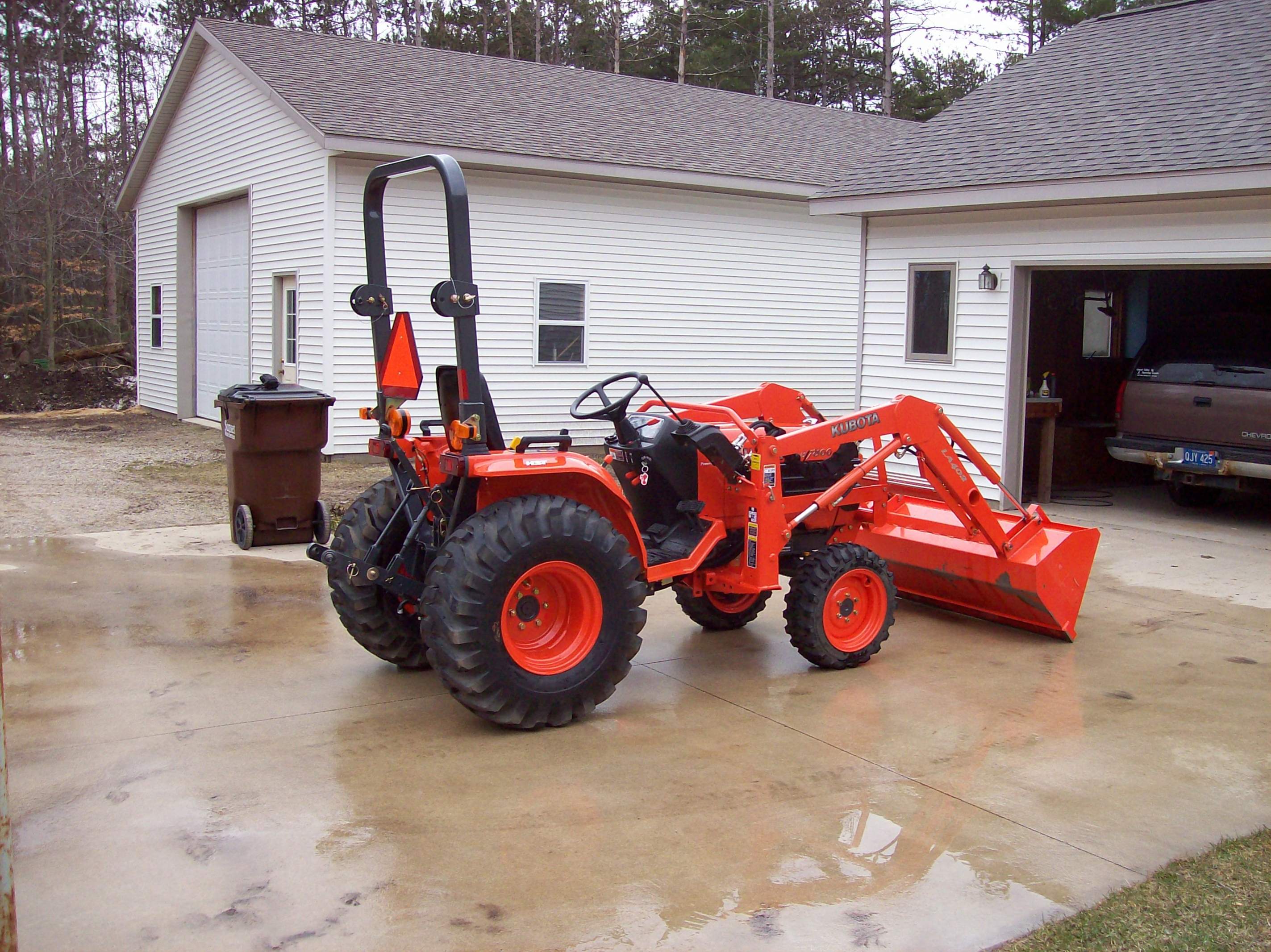

My B7800 is just the right size for me. Its been a great tractor:):)
