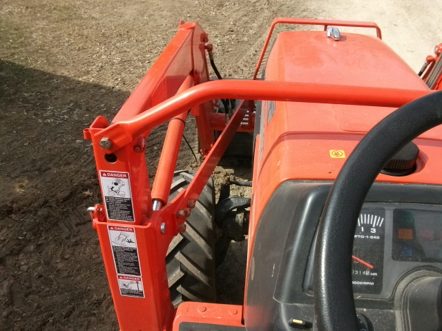

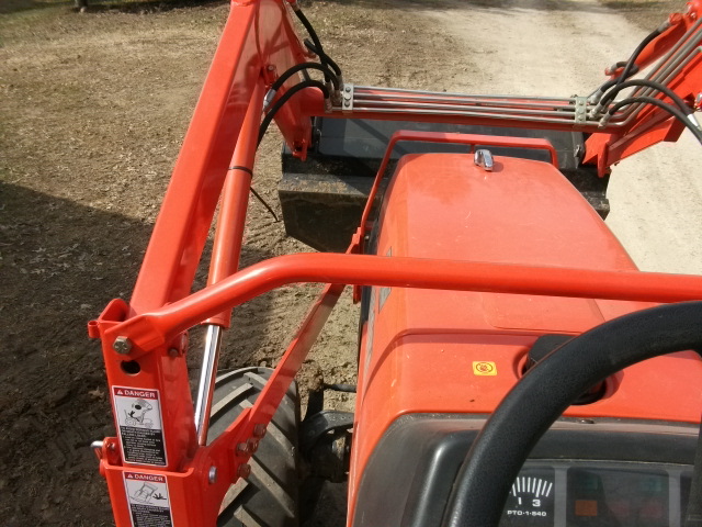

Here are 2 visibility shots on my B7800 with LA402 loader.
