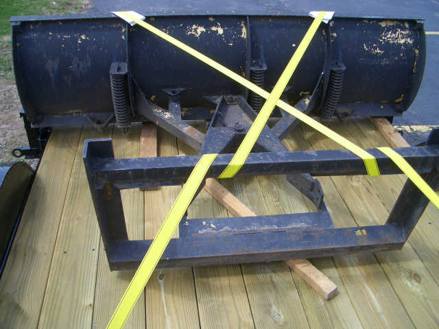

Went and picked up the plow today, it's little bigger than I remembered. 7-1/2' and looks like an old Fisher?

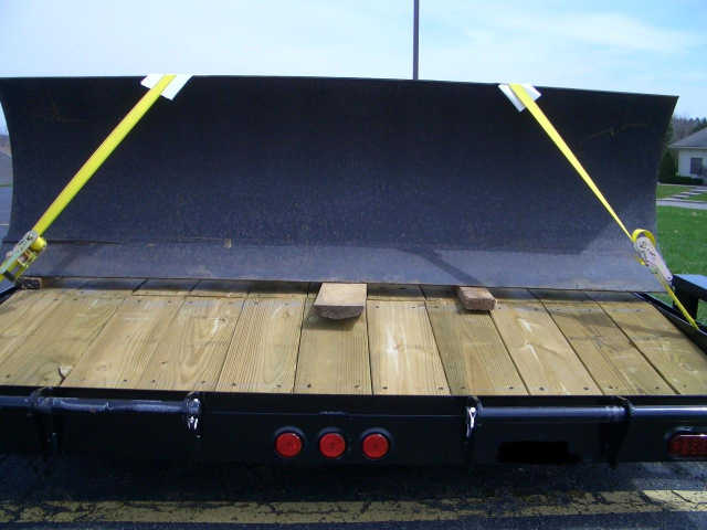

   / B7610 quick connect subframe
Was most recently used on a skid steer, therefore there were a few frame mods done that will have to be undone.

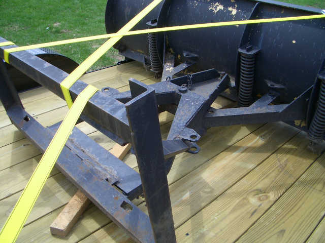

Another shot of the frame, all the piston mounts, springs etc., are ok. A bit of sandblasting and paint, hope it's not too big for my 7610. Open to frame or subframe design suggestions if you have an opinion...
