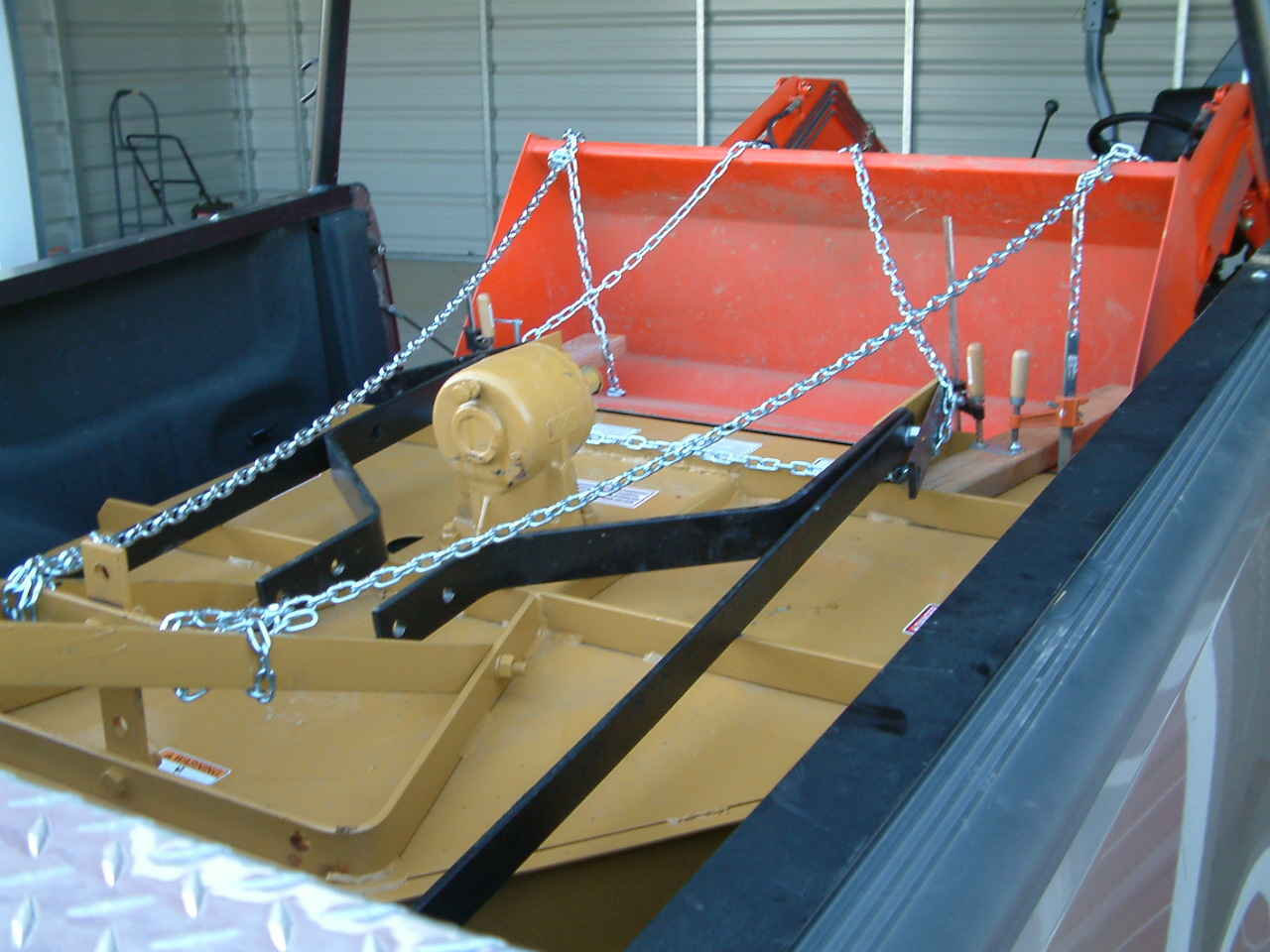

Unloaded the hog from the back of my F150 by chaining it to the FEL. Really glad I had the dealer weld three chain hooks on the bucket. With my 200 lb in the seat and the 425-lb hog cantilevered from the FEL, the balance was a little light and I managed to bounce the rear tires when I lowered the hog to the garage floor. No harm done, just a fun ride. I definitely will make one of those concrete counterweights for the 3-pt hitch real soon.
