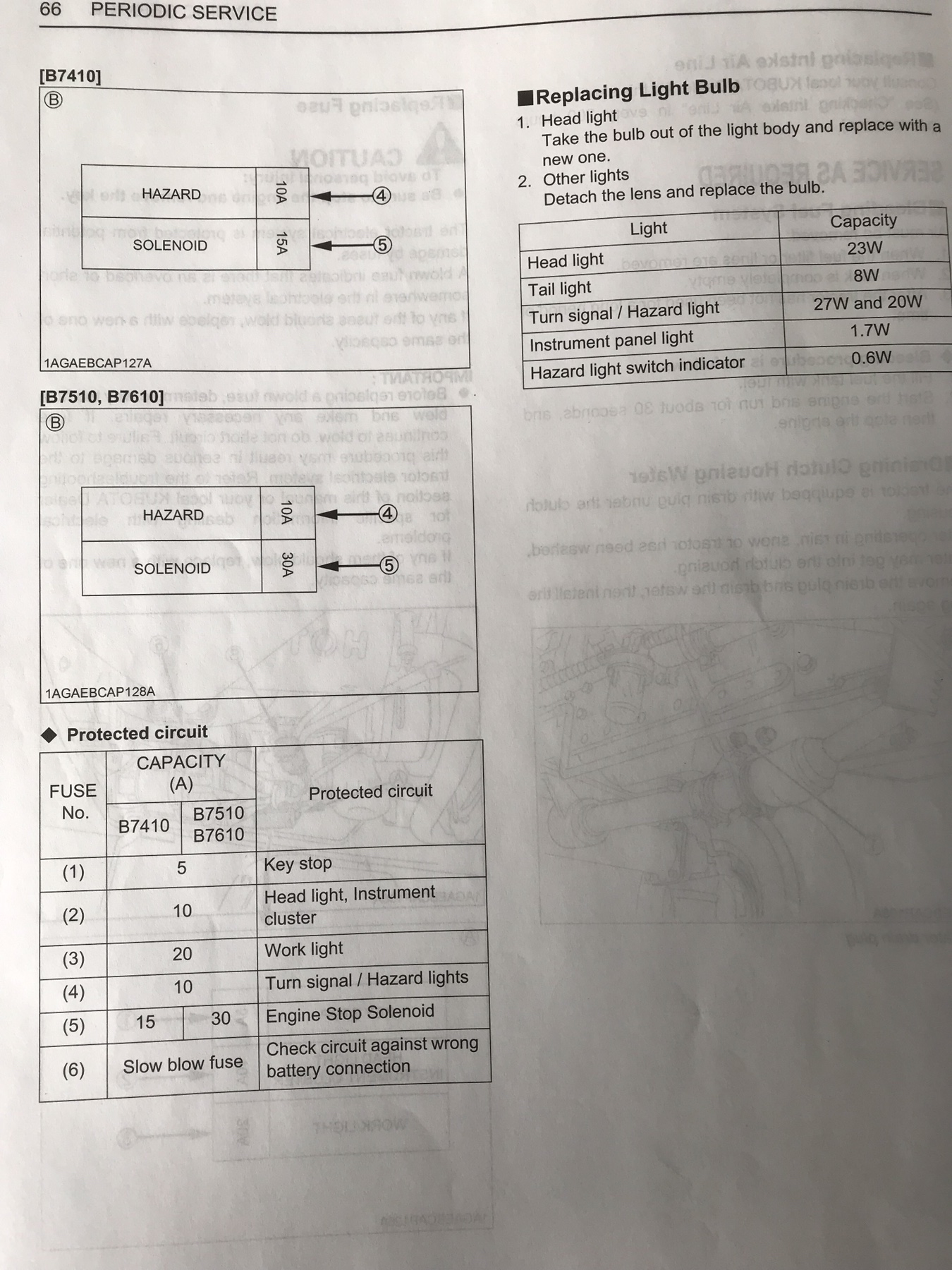

Hello all. I've had a Kubota BX2350 for about 5 years now and it has been an excellent tractor for most all my needs. I purchased a used B7500 to help out in the duties. I am having a hard time finding a manual for it as it has a few issues that need addressed. First off my fuse block had a 40 amp fuse in the first slot protecting the turn signals which was blown. That amp fuse seems excessive and I would like to know what amp fuse should be in there.

This is from my manual for a 2005 B7510. Hope it helps
