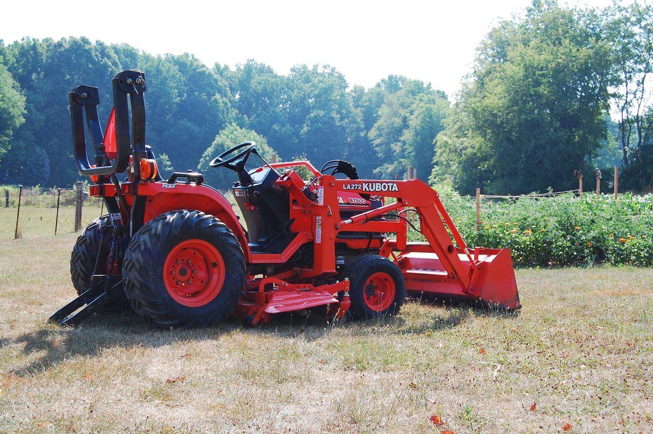

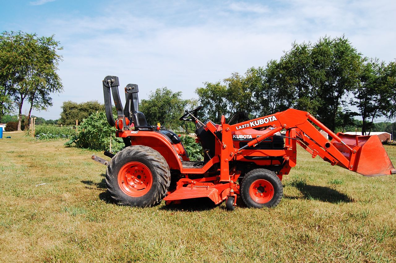

B7500 Delivered this morning . Thanks for everyone's help in my decision making process . A big thanks to Brady Barlow who was a big help even though i did not end up buying his tractor . Stand Up Guy ! .
I ended up with a 2001 B7500 with FEL and a 54" mower deck 450 hours . The dealer i bought it from did a full service all fluid and filters before delivery . My grass is dead ( we need rain ! ) so i won't be doing much mowing .

Very nice tractor setup:thumbsup:

Very nice looking set-up.
