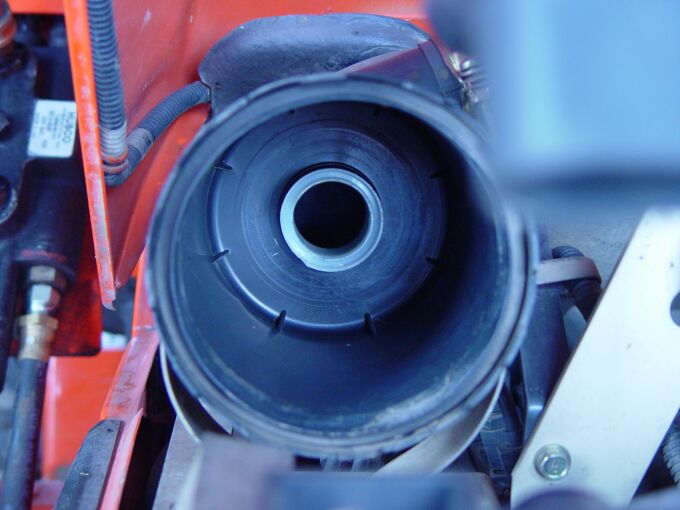

I don't know what the B2900 series filters are.
Attached is a picture of the part that I can't get out. It's the white "circle" dead center.
   / b7500 air filter
#12
picture didn't take....
   / b7500 air filter #13
I would suggest removing the rear filter housing from the rubber hose that comes off the back. The way the filter fits in the housing you will be able to push it out from the end the rubber hose is attached with a socket or something similar. I just went out and removed the filter from my B7500 to be sure. When I removed mine I was sucessful by rocking the front of the inner filter gently back and forth until it finally let go. The fit is too tight to be pulled straight out. Hope this helps./w3tcompact/icons/smile.gif

Thanks Jeff.
I know it's a simple matter of pulling the hose off. I had the clamp off a month or so ago and was going to do just that, but the way my luck goes, I usually break something while trying to fix something else.
I'll give it another shot next spring, when the snow is gone and the grass is not ready to cut yet. That way I know that I'll have a month or so to get the tractor back into operation if I screw something up!
