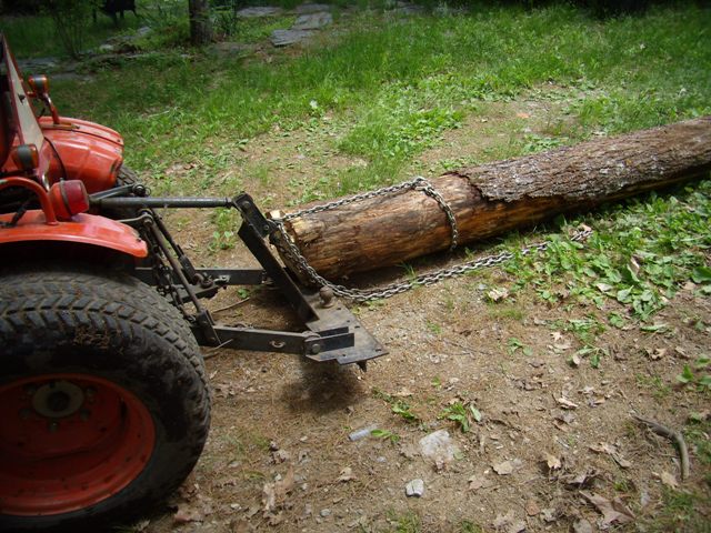

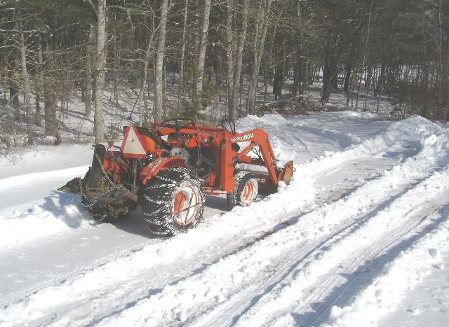

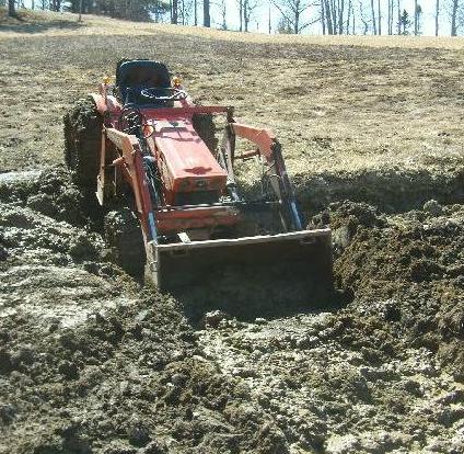

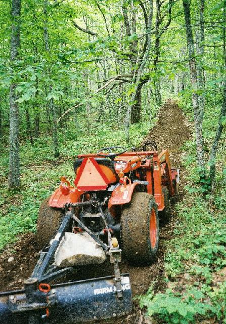

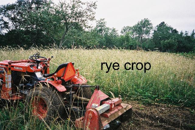

/ B7100D-HST 1986 model #11
I have owned this tractor for about 4 yrs and am now trying to understand different modes of operation.
What kind of operations are you thinking off?:D
I'll post a few pictures of a B7100 HST being used in different situations with different attachments.:D
