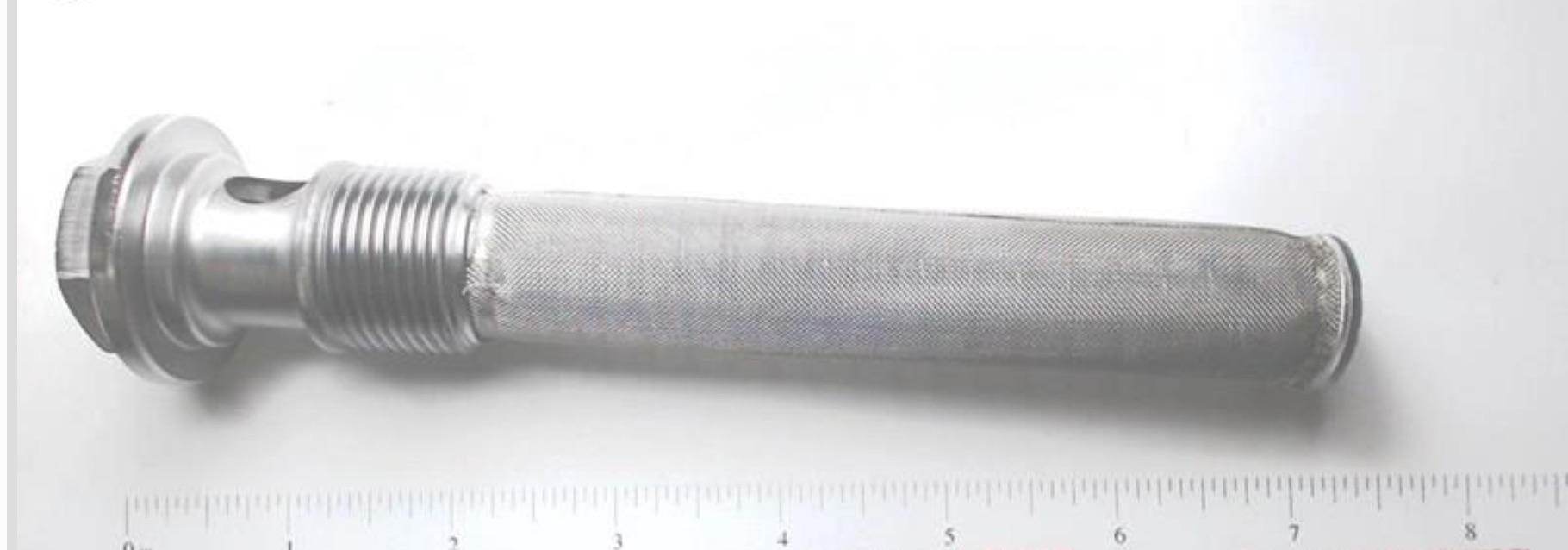

I checked at the online parts using Messick's excellent website:
Messicks | Your home for New Holland, Case IH, Kubota & More.... I order all my parts from them.
Yes, the B7100 HST has both a cleanable screen (below) and a spin on disposable can type filter for the oil in the common sump used by the tractor's hydraulics and HST transmission. Replacing the spin on and cleaning the other will involve new oil there. (UDT or SUDT type)
You also have a replaceable fuel filter. Replacing that will require bleeding the fuel system - which can be frustrating the first time you do it and is simple the second time around. But messy both times.
Those are most likely to be the cause of your problems. But even if they are not, any mechanic is going to require replacing them before looking deeper.
rScotty

I never knew there was a replaceable filter under that cover! Messicks was very helpful. I ordered all of the filters, o-rings and 4 gals of genuine Kubota Super UDT oil. If the problem is in the filter/screens, this should fix it. No worries bleeding the fuel system; between my old Ford 4000 diesel tractor and this Kubota, I have done it many times since the 1970's. 998cc
