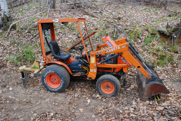

Larry;
Here are a couple of photos of a SIMS cab mounted on my B7100. I'm not sure if they're still in business or if they still make one for this tractor. Mine came with the tractor. I don't have any photos of the entire setup but I got a "bag o'stuff" with the tractor that is the soft side doors. They basically attached with snaps and domes. This SIMS cab has glass windows front and rear. The front window is mounted on two pivots that allow the window to tip backwards to allow the engine hood to open. Mine has a windshield wiper on the front but I'm not sure if it came that way or someone added it later. The rear window is fixed but easily removeable with 4 nuts and bolts.
Cheers, Erik

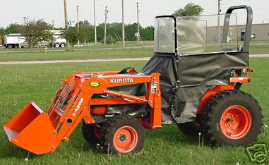

You might be able to get a Femco Weatherbreak that would fit it, not sure they make one although it is worth a try. contacting Dave Hines and see if he has one that will fit it.
His website is:
Fairview Farm Supply & Parts

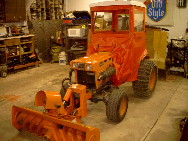

Wow! I thought this thread was dead. Attached is a picture of what I ended up doing. Bought a new Simplicity cab, reworked the mounting brackets substantially to fit, did a little cutting and resewing on soft cab for fender clearance. Fits resonably well and keeps the snow and wind off of me.

Well, this thread was started in Oct of '06, so I have one winter under my belt with this set-up. I found a new, old stock cab on ebay for $125 from a Simplicity garden tractor, I knew the model #, so I looked up some specs and determined that the size was a fairly close match. When it arrived, I "dry" fit it together so I knew where everything went. I then went through a process of eyeballing, measuring, heating, bending, cutting, drilling, twisting and spot welding to get the framework mounted. Once I was satisfied after a little "tweaking" that everything was going to fit, I rewelded where I had spot welded and then painted everything. I used all but one piece of the original frame and only had to use about 18" of 1/2 x 3 flat to get to where I wanted to be. I had to reshape and resew the cloth to fit around my fenders. The original opening for what I assume was the lift lever or chute control was a convienient opening for my hydraulic hoses. I used carb cleaner to get rid of the painted Simplicity name and had a local sign shop make me some Kubota decals. I'm happy how it turned out. Keeps me out of the snow and cold. I probably spent 12-14 hours from start to finish.

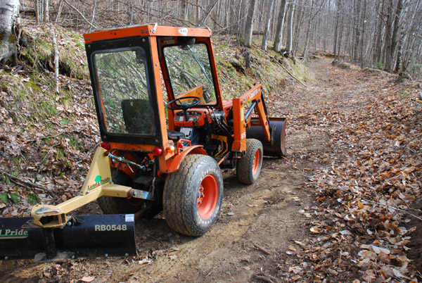

I came across a pretty nice Harris cab last night. I called the guy and he told me it came off his 80's B7100. The problem that I'm running into is if it will fit my 80's B7200DT. I did some HEAVY Googling and research and came up with NOTHING. I even called Harris-Stolper cabs in Brampton Ontario Canada. They offered no help of any kinda and told me they only make cabs for Komatsu tractors and that was pretty much it.
As you can see, it is very heavy duty and pretty very solid! The doors are lockable and removable along with the back window! Inside the cab there is a wiper motor, heater, fan, and hookup for a roof light. Is there a good chance that this will fit my B7200 ? The seller wants a good bit of money for it but I do not mind paying just as long as it will fit my B7200. I wish I had more info about the cab, but posting on here is my last ditch effort before I go and possibly bite the bullet and buy it.
