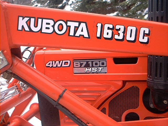

"if I bought a new b7100 hydrostatic tractor could I reuse my woods 1846 loader."
1995 HST takes
