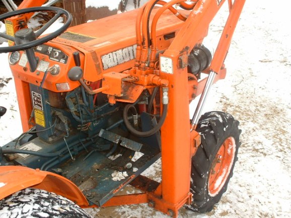

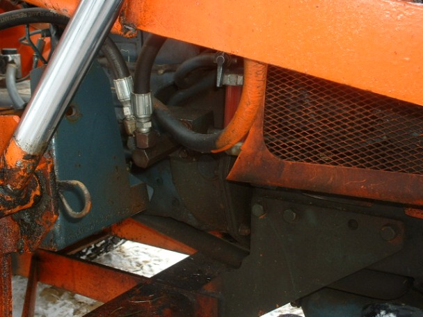

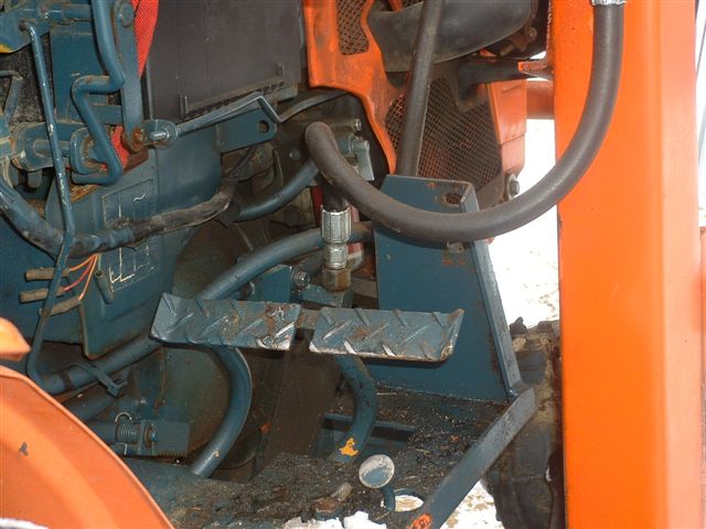

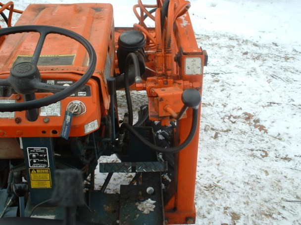

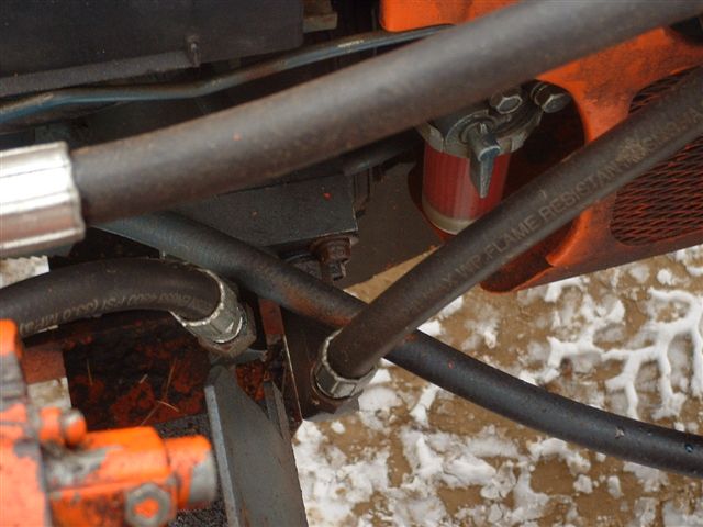

KubotainNH said:
Here's a couple pictures of the loader lever.
SWEET!!!!! Thank You so much! I think I can build one for mine now, I hate those two short levers on mine.

/ B6100 picture
#43
Now that I have one I see and hear about them more often then I would have thought. On the lever, you have to look closely to see how it all pivots. If you have any questions please PM me, I have it set to alert now... :)
