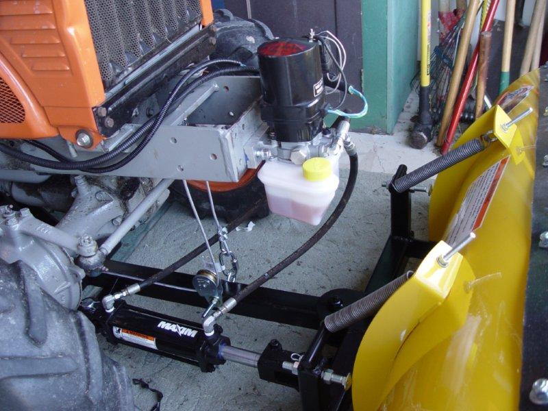

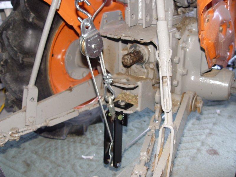

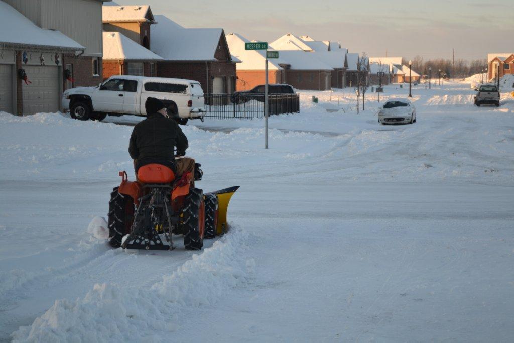

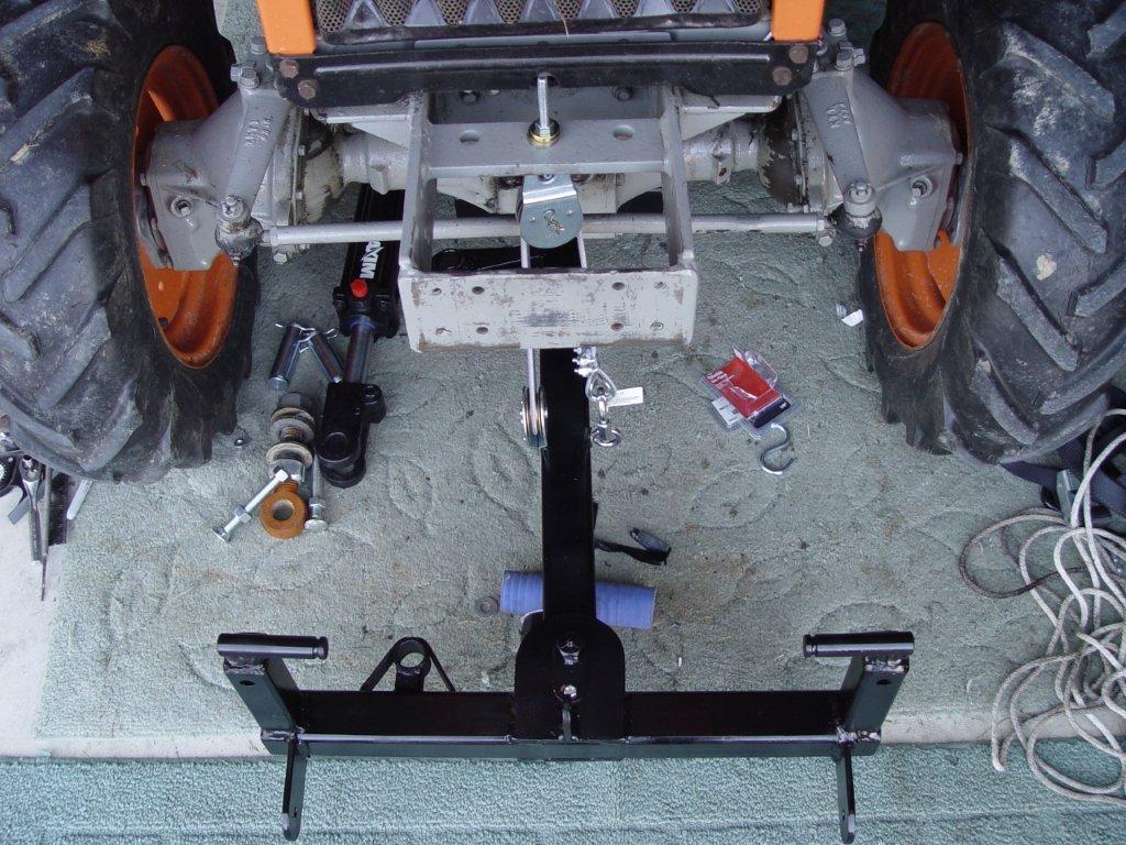

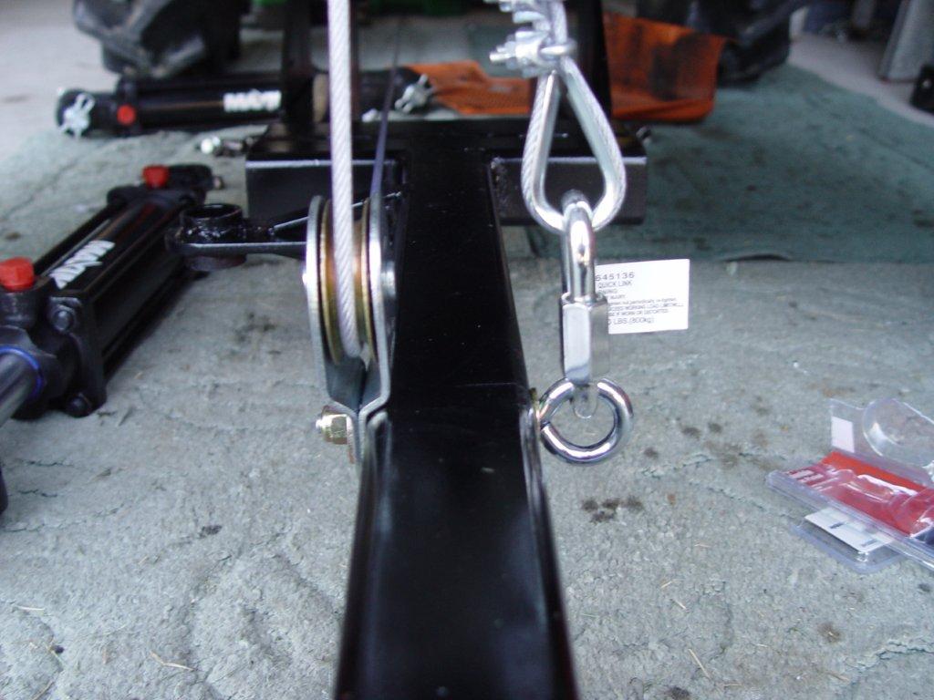

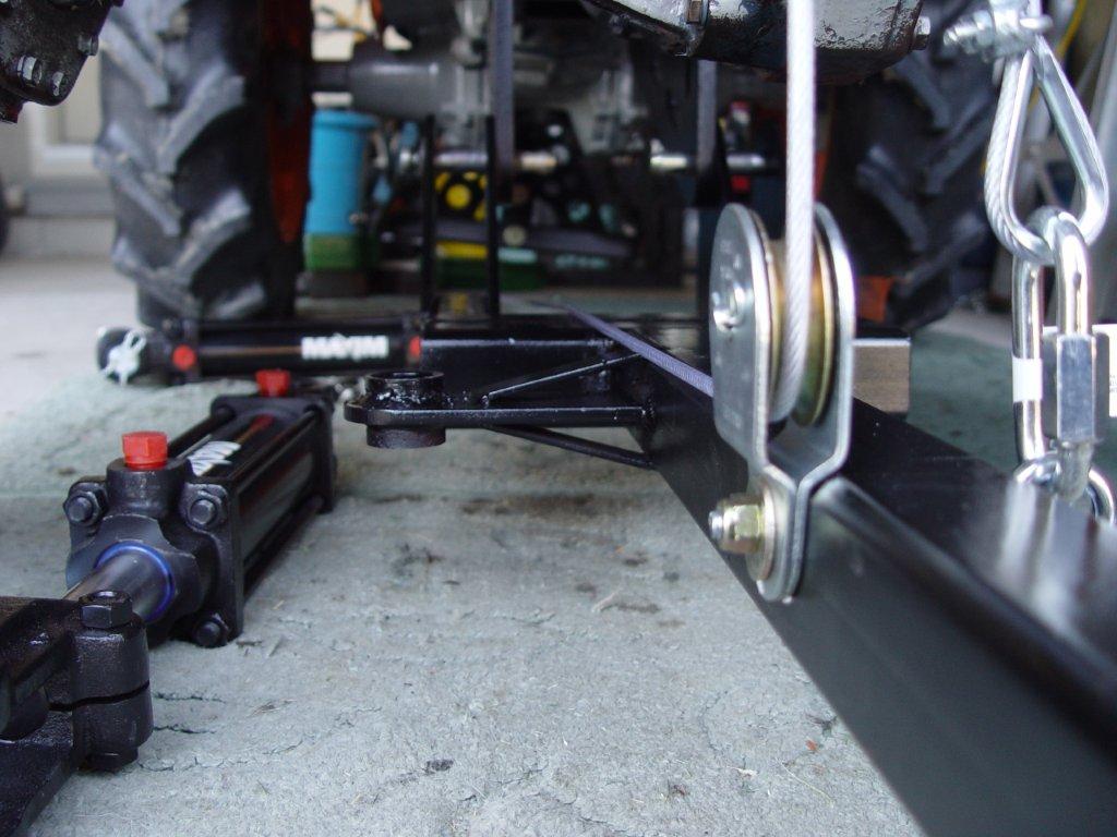

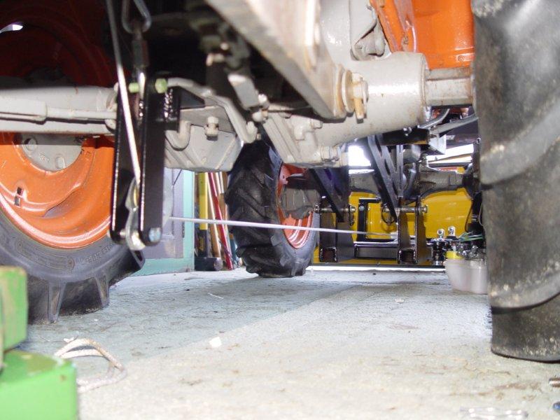

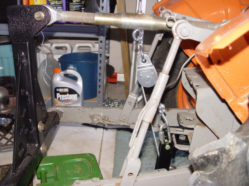

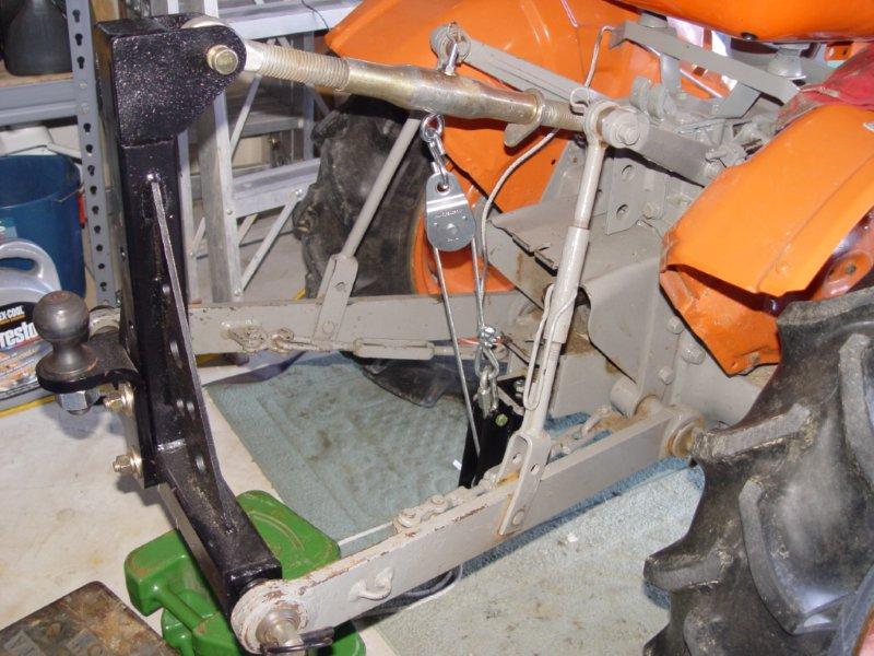

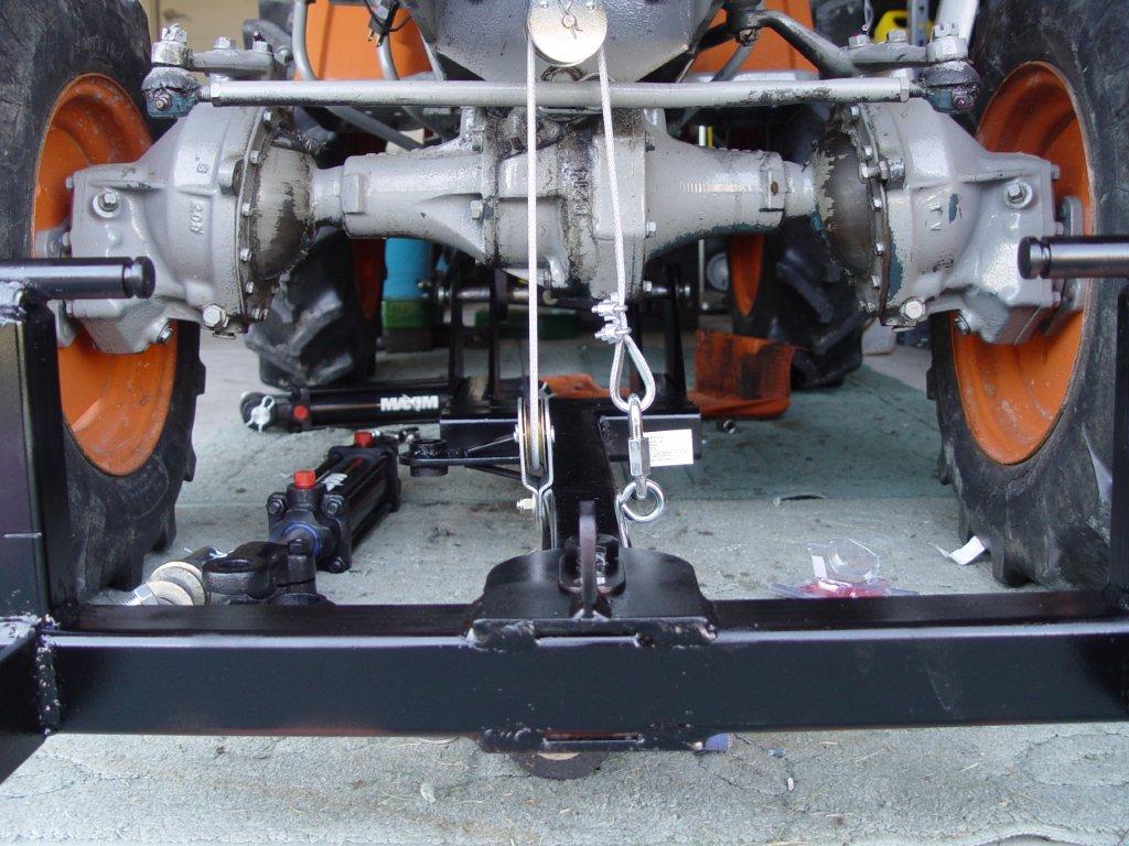

I discovered a great safety device. I had used an S-hook to hold the rear pulley to the upper 3-point arm. I was blasting some serious street ice and I tried to lift before I had backed up. Popped the S-hook. At first I was dismayed, but then I realized that it makes a GREAT safety link. I can replace the S-hook in 5 seconds, much easier than repairing cables or brackets. I rebent the S-hook and carry it as a spare.

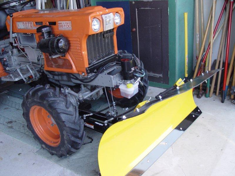

Whoa not sure if you have done this yet. no need to drill, cut or bore into any place on the tractor.
I put a hydraulic cylinder on mine using the block on the side of the high pressure. I will post pick and info later but I would not cut anything. You need a open center control valve as the fluid has to flow through to the rear of the tractor and not dead head, or it will burn out your pump as there is no bypass on the pump.
so this is where the block come in
It flows out of the block on the right hand side of the hydraulics to the control valve, then back to the same block but on the return side of the block.
your implements are then attached to the other fittings on the hydraulic valve. I will post a picture late.

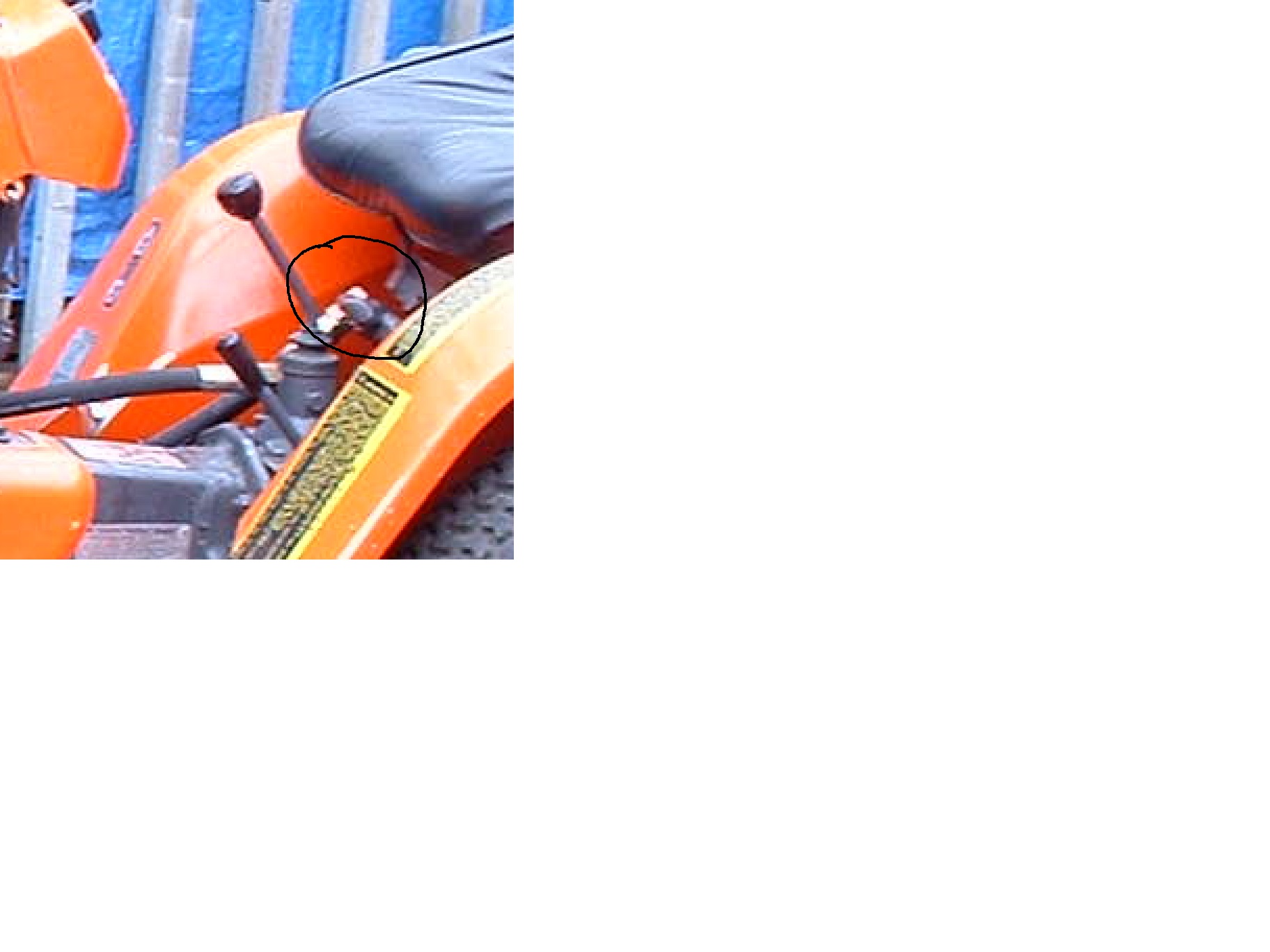

Also of note is Nostep shows a picture on his original post. It has an item labelled "Grip" . That looks alot like the selector valve on my B4200. It should have an arrow on the grip. Pointed to the left, directs flow to the 3PTH. To the right directs flow to the port on the right side of the grip. Both actions controlled by the 3PTH lever.
Not sure if my picture will be clear enough but I am far from my tractor at this time. I circled the pressure port at my "grip" or selector handle.
