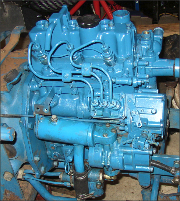

If I was looking for another tractor it would have fuel injection similar to this, but that's just me.
each to his own....
