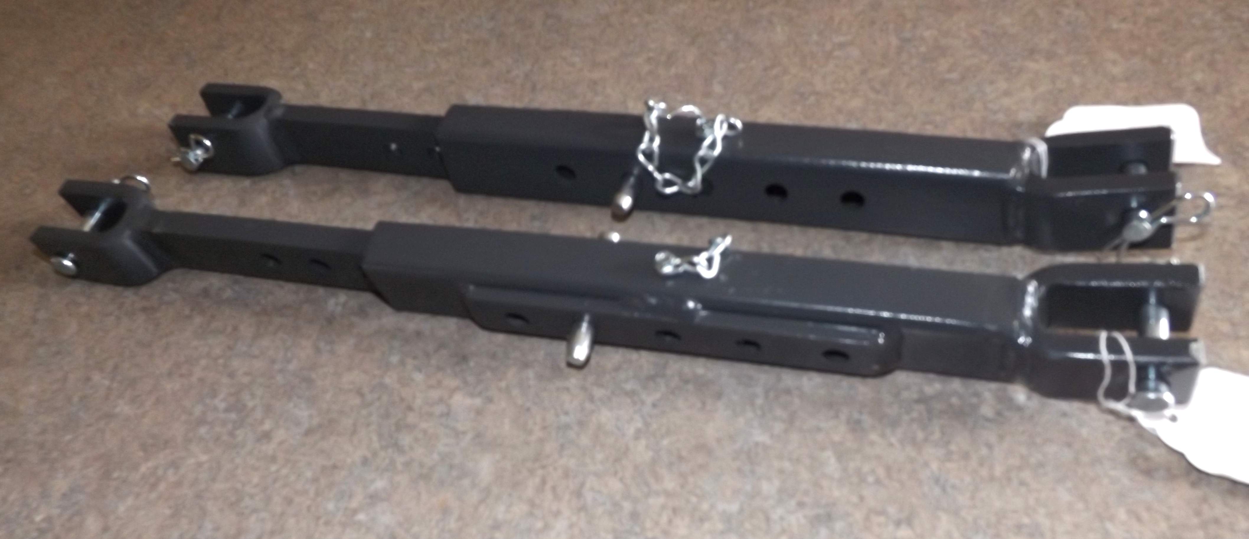

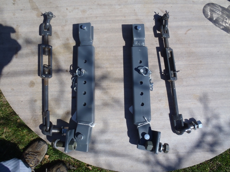

Here's a side-by-side comparison of the Stabilworks to the turnbuckles for our B2320:
   / B3200 adjustable link for 3 point hitch #18
On the Stabilworks product, I only see incremental adjustments (the pins). For some implements, I don't like to have any right & left slop, and this means tightening the threads on the lift arm stabilizer until the implemented is solidly locked in. Is this possible for the Stabilworks product? Looks like the adjustments are at least an inch apart, and this would translate to a fair amount of slop at the back end of a 4-5' implement.
   / B3200 adjustable link for 3 point hitch #19
I got mine from Mark a few weeks ago. Love them. The adjustment holes seem to be offset which allows for more adjustment than one might suppose. My old Kubota turnbuckles are hanging on a nail in the shop, where they belong.
