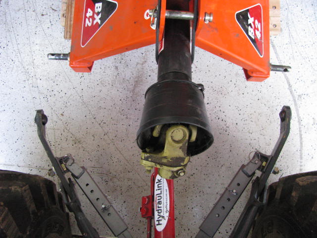

You need a set of Stabilwork's rigid stabilizers. (check chains) Not only will they reinforce the lower links but they make loading attachment into the lower link eyes easy.

The Stabilwork's rigid stabilizers/check chains having nothing to do with the lifting rods.
They will reinforce lower links when operating in reverse. Kubota check chains 3.4 pounds, reinforcing one lower link at a time; Stabilwork's mech 14 pounds reinforcing both lower links 100% of the time. With Stabilworks I can carefully push LOOSE dirt in reverse with my rollover box blade, an activity that bent the factory check chains/turnbuckles.
There are frequent occasions when I am grateful for the Stabilworks mechs when shoving my King Kutter rotary cutter into the bush in reverse.
Check out Stabilworks video. This video convinced me to buy:
http://www.youtube.com/watch?v=xeh23Csx1QM
Still, prudence is called for. Our B series Kubota tractors are light compared to an 8N. As you have found out Kubota parts are expensive.
Note that Kubota "Grand L" series ($$) have rigid stabilizers standard.

itpdk9 - the Lift Arm Leveler that you show should work, but as Jeff mentions, be sure to measure up you Kubota part & compare it carefully to the TSC one. I suspect the Stabilworks stabilizers may help reduce compression bending of your Lift Arm Leveler by limiting the directions that your implement can move when you apply a load to it, especially when pushing a rear blade in reverse. Mark has an account here and may be able to offer some advice on that score. I have a set of his Stabilworks on our B5100 and they made changing implements much, much easier than those infernal turnbuckles, so I'd recommend them just for that.

thanks Jeff and Babygrand. I guess I bent it when I was pushing in reverse :) I will look into the stabilworks as like was said, they should help on the side to side movement when going in reverse which is i'm sure why it bent. I went ahead and ordered the kubota part, and I have definitely found out that Kubota parts are expensive, and they never have what you need in stock (at least at the 2 dealerships by me).
I will send Mark from stabilworks an email but any idea how much they are? thanks again guys.

It has been awhile.......but <$200 delivered.
Mark will offer you "light" and "heavy" steel options. You want "heavy".
You will be happy you have Mark's rigid stabilizers when you PUSH a bush hog into the jungle, another "bending" activity.

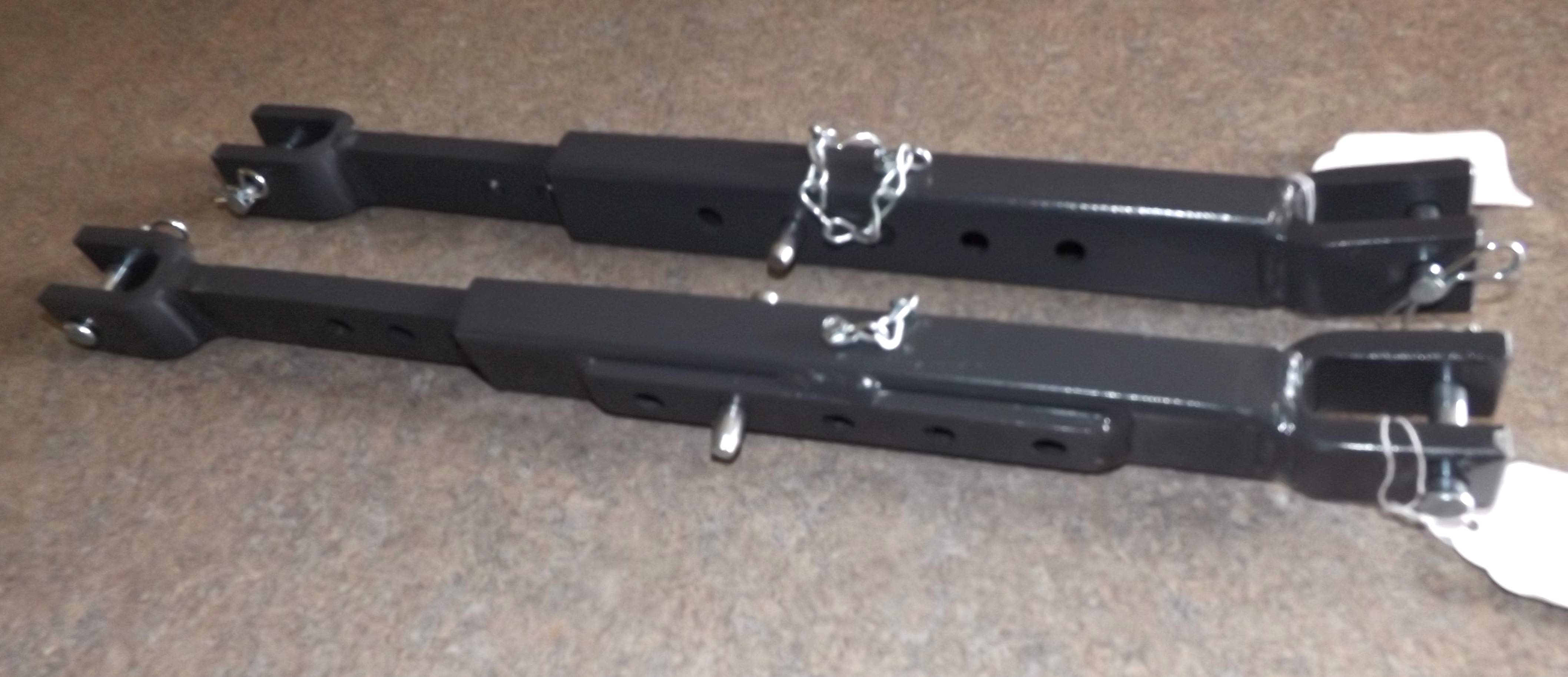

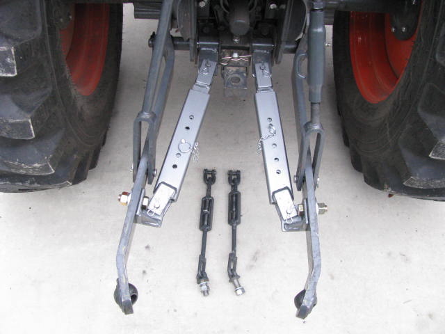

Here's a side-by-side comparison of the Stabilworks to the turnbuckles for our B2320:
/ B3200 adjustable link for 3 point hitch #18
On the Stabilworks product, I only see incremental adjustments (the pins). For some implements, I don't like to have any right & left slop, and this means tightening the threads on the lift arm stabilizer until the implemented is solidly locked in. Is this possible for the Stabilworks product? Looks like the adjustments are at least an inch apart, and this would translate to a fair amount of slop at the back end of a 4-5' implement.
/ B3200 adjustable link for 3 point hitch #19
I got mine from Mark a few weeks ago. Love them. The adjustment holes seem to be offset which allows for more adjustment than one might suppose. My old Kubota turnbuckles are hanging on a nail in the shop, where they belong.
/ B3200 adjustable link for 3 point hitch #20
Just like JEMelby's edit, I've wondered the same thing about the ability of the turnbuckles to bend when over stressed going backwards. Adjusting the turnbuckles are of no greater concern for me than the rest of hook up complications now that I have a Quick Hitch. I can see that operation in reverse could be hazardous to those parts and damage could be worse if the turnbuckle was more rigid.
