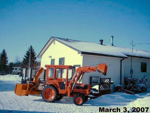

I've been running a 74" rear snow blower on a B7800 (22 PTO HP), which is the same chassis and engine as your B3030, for the past 7 winters with absolutely no power or weight problems. The secret is the HST. My only problem (and it's minor) is that I have to be very careful using the FEL with that wide blower on behind, so I don't sideswipe things.
