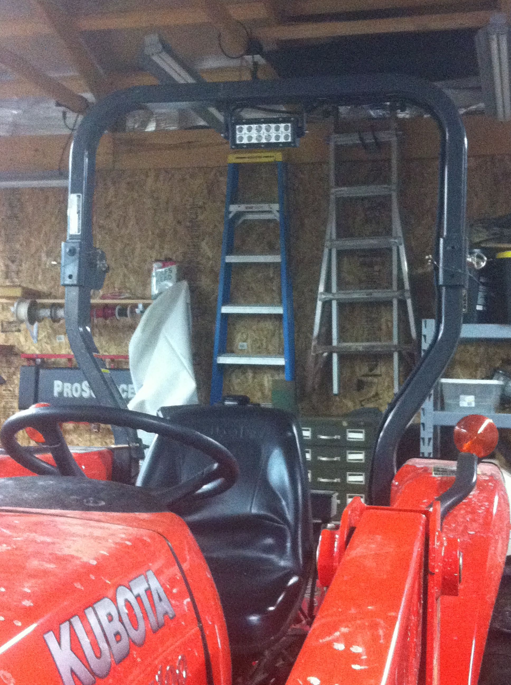

Lightbar.jpgI personally put a 6" light bar on the underside of my Rops. Makes plowing snow at night a breeze. It is unreal how much light I have to the front and sides and I am pulling so little power that is a nonissue. I would say it was the best $65 I ever spent on the tractor (that even included my wiring harness and switch)
