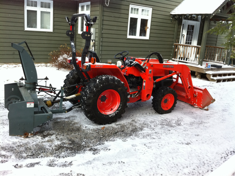

I have 4 LED 27 watt flood lights on the ROPS of my l3400. Two facing each direction. They are amazing. Great for back hoe work, snow blowing and also loader work. Not sure if my machine has a larger alternator that a B3030 but I have never seen any dimming of the head lights ever. They are worth every penny. Make sure you buy them with a solid aluminum housing. I made one bracket that holds two lights for each side. Not sure if you can see them in the photo.

Make sure you think through the mounting position. Inside may make it difficult to fold down the ROPS. I wired each light with a simple two wire male/female connector so that with undoing 4 nuts the light will come off. I run through some over grown trails but have never had to remove the lights. That's why a solid housing is important. Also, the further apart the lights are the better they work. Good luck!

where did you pull the power / ground to run the lights? i never have folded my rop's after 575 hours, they are pretty scratched up from all the brush I have cleared and still have lots to go. short of mounting them on me, inside the rops is going to be the closest thing to safe i can hope for.
