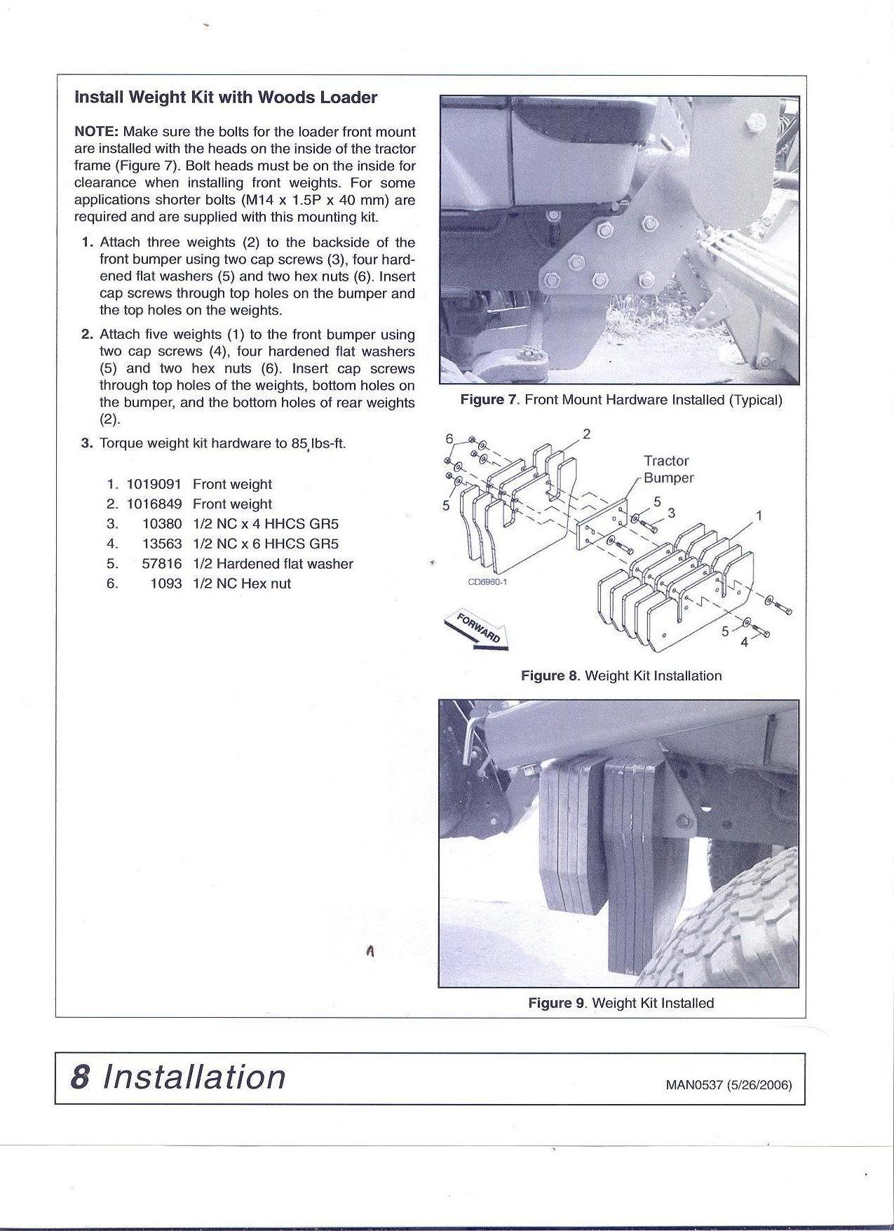

I've been trying to avoid this discussion, but I do have some input. Kubota's attachments are some of the best intergrated in the CUT market. Now, before anyone gets up in arms about that consider these points. The reason that Kubota backhoes don't work with cab models is that they are designed to sit as closely to the tractor as possible. The design intent here is to keep the whole assembly as well balanced as possible, and to spread the forces the backhoe creates evenly to the tractor frame. Since aftermarket hoes are designed to fit a variety of tractors this can't be done, and they end up adding weight to the front of the tractor in many cases to offset those forces, and the extra overhang they have in the rear. (See pic of Bh70x installation weights) That extra power, and strength comes at a price. In this regard, I think that Kubota, and Honda are very close in design philosophy. Other attachments like mid mounted mowers, front quick hitch attachments, etc. are sized for the tractor they go on, and are very well intergrated. See how many tractors there are out there that can be delivered with the loader, quick hitch (with front blade, snowblower, etc. installed), and backhoe all mounted at the same time. Or loader, backhoe, and mmm for example. The Kubota tractors we are talking about are not heavy tractors, and I think that Kubota engineers understand very well how the forces the implements produce impact the integrity of the tractor itself.
There is another side of the coin of course, and like Honda, Kubota engineers often make arbitrary decisions about what is important to the customer, and how that impacts the cost of things that JD for example might well add. The light in the cab, 1/4 inching, and those kind of things are examples. It is a basic "lean manufacturing", or "Toyota principle" form of manufacturing / design philosophy that is deemed necessary to be successful in a manufacturing environment these days. Some companies have developed graphs that show the things customers request down the left side, and the cost associated with providing them along the bottom. Where those lines cross is deemed the cut off point for features offered on those products. Consumers can influence those options greatly by letting the manufacturer know that those things "affect my buying choice". Believe me, manufacturers will listen when they know that.
Other companies provide more "features", more advertised "strength", heavier designs, etc. on any particular attachment. They have to to gain market share, and will take risks to accomplish that. If we think about the design of Kubota tractors WITHIN the design philosophy embraced by that company ( light, strong, reliable, and well intergrated units with nothing not necessary to accomplish that goal) we find very little to complain about. There is absolutely no doubt that there are other well designed products out there, and the new Woods "X" series backhoes are great examples of those. The bottom line is that you pay your nickel, and make your own choice about what is important to you. I worked with engineers in a manufacturing environment for a very long time, and have made my choice.............
