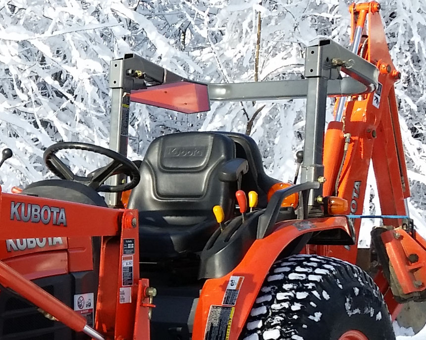

Anyone have a really good...relatively low costs replacement seat for the Kubota B3030 tractor? As time goes on I find I dislike the standard seat more and more and would like to replace it.
Part numbers and price if you have them. Thanks a lot guys
sully

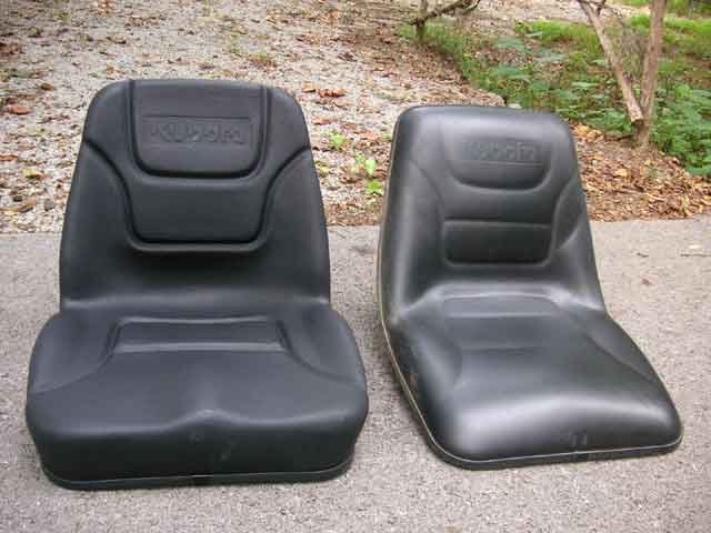

I'm in the same boat as you with the B3030 seat. It's a nice seat except for the fact that the seat back is angled way too far back. In fact, my back doesn't even come into contact with the back of the seat so I'm basically sitting on a padded, square bench. There are a lot of old threads on TBN regarding the poor seat designs for mid-2000's era B-series Kubotas. Here's a picture from one of them:
My seat looks like the one on the right along with folding armrests on each side.
My tractor is from 2007 or 2008 but I didn't buy it until 2010. There was talk in some of the threads about a B-series seat buyback/exchange being offered by Kubota and/or it's dealers but I think that deal was gone by the time I had the tractor.
I'm guessing your seat matches the one on the right; the left one looks pretty darn good. Hopefully someone can offer up a good replacement option for us. Surplus Center has a Kubota replacement seat that looks similar to the left seat for $92.00 but the B3030 is not on the list of tractors that it fits.

The buy back program mentioned above is over as I investigated this last year when trying to help my Dad out with his BX2200.
Ended up buying the "buy back" seat which is similar to the seat on the left. Also bought the folding arms to go with it. Dad claims it is a big improvement over the old seat (6 months usage so far). Old seat looked similar to one on right in the above link. It's a bit expensive and was slightly over $300 w/arms.
