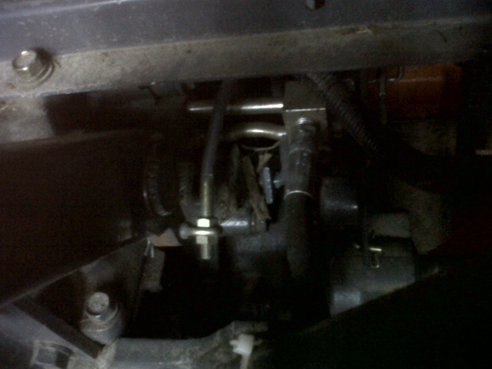

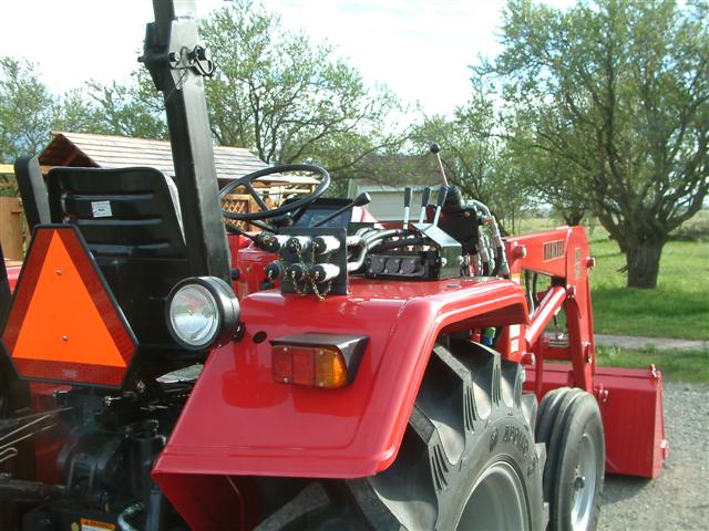

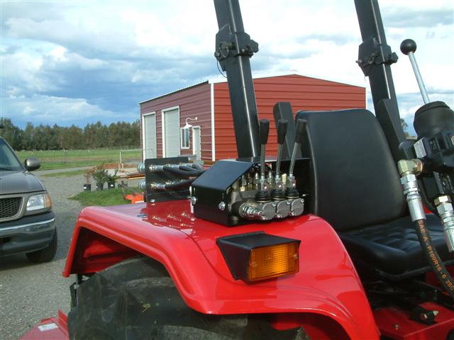

PB = power beyond. It's a port on the FEL control valve that you use to add your remote hydraulics. There's a cylindrical sleeve that is inserted into the PB port that diverts the flow to the remote hydraulics.
BTW: the prices some dealers charge for add-on remotes is ridiculous. When I bought my new 2008 Mahindra 5525, my dealer installed triple remotes for $800 including all valves, hoses, fittings and brackets.
Here's my remotes. It helps a lot if your tractor has nice, large flat-top fenders.

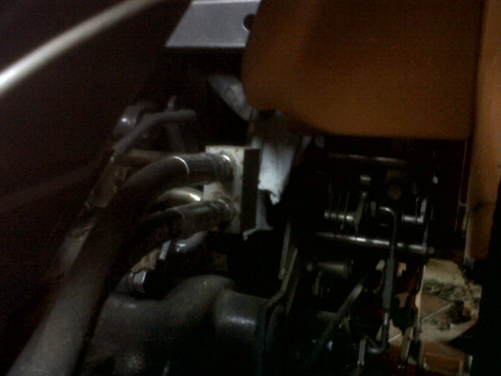

Gary,
I have attached some pictures of the Power Beyond block I have installed on my 2000 B2910.

Gary,
I have the rear remote (x2) kit installed on my B3030. The PB off the FEL is for an open circuit such as the BH. The rear remotes take off on the right side rear of the tractor. The biggest problem I have is the second set of remotes are very difficult to connect and disconnect. Kubota uses a push to connect and pull to disconnect.
The problem is more so with the lower set of remotes, the hydraulic lines are so short and so close together that they do not have the room to move back and forth to allow connecting and disconnecting.
I spent considerable time finding a hydraulic line routing solution but ended up having to angle the mount for the second remote in order to get the freedom of movement for the hydraulic lines.
A picture is worth a thousand words and if you find the same issue I did I would be happy to post a picture. On the other hand, if you find a solution, please post your rear remote mounting solution.
Bob
