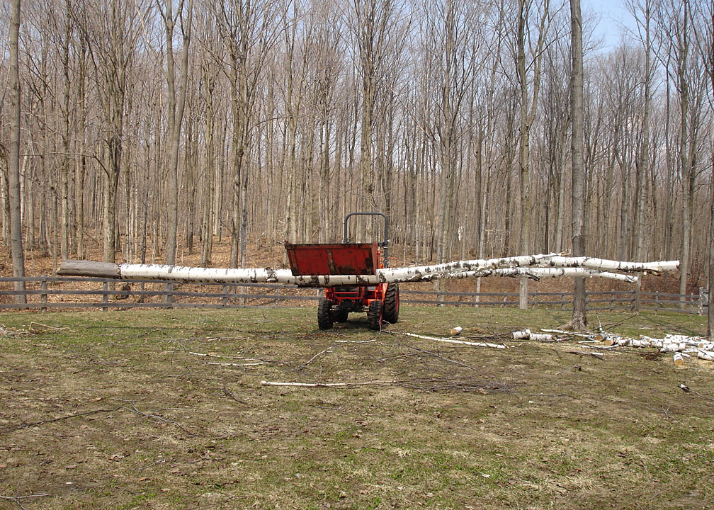

Lift capacity is not a problem. I can still lift a full bucket of gravel without trouble.
Thanks for the feedback. Sounds like he will be good to go.

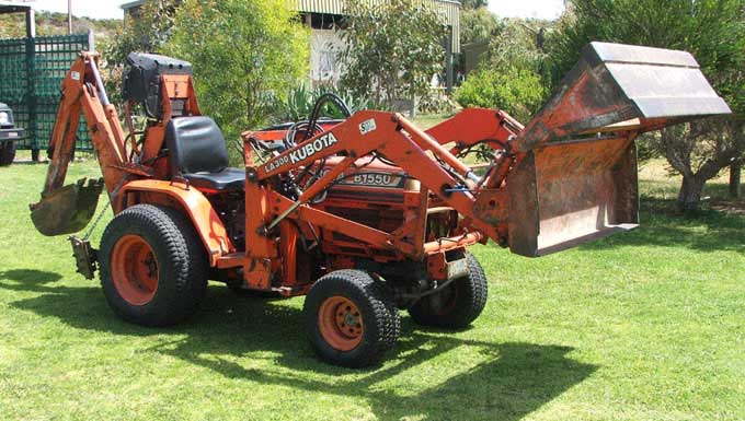

You know me too well. I am still strugling with buying a fel for the B1550. You got the hot set up buying it already set up. At this point it is hard for me to justify spending $3500-4k on a fel with 4-1 on an 18 hp tractor that I will likley upgrade some day.
Anyway, getting back on topic, thanks for all of the feedback. I realyed all of your feedback to him this AM and he was very grateful. I think he will go ahead with the purchase. He seems to be the only person who doesn't know that yet. Everyone else that knows him is just waiting for him to pull the trigger.
Jethro. $4000! Eeek! no wonder its a tough decision. Heres a few pro's and cons.
The 4-in-1 is definitely heavier - including hydraulics, mine is 3 to 4 times heavier than some of the standard buckets I've seen, so I suppose lifting power must be reduced, but so far that hasnt been a problem for me as I havent had to move any heavy sand or gravel. For lifting dirt it's got plenty of power although one minor gripe with mine is that it doesnt seem to curl back as far as i would like. The weight of the bucket is perhaps more of a concern with regards to rear wheel spin. I've got a backhoe and a flat block so I dont have much of problem, otherwise I think you would want some extra weight on the back for sure - especially if you have turf tyres. On the other hand a bit of extra weight up front does have some advantages if you are trying to squash a pile of rubbish or dragging back (using 'float') to level some dirt. Of course youve got more plumbing to potenially go wrong.
The advantages of the 4-in-1 are huge. For cleaning up scrub its amazing. Even my little B1550 rips out and carries big bushes and small trees with ease. The grapple drags big rocks, branches and awkward lightweight rubbish back into the bucket that would otherwise be impossible (for me) to scoop up. The grader blade is good for levelling dirt piles or cutting into tough, turf covered soil (but its an art to do it smoothly - one that I havent mastered.). With the grapple fully opened, and the bucket in a slight dump position, it gives you an extra 3 feet of reach and height which is handy if you are pushing into scrub or tidying up or compressing a rubbish pile. The extra reach keeps your front tyres and radiator (and you) away from branches, sharp rubbish etc. The opening bucket also makes dumping stuff onto high piles easier, or for dumping over the side of a high sided trailer.
These are just some of the advantages of the 4in1. The more I use it, the more tricks I learn, and the more I like it. $4000 is a lot of dough but I'm sure you'll love the extra productivity especially if yours is a 'work' tractor. (How many new Bobcats do you see these days with an ordinary bucket?). Hopefully your friend will buy the B3030 with the 4-in-1 and you'll be able to give it a good 'test' workout.
