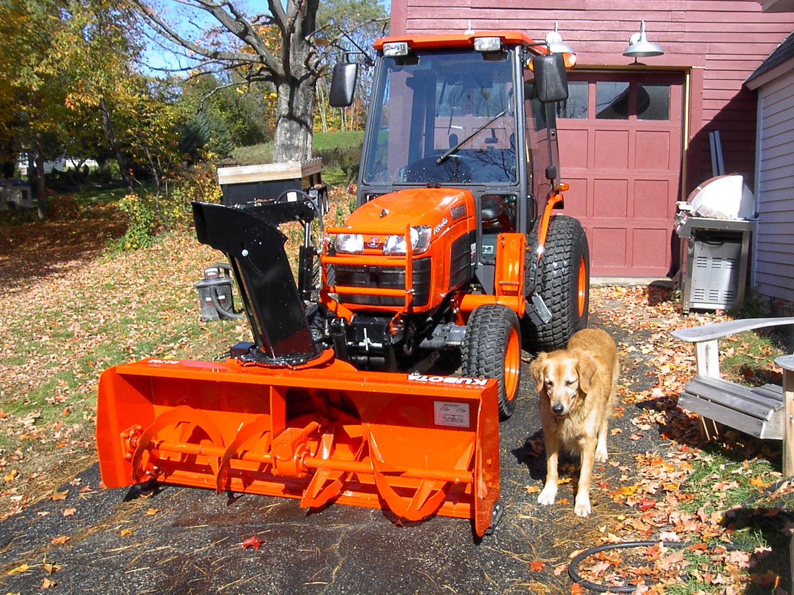

Couldn't be happier :D We're just waiting for the snow now.
