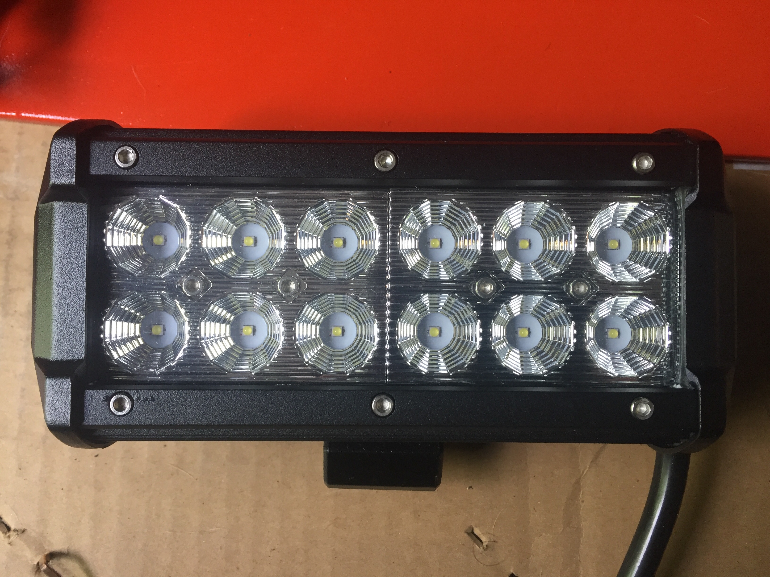

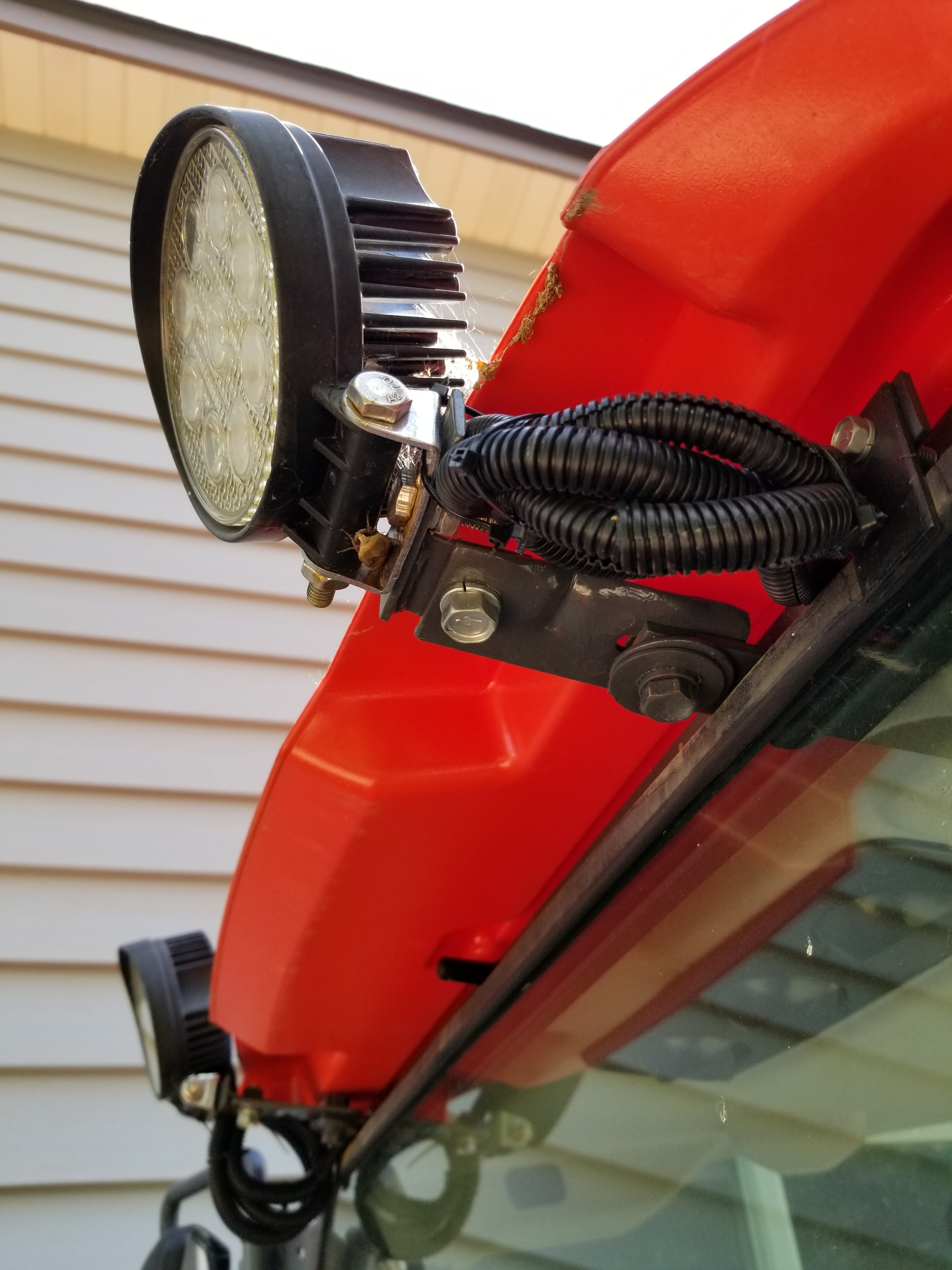

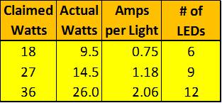

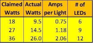

/ B3000HSDCC Lights/ Electrical "Relay" ? #3
If you swap out your halogen work lights for LEDS you will not have to do anything except remove the old and replace with new. The wattage claims of the LED lights is overly exaggerated. I've measured a number of different ones and haven't come close to the claimed current draw.
I changed out the cab lights on the B3030 (very similar to your B3000) without any issues. Since the stock lights were not going to be used, the wire lead was removed and soldered to the new LEDS to make it a plug and play. Did have to make a small offset bracket to lower the LED a bit to protect from limbs. 1x1/8" flat stock bent in a vise worked perfectly.
The 36 watt style worked nicely to replace the Kubota ones.
Remember the halogen bulbs pull approximately 55 watts each and the 36 watt LEDs only pull 26 watts or a bit over 2 amps. (See attachments)
Hope this helps

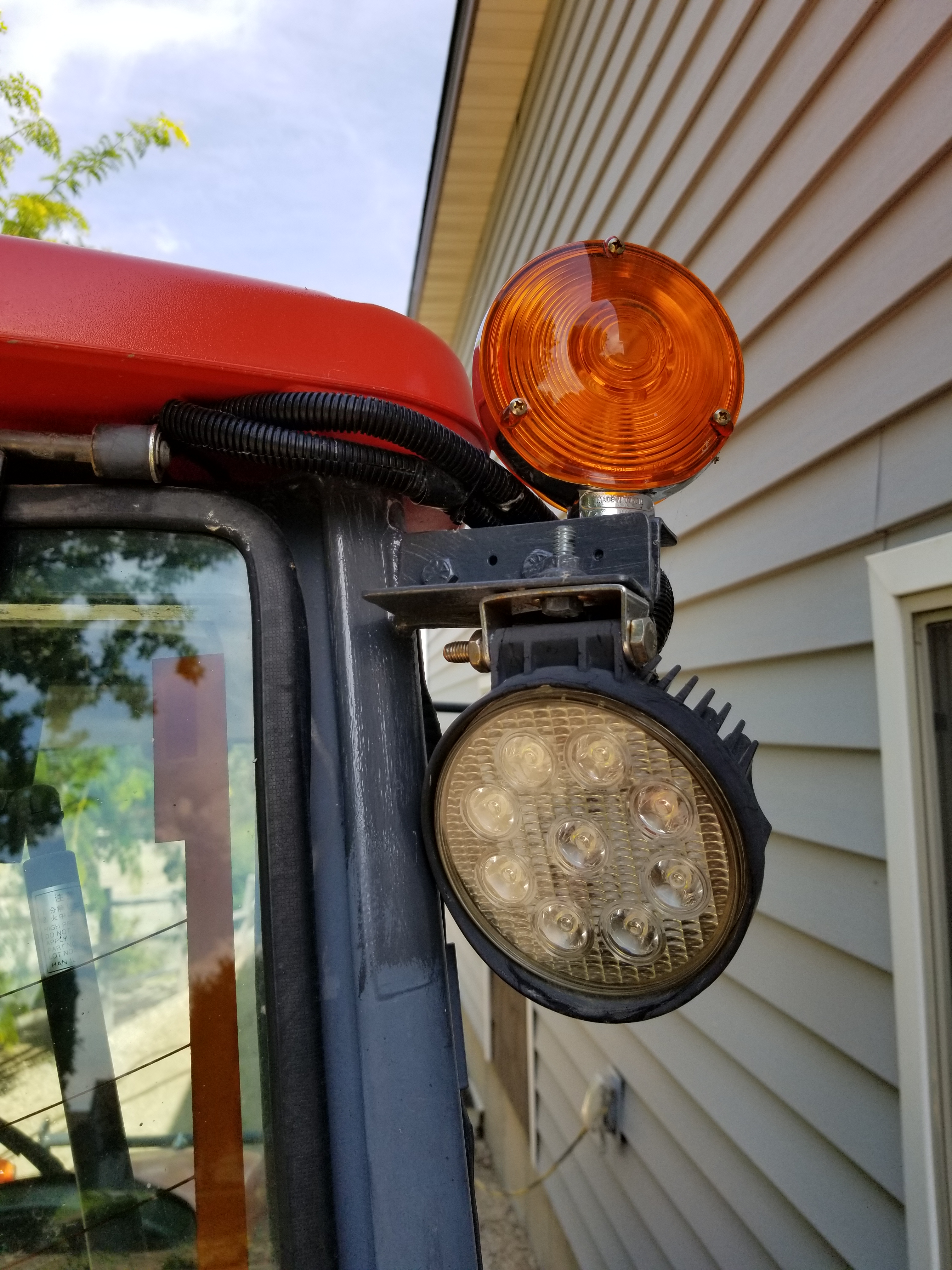

/ B3000HSDCC Lights/ Electrical "Relay" ? #7
I used insulated spade connectors and installed them in place of the factory connectors and installed them on the lights as well. Makes a simple connect and disconnect operation if you need to remove the lights for service or ???
When I installed the insulated spade connectors I made sure one male and one female connector was placed on the tractor leads and of course one male and female connector on each wire from the lights. Then hook up is always the same and no polarity problems. Some LEDs are polarity sensitive.
I also used 35 watt LEDs and there is no relay or unique hookup requirements needed.
