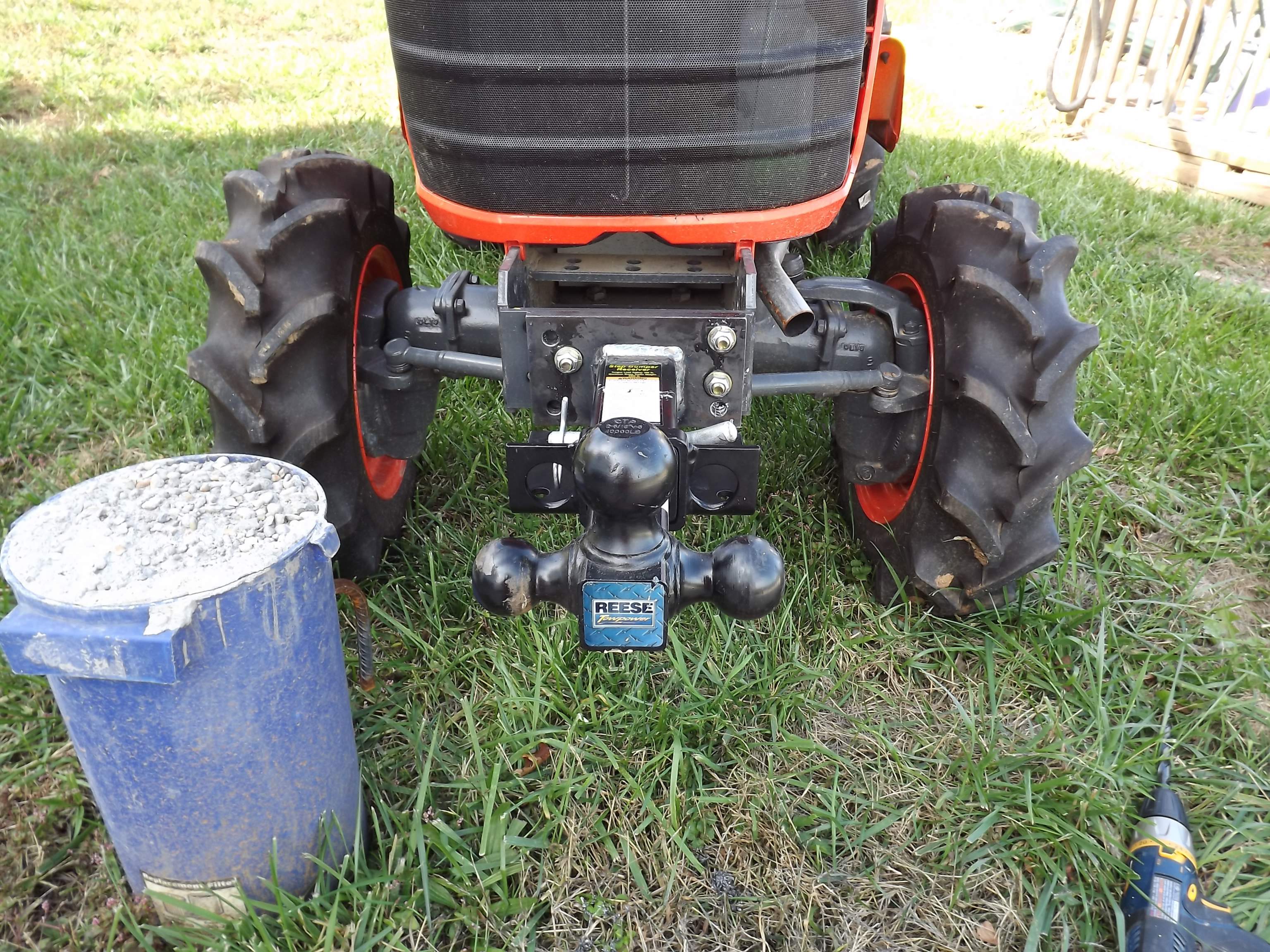

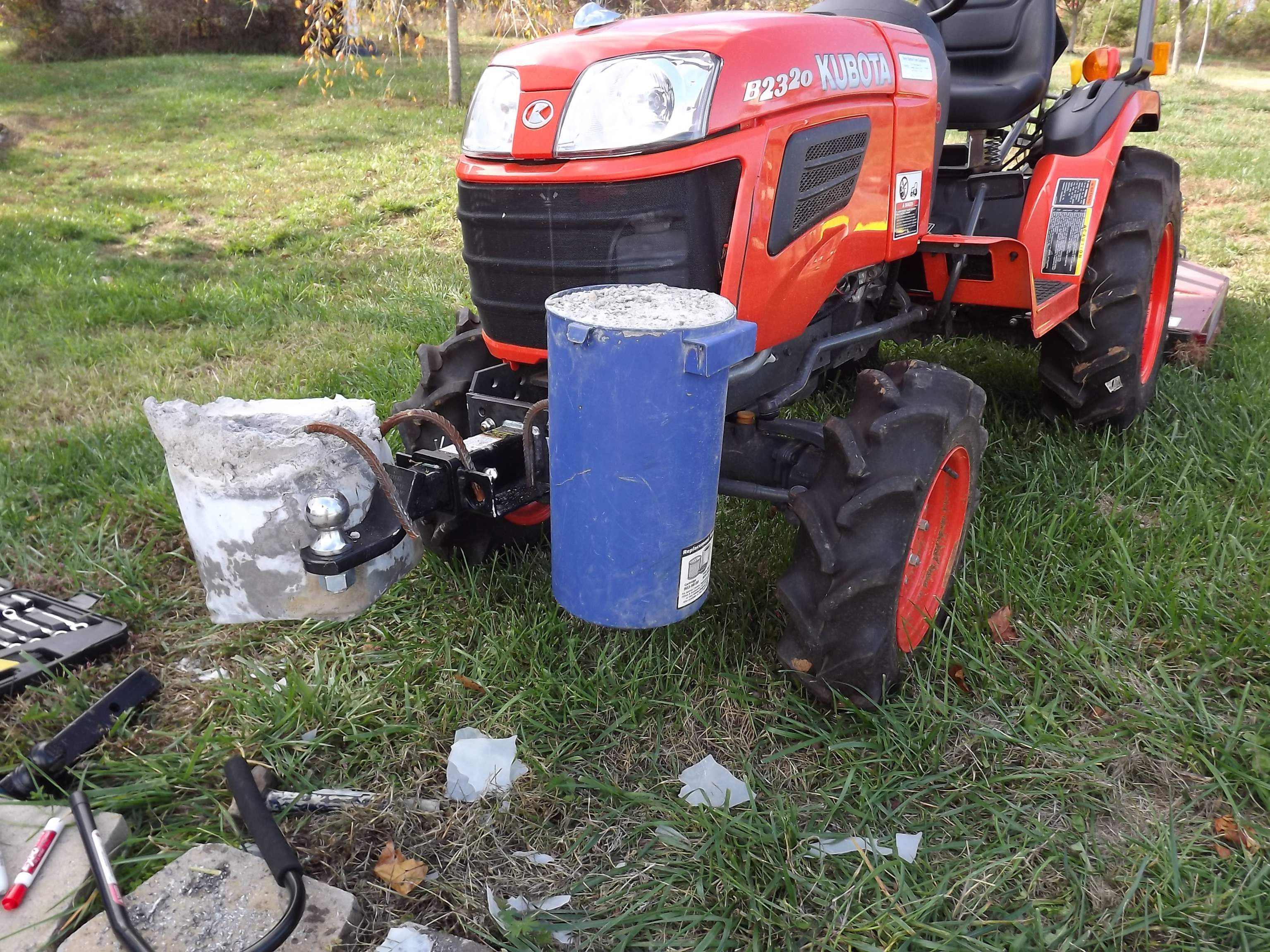

Made my own for B2320. Sakrete, bent rebar and something to hold Sakrete till it hardens. Can also use weights from weight lifting bars, Thrift stores and yard sales have them cheap.

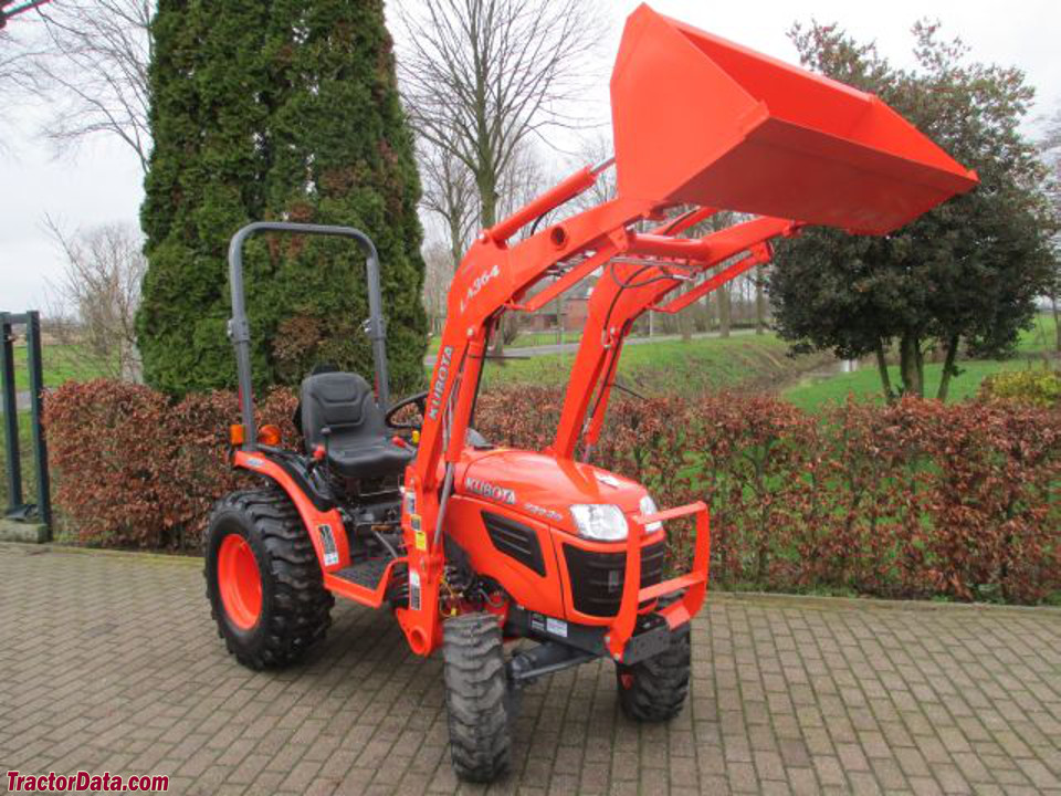

No, not the case at all. See attached photos. The B2920 photo (having the loader up high in the photo) has a part of the frame that is about 4 or 5" high, a foot or so wide, and flat facing forward. The B2150 photo shows a very similar part of the frame, also flat and also facing forward, with various bolt holes, etc. I have 2 of the B2150s and have a set of Kubota suitcase weights that simply hook onto that flat forward facing part of the frame. Each one is 55 lbs and I have 3 that fit on at the same time.
I can't see any reason why your B2920 would not accept the same suitcase weights as-is with no adapters or brackets. If you have trouble finding Kubota weights take a look at Suitcase Weights - Lonestar Weights Also I see quite afew being offered on E-Bay. There are no doubt many sources and you probably don't care if they are orange ...Essentially all of them are designed to just "hook over" a flat front facing steel plate, in your case part of the frame of the tractor. You could probably bolt on a 1/2 inch thick steel plate (that would be a lot wider than your existing frame member) and put on several more weights if you felt you needed them.
