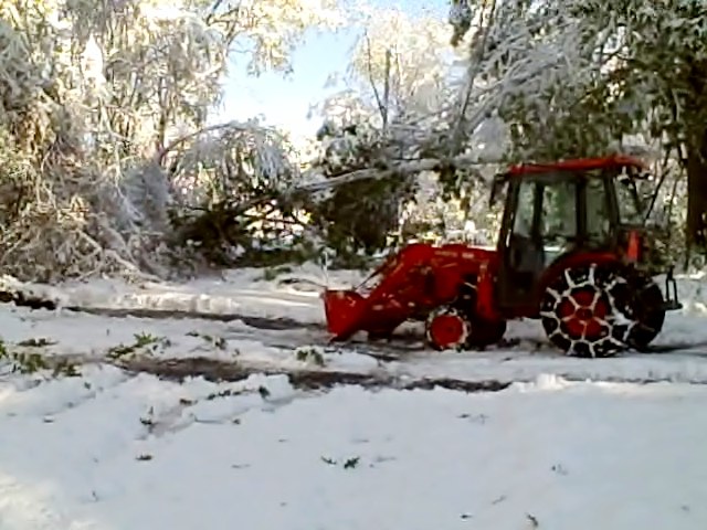

I'm no expert, but I think it's normal. My B3030 is a dog in high range going up any type of big grade. High range, in my opinion, is made for level flat land when not carrying any kind of load.
Hoping for a little snow tonight, hence the pic.
