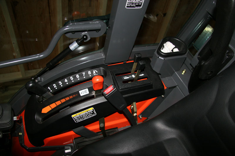

Interesting. In the second picture you can clearly see the plastic block-off panel where i'd expect the factory remote levers to come through. I don't own a 2X20 series tractor, but i would have expected Kubota to have rear remotes like the 26 & 3030 tractors. Why else would they have the same panel for the levers??
Here is a pic of what i would have expected it to look like........

/ B2920 Rear remote kit #13
Hey Ductape,
Did you install the rear remote yourself or was it part of your package when you bought your tractor, I am assuming that you have a 3030?
Thanks.
/ B2920 Rear remote kit #14
Sorry eb, but that is a pic of another members 3030 that i robbed off TBN, though i do hope to add remotes to my 3030 by next summer. :mad:
