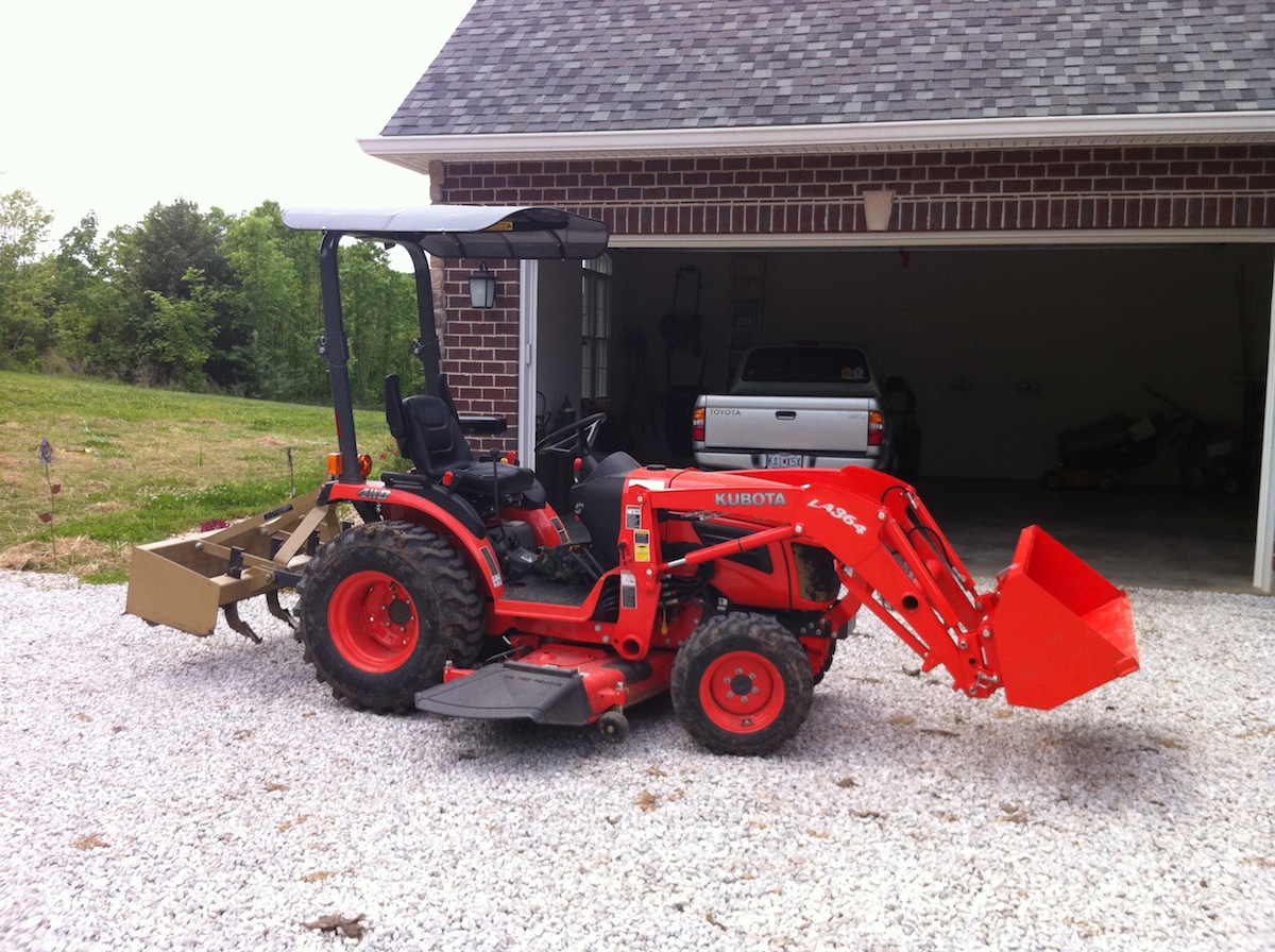

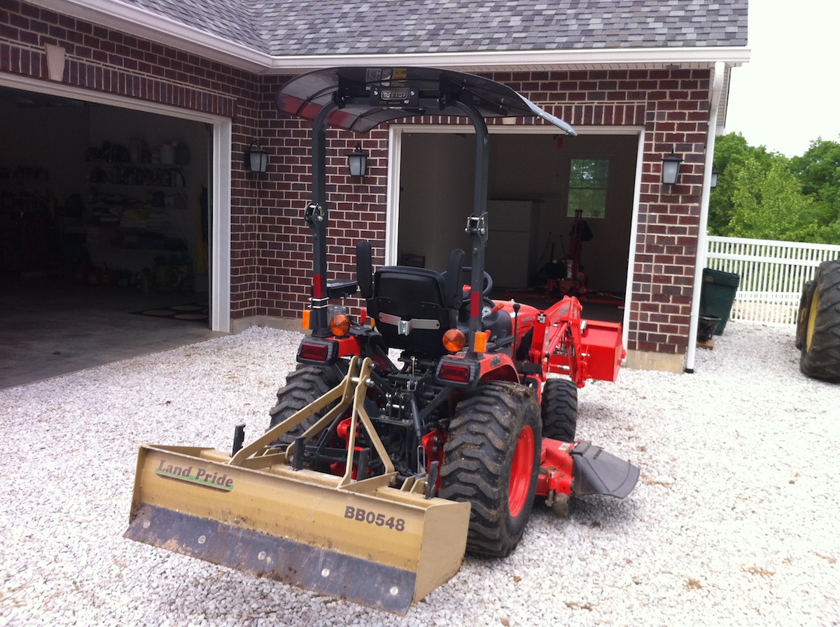

The transmission on my new B2920 is starting to worry me a little bit. It's making a loud creaking type noise when going up slight inclines or working with the box blade. It's in low range, 4wd, with the BB and FEL attached at around 2700 rpm. It's not being worked hard at all.
I'm familiar with HST whine from my BX2360. This doesn't appear to be the typical HST whine.
I have an audio file but I guess it can't be uploaded to the forum.
Any guesses? Normal?
On a positive note I just installed a Tuff Top Canopy and the Kubota Quick Attach. Pretty happy with the results.
