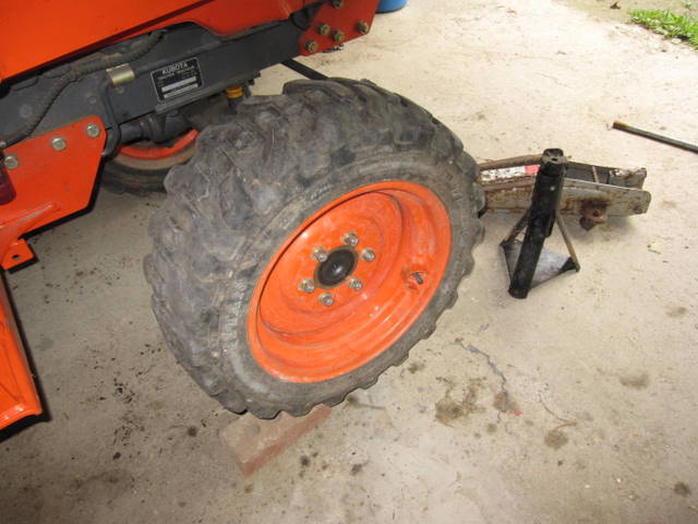

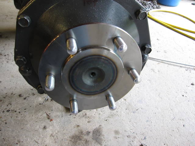

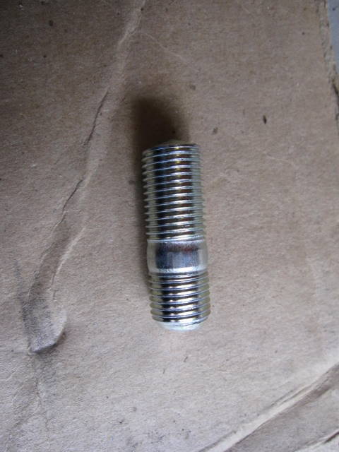

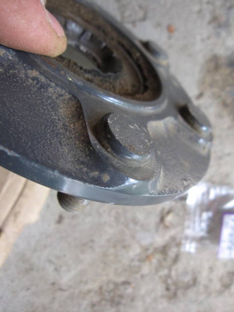

Kubota re-designed the axle hub. The old studs were pressed on, the new ones screw in.
   / B2910 front wheel snapped off!
#84

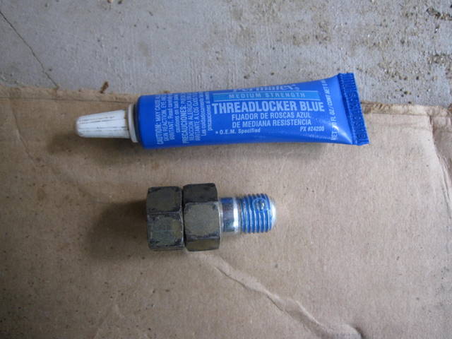

When I do get the new studs, how do I put them on? Do I take 2 of the nuts and screw them all the way on the stud and then screw the stud in to the hub and crank down on the 2 nuts?
   / B2910 front wheel snapped off! #85
That sounds about right. The stud should have a long and a short treaded end, the short threaded end should go into the hub. You might want to put some locktite on the threads that go into the hub, it will keep the stud from coming out if you have to remove a wheel.

You can see they are just threaded studs. No taper. The wheel is held on with a lock washer and a nut.

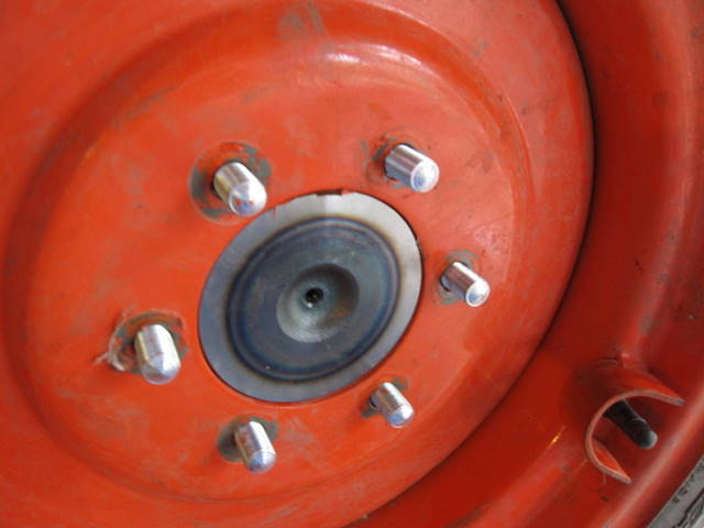

Back in business!
The first pict is one of the new studs. #2 is the old, pressed on stud. #3 Stud ready to go on with loc-tite. #4 Double nuts and wrench to tighten new stud. #5 All studs in. #6 Wheel in place. #7 Finished!

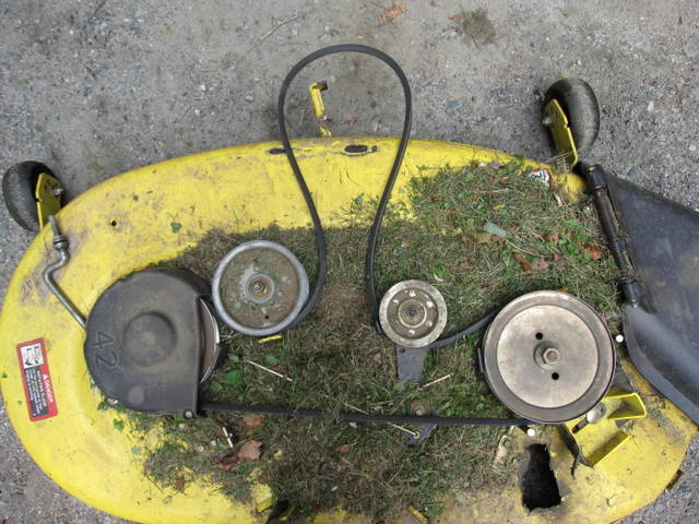

#8, new problem The lifting bracket on my JD mower deck ripped out. Time to find a welder :)

Nice job on the tractor! There's alot of satisfaction in your own repair, and you know 100% that it's done properly.
As for the mower deck... It's always sumthin'...LOL
