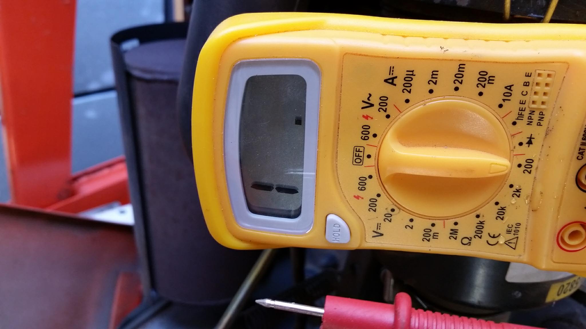

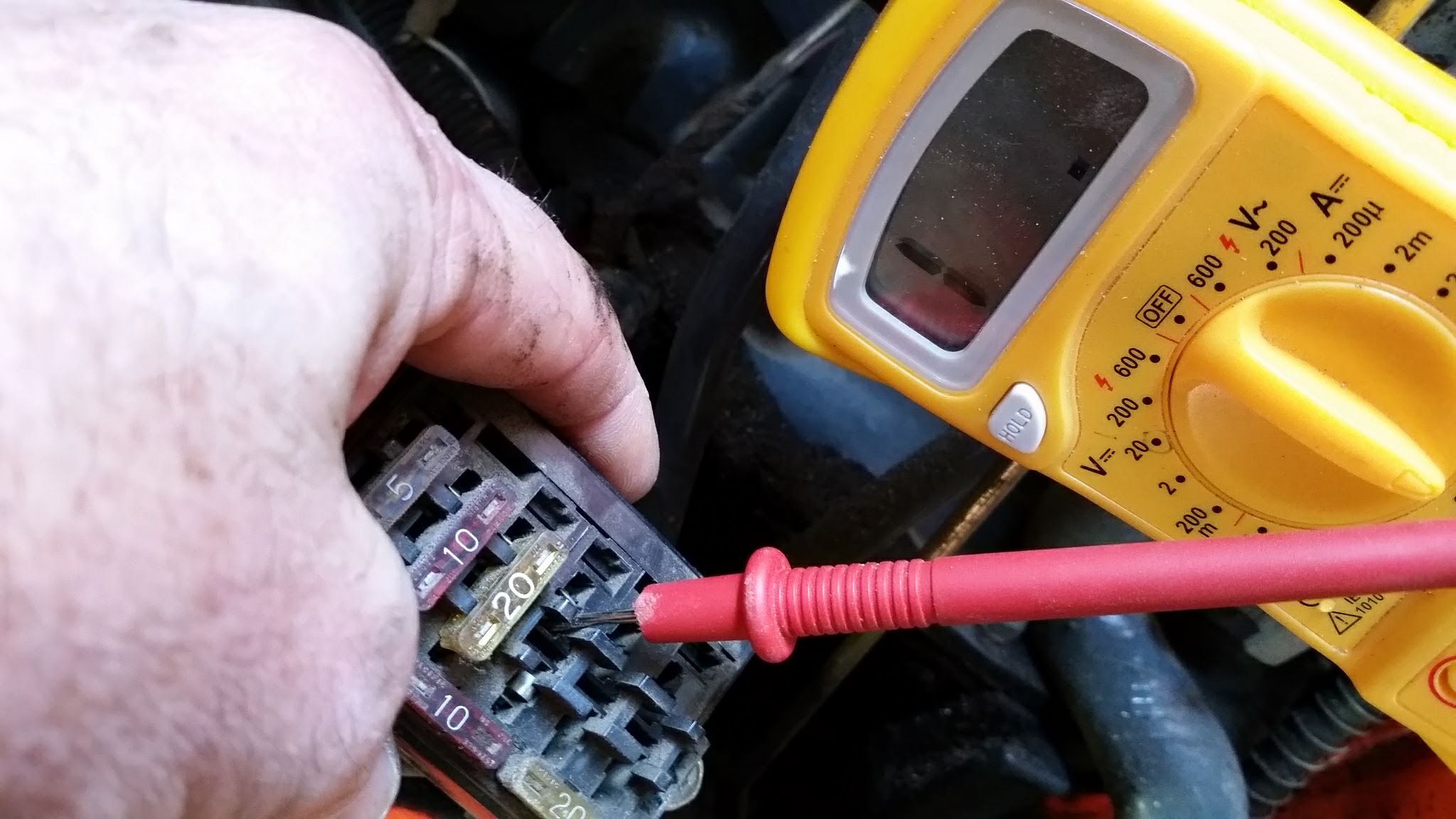

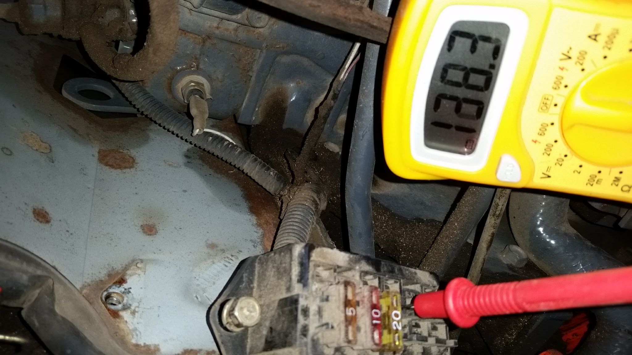

If you can please take these readings with the meter in 200 ohm position
Pict of Meter set on 200 with no connection
rt side of fuse holder with hazard switch off = I
rt side of fuse holder with hazard sw on = 138.3

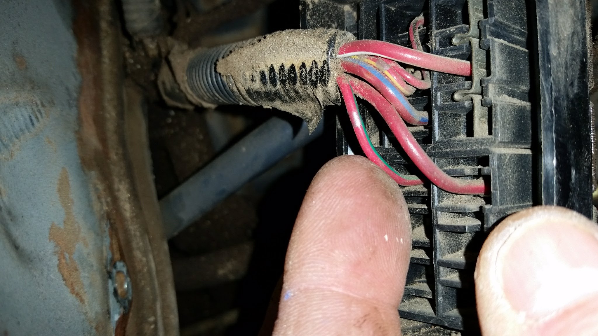

Can you get to the connector circled in this photo and disconnect it? I am not sure where or what it is. If it is under the dash,
I haven't figured out how to get the cowl and instrument cluster apart. I looked through the service manual but couldn't find any info.
The wire going to the R side of fuse looks to be Rg
