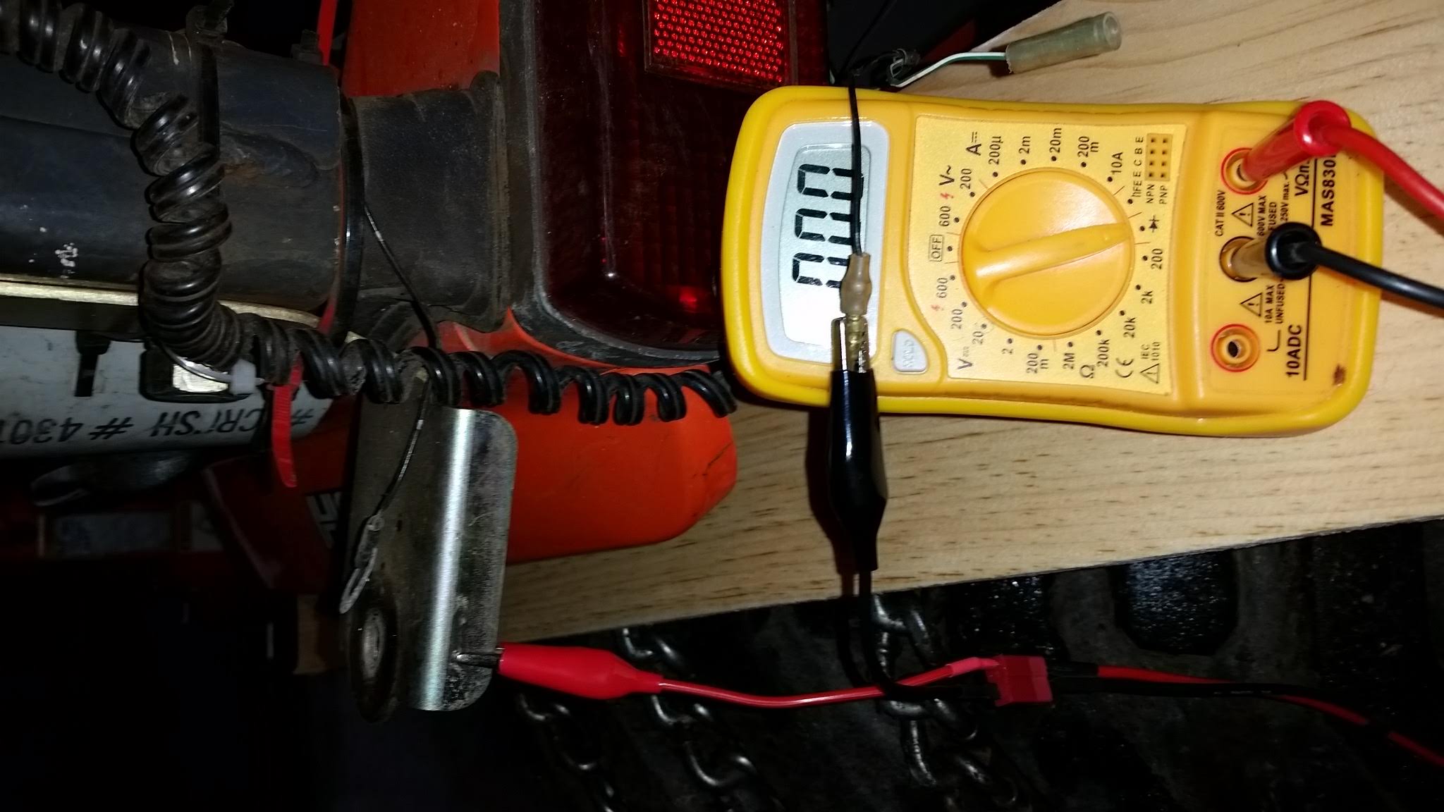

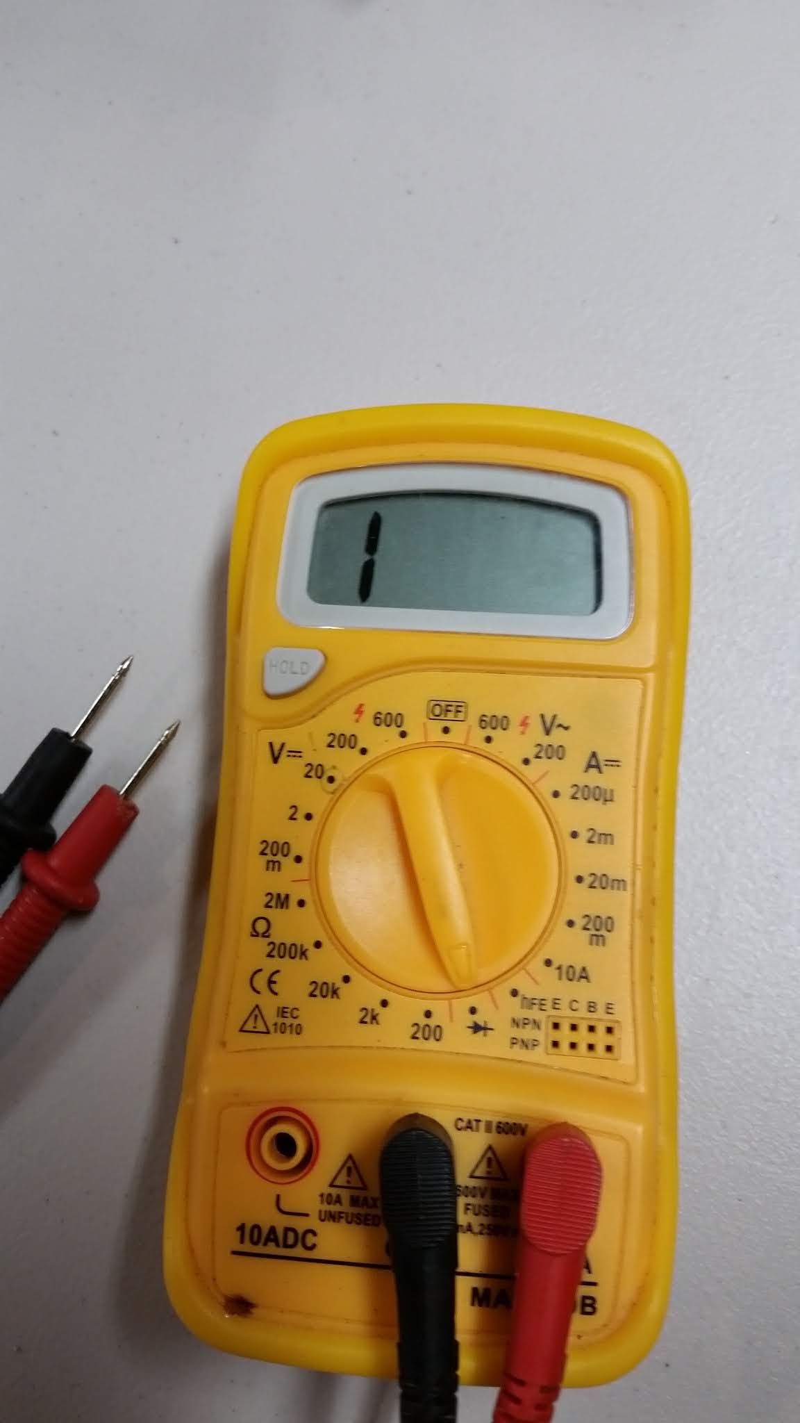

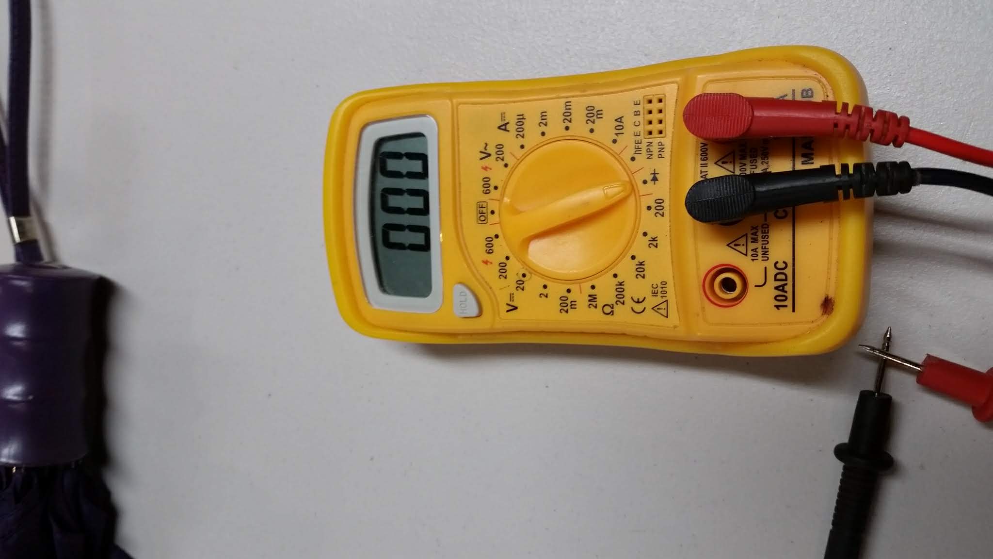

Here is a pict of the meter set to continuity.
Here with the leads crossed

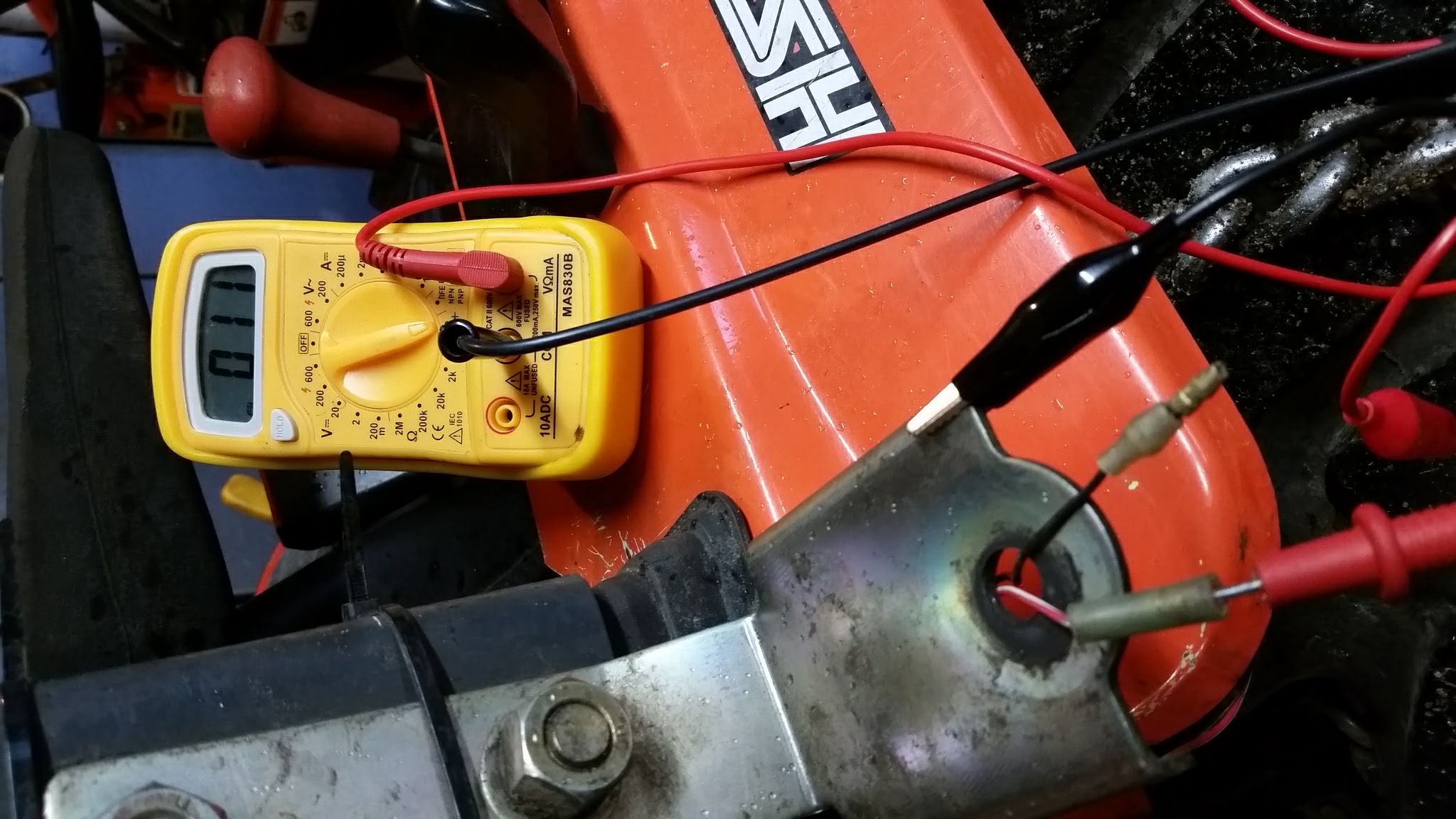

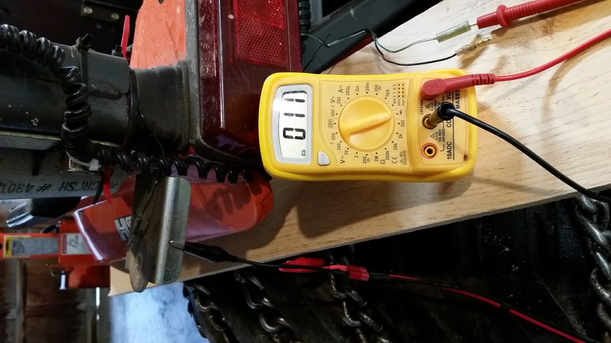

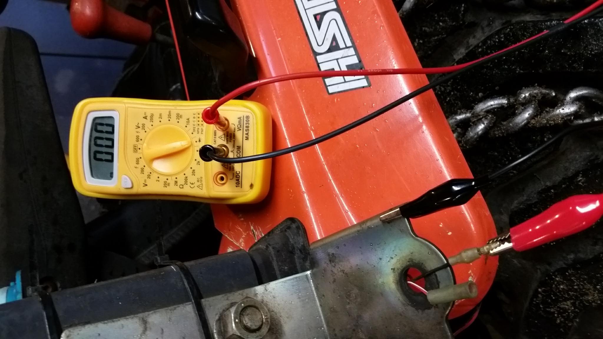

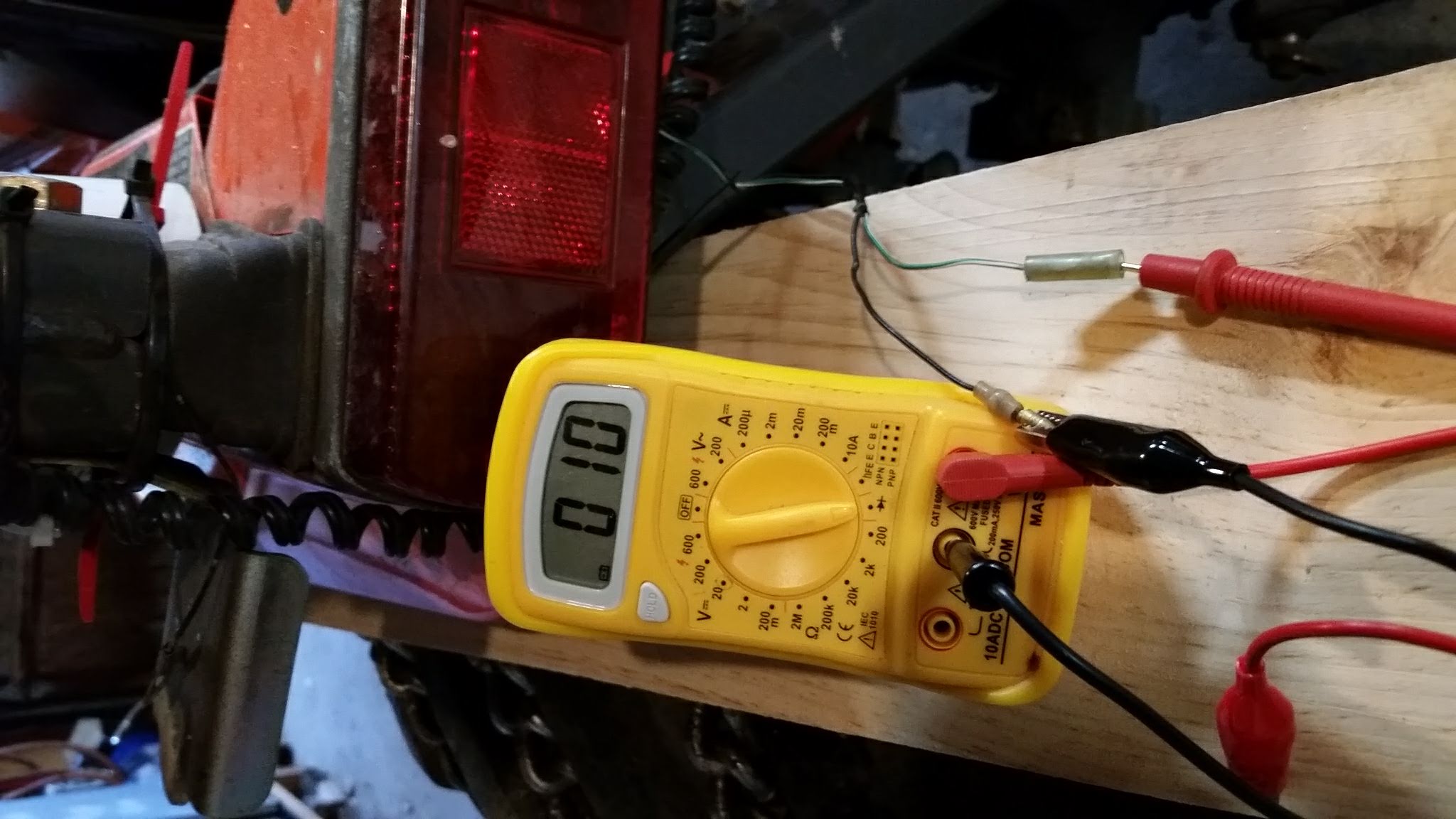

Left side Gw wire to frame ground
Left Gw to B gnd wire
Left Gnd to gnd
Right side Rw to frame ground
Right side frame ground to to B gnd wire

Dave, OK, your Meter is definitely on "DIODE" check which passes a small current thru the device and then reports back based on a voltage drop back when I did this stuff. Now, I used to do all this 2 decades ago. So maybe someone else will note if that check is OK or not but...
if you do not mind: I would prefer you turn your Meter knob to the "Ohms 200" setting. 1 click CW (clock wise) Then retry those same tests. No need for the pics. Just report the numbers back w/ the same headings from the pic.
And if you have the time, could you add two small tests? Do the fuse blade (where the fuse plugs in). Red lead on the blade. black lead on the frame. (on the left or top side). And then repeat for the fuse holder right or bottom side) Hope you see where I'm going /w this? back to that long wire analogy and which side of the fuse (from the print I'll know) might be the short to ground. Or, I going to smack my forehead and go duh.. but I think it's in my head that it'll help us. 2min test I think.
All in all - It certainly appears to report that you have 0 ohms gnd to gnd. 10 to 11 ohms from the two Gw and and Rw lines. Let me go check the print and see which is which there and what's what.

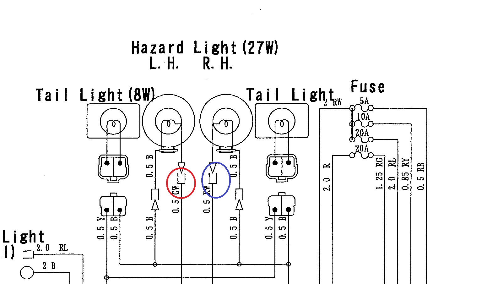

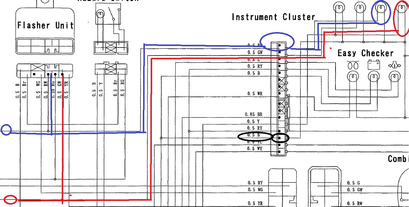

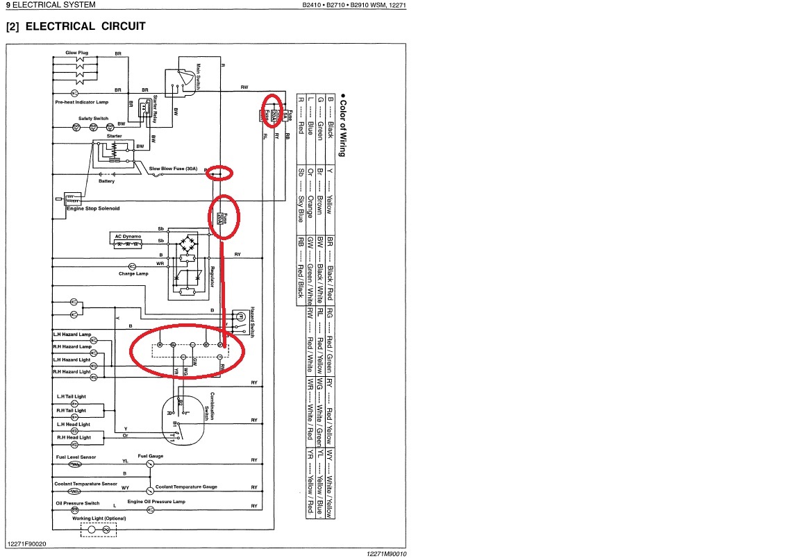

So. In the manual stating on page 337, I pulled some images. As you can see by my Red and blue marks, there is a lot of wiring. As noted in one of the first posts; I've also seen this in equipment as a few scenarios. Rubbed bare to ground, speared to grounding , melted, other conductive (corrosion and other), and then someone's modifications.
From what I can tell, you need to start unplugging things. From the Flasher unit, to the big connector where these all go together and figure out if you can say ... it's shorted on this side... but not that side. Sorry I cannot be more help here but I think your going to be pulling connectors and possibly getting under the hazard dash /console setup.
Some high level notes and pics:
There are two 20am fuses noted in the diagrams. Is yours blowing on the RED wire or the RED/YELLOW wire. The print shows two. the Red is part of the Battery feed and makes sense since if you were stalled and needed hazards they run off the battery.
As you can see from the images, IMO there is essentially 4 areas you get to trace out. And the best way is to start unplugging connectors and then trying the Rw and Gw colors any place you find them on the connectors.
My thoughts....IMO on what I'd be yanking and checking. This includes taking my cutters and cutting and then re-splicing and then heat/shrink + taping back together. The objective here is to find where she's shoring . 20A to me is the 10-11 ohms which will blow it every time.
you get to really dig in now IMO but others may have some better ideas too.
1) The Harness and local wiring the travels the back.
2) the long haul from back ends to the console and fuse assy.
3) The instrument cluster and whats underneath.
4) Flasher unit and wiring. Where is that? part of 1, 2, or 3. Probably under the hood?

Ohm meter set at 200
Right side
Rw to B wire = 11.1
Rw to frame = 11.4
B to frame = .9
Left side
Gw to B wire = 11.1
Gw to frame = 11.4
B to frame = .9
With negative clipped to frame
Left side of fuse = 80
Right side of fuse = 1
