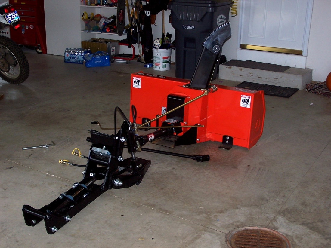

Here is a picture of my B7800 with the FEL and the sub frame for the snow plow or the front mounted snow blower (look close under the tractor for the black sub frame). The FEL must come off when using the plow or snow blower. You connect the hydraulics of the sub frame to the FEL valve. The cost with manual shute rotator, sub frame and snow blower will be in the $3,000 range. The hydraulic rotator is another $700 or so from when I last investigated earlier this winter. I could not justify the cost in Southern CT, so I use my Woods rear blade.

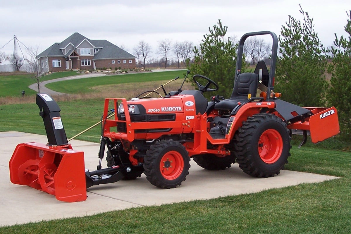

No, the sub frame / quick hitch for the B7800 / B2910 is like Bialecki's the one for the B30 series is more like the one for the BX, and B7xxx series, though it is a little larger naturally. I have attached a picture of Killer_B's B7610 hitch. I expect that the one for the new B20 series will be like the BX /B7xxx, and is much easier to install.
